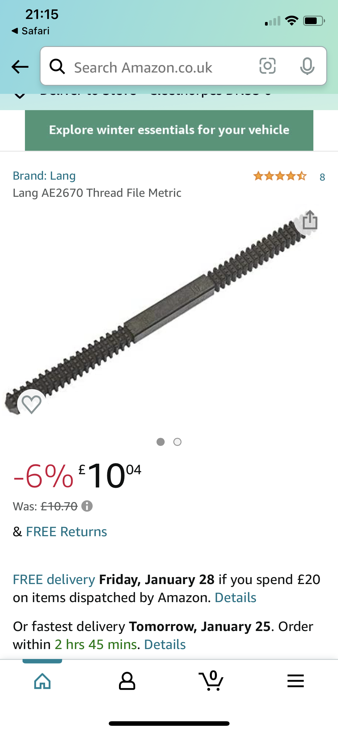

What about using a thread file to remove most of the crap. Can be very successful and they are not too expensive to purchase.
Used them many times to get me out trouble.
You need to know the correct pitch of the thread. If unsure measure the pitch of the thread with a set of thread gauges. Then buy a thread file with the right pitch.

Re: Coilovers
Used it to great effect on my old coil overs
Once the threads are clean. Use heat on the nuts (as Ben suggested) to get the initial movement.

A tool I didn’t know existed. Gonna have to buy one now yer bar steward.steve2003rs6 wrote: ↑Mon Jan 24, 2022 10:18 pm69BC5413-DA99-4DA8-ADD3-DB019F7A7E6C.png
Similar to one of these. But you need to get the right pitch.

Used them many many times. Very very useful in cleaning and repairing threads.
But you must get a thread file for the right pitch of the thread that you want to clean up.
Bloody hell ben have I actually taught you something lol
They come in all sorts of pitch configurations.
Essential to order the right file for the pitch you require.
Most good machine shops will have a full set that will cover most eventualities. Perhaps you can borrow one Chris.
But they are cheap so probably best to just buy one.
