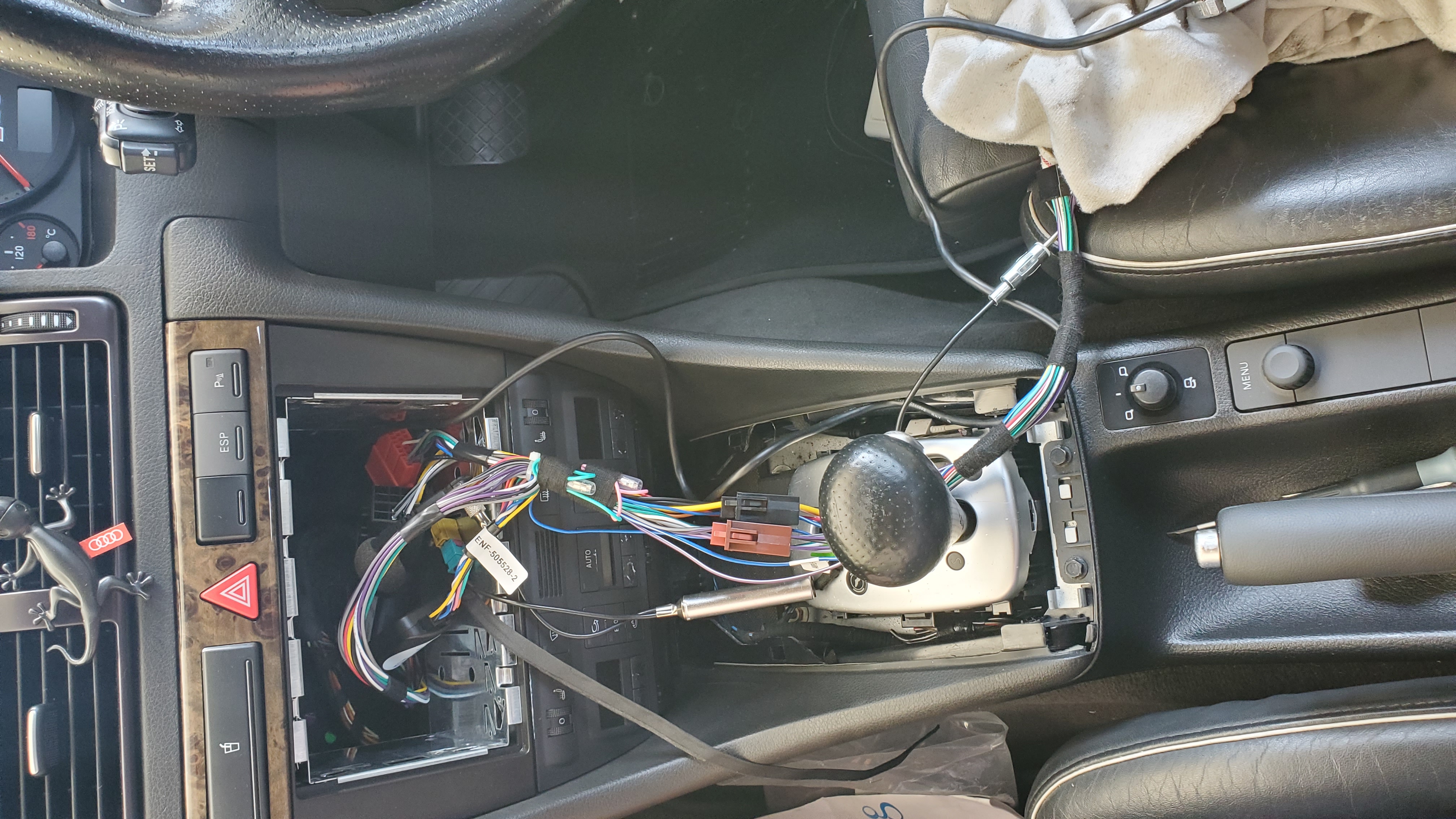

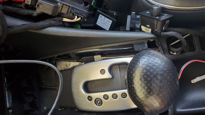

Yeah, it's quite easy. The gear selector trims comes off easily and you can feed a fairly thick wire through from the back of the headunit, behind the climatronic and fish it out of the gears selector. Then you can feed it through the handbrake surround trim (this also comes off easily) and then do what anditsoundslikebells did.
Re: Cabling to armrest
Gear lever surround, hand brake trim. Perfect, got it thanks gents.
Just remember to put something behind the gear knob button when you pull it off. Otherwise it retracts inside the knob and it's a pain to get out again. Ask me how I know.

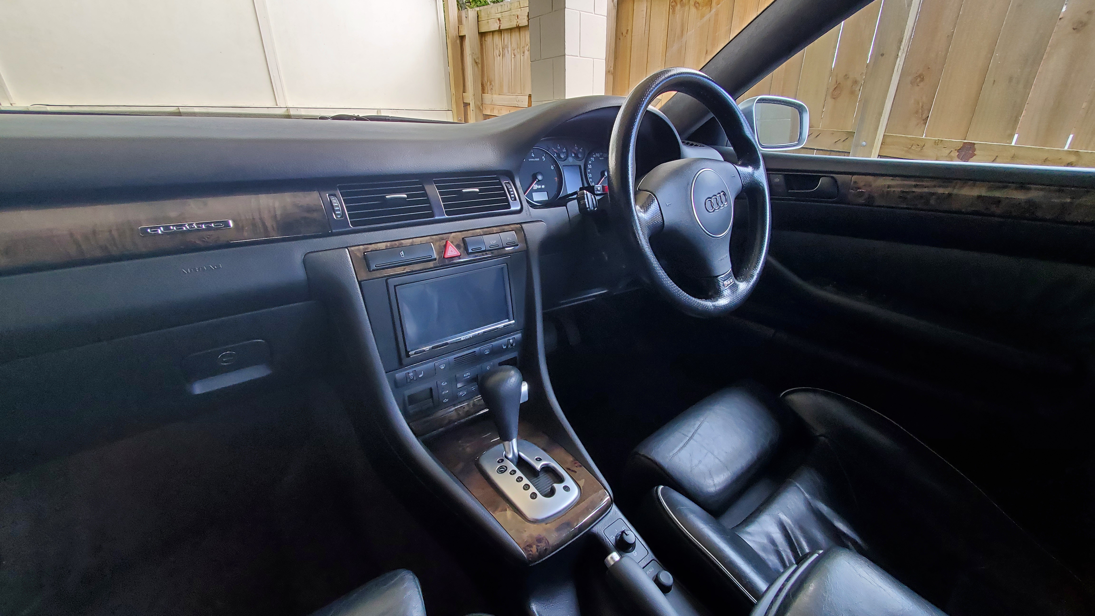

Finished the new head unit install. The worst part of it was getting screwed by USPS, just as all the adaptor harness and trim stuff arrived at the depot on the US West coast USPS decided to halt airfreight to NZ. EVERYTHING had to go all the way back to Enfig to be resent, but this time to a forwarding warehouse using a local to me post service. Anyhoo I'm very pleased with how it all turned out.
It all started with a deal I got on Sony XAV-AX3000, up until then I was using a Crux Bluetooth adaptor which worked fine, not great , but all I wanted was halfway decent method to play Spotify in the car.
I could not have done this/I would not have done this if it wasn't for the short depth, half DIN format of the Sony. The adaptor cabling etc was considerable...but it easily fit under and behind the unit.
I found and chose Enfig for the rest of the parts as I liked what I saw in their C5 A6 install video. Sooo easy to setup and plug together with the only bodge needed being a connection to the parking brake wire off a nearby 12v wire.

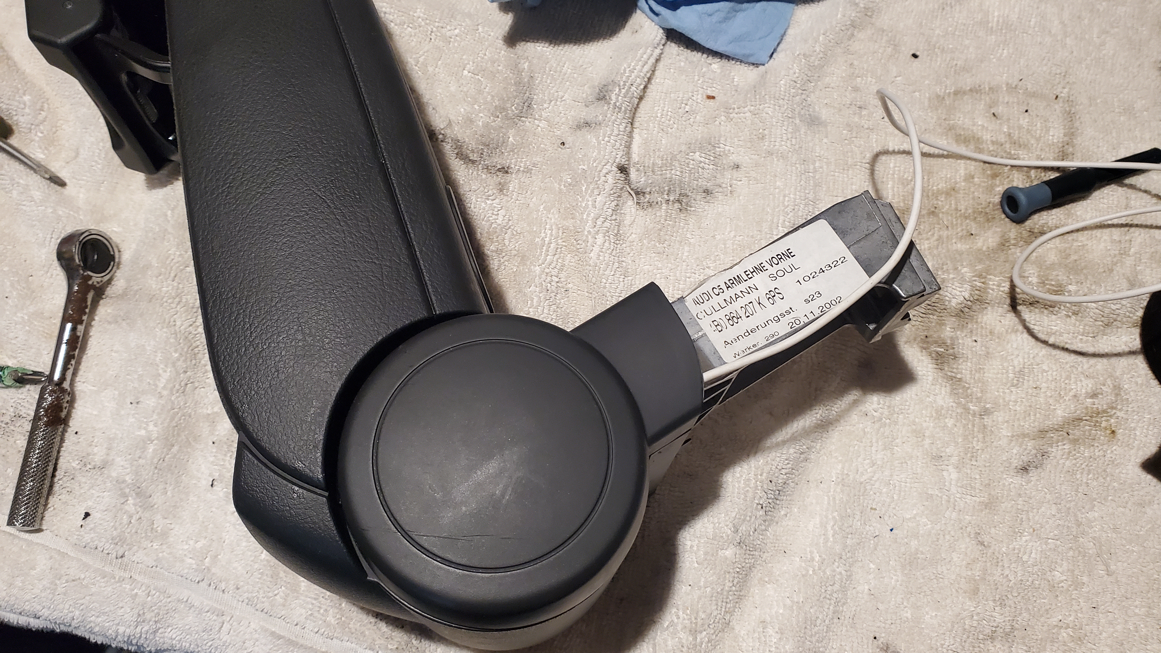

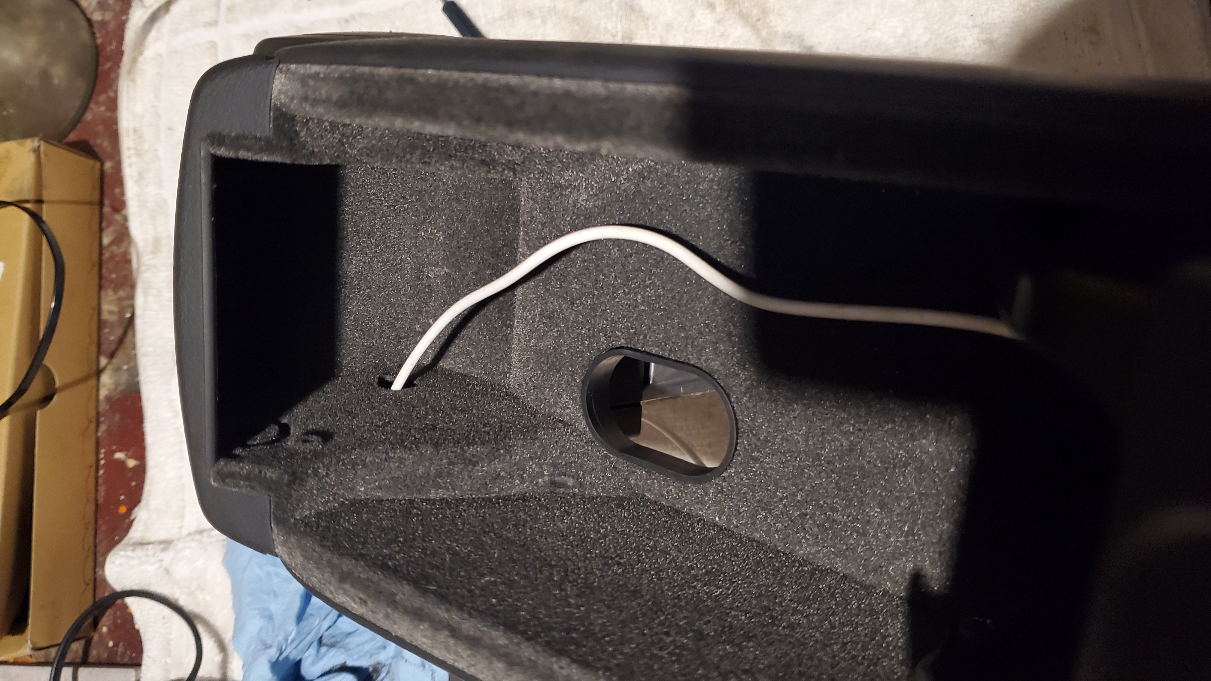

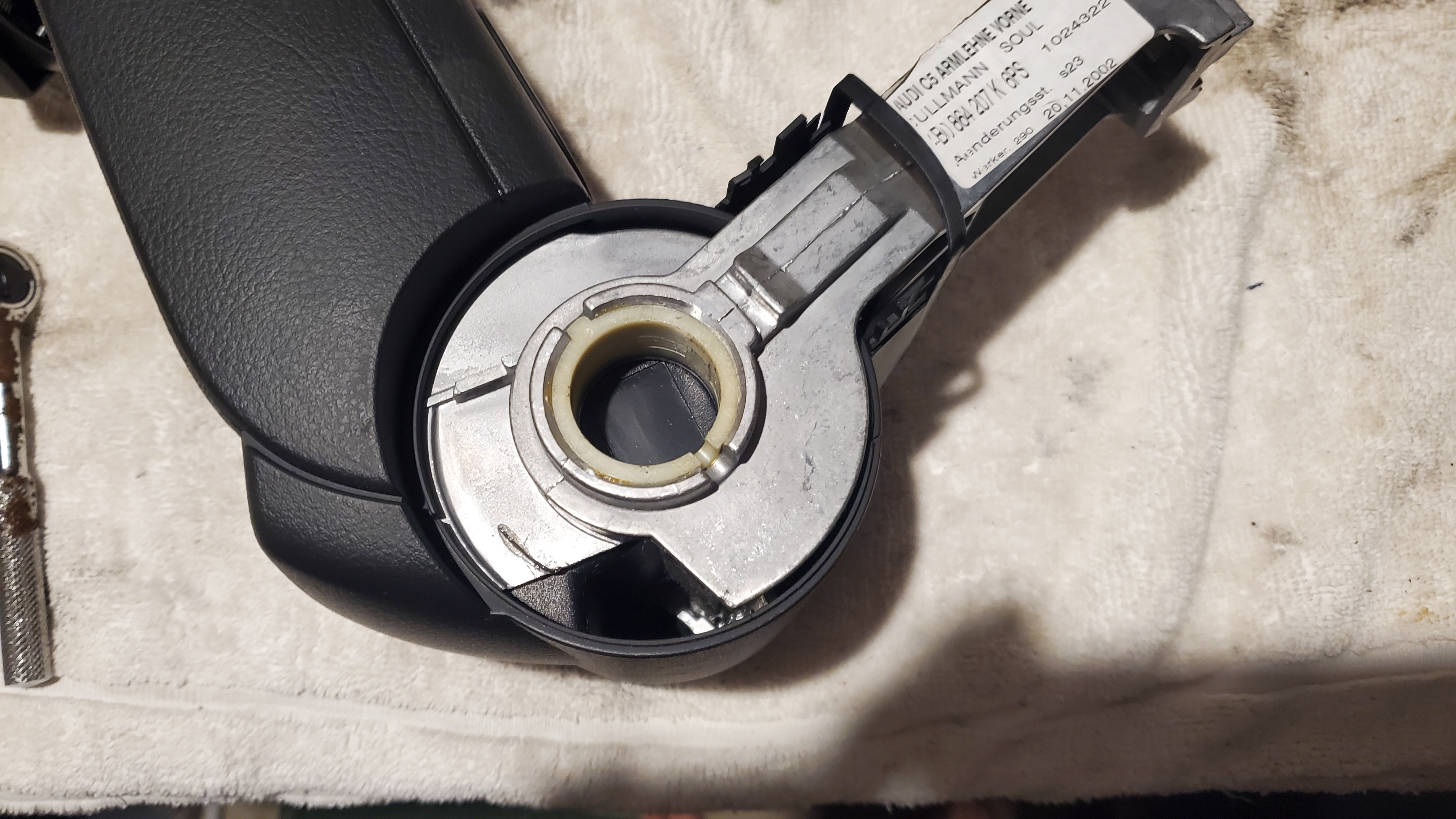

USB cable routed behind the climate control, under the gear selector surround trim,.under the centre console and up through the hinge mechanism of the armrest.
Very happy with the sound and functionality that I have with Android auto.
The only nit pick is what's been mentioned here before regarding the difference between resistive and capacitive screens, this being the former, so at certain angles in sunlight it washes the screen out a bit.

I did want to take it further when (hopefully) someone develops a retrofit wireless thngamabob that I could stick under the armrest liner, but I couldn't for the life of me figure how to seperate the liner from the body. Also it had phone prep with the pop up cradle still there. I had to use an oscillating tool to get it out, screw threads adhesive had failed so the screws just spun. There's probably a bunch of mess in that area where the cradle was.
If something does get developed for wireless android auto retrofit I'll go source another armrest.
