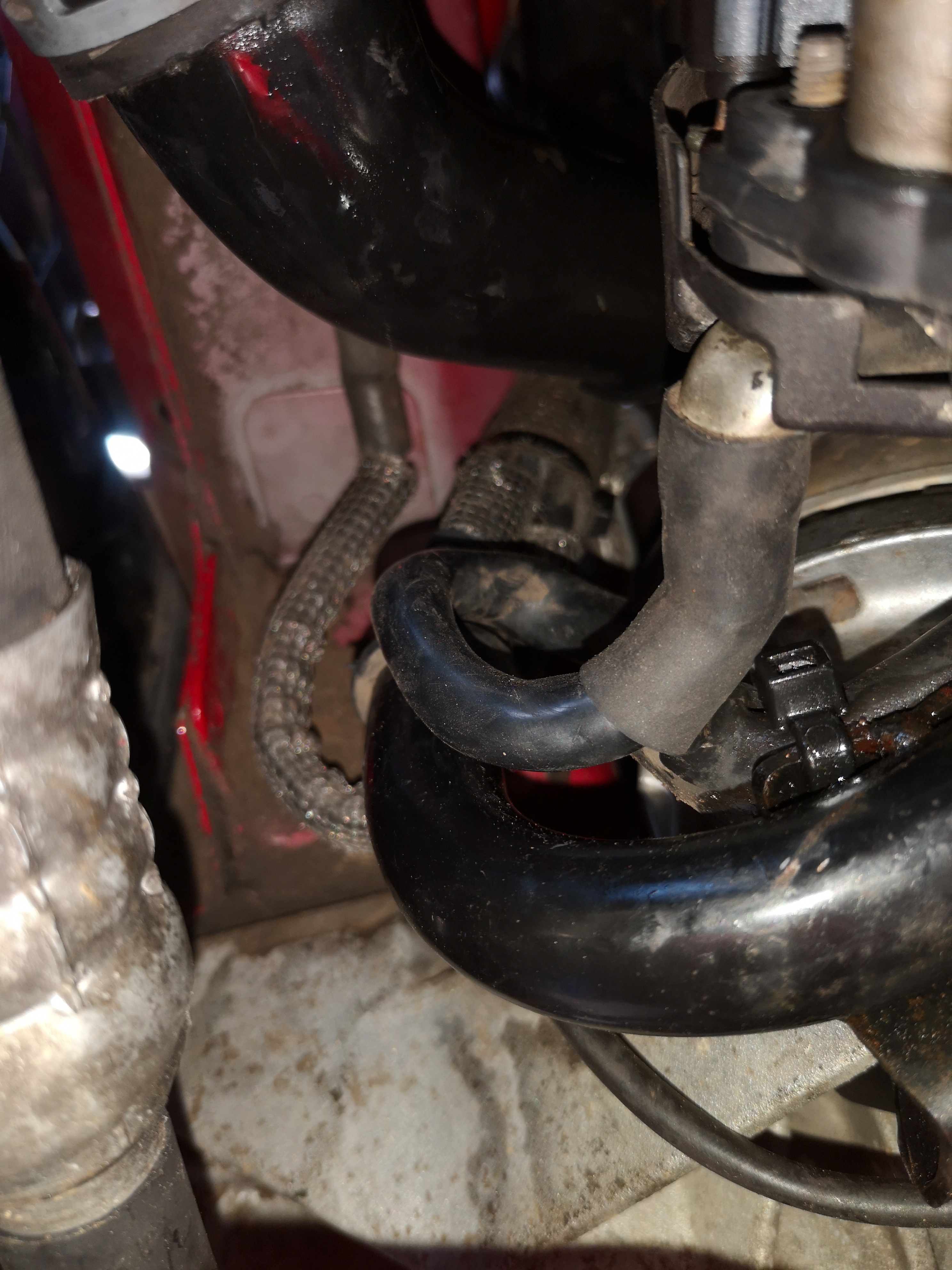

ok so my 200amp mega fuse is blown.... the question is why? Can anyone confirm that my earth and alternator wires are correct here?
airtite
Posts: 173
Joined: Wed May 15, 2019 7:08 am
Re: no start after engine pull
Post by airtite » Thu Oct 21, 2021 1:27 pm
so in my picture above, can anyone tell if its the wire sheathed cable thats meant to go to the alternator or is that the earth?
airtite
Posts: 173
Post by airtite » Thu Oct 21, 2021 2:58 pm
car starts, I am an idiot... I had swapped the earth and positive at the alternator... new 200amp fuse fixed wiring and car starts.
