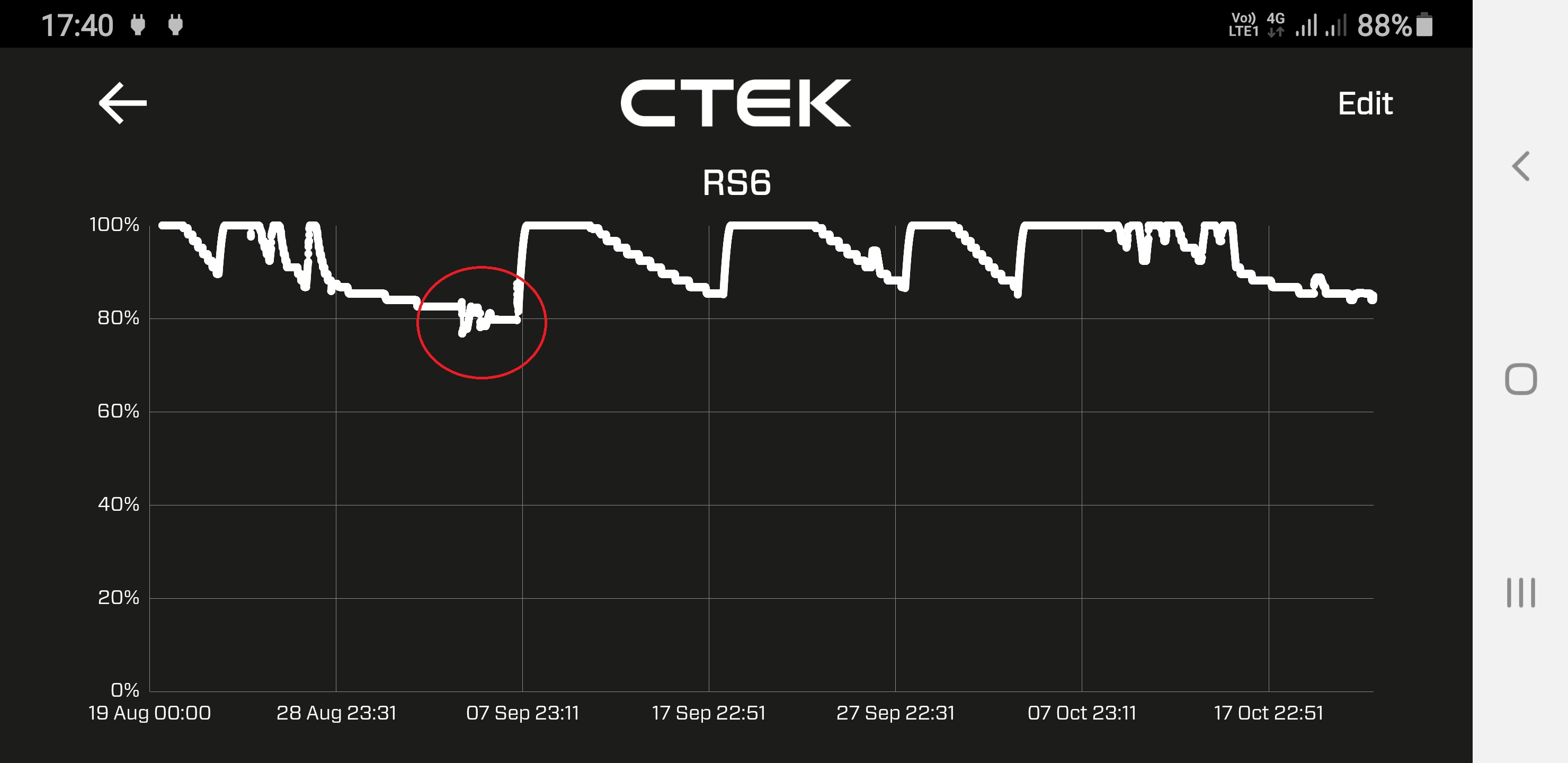

I mentioned this with my car about a year ago. The major source of my drain was the alarm horn battery. I removed that to check and the current drain dropped to the minimum. Nevertheless, the car design with the alarm system (motion detector etc) activated still uses power so it is not possible to get to a zero battery consumption state. Furthermore, if you log the battery state, you'll see a significant battery drain every time you open the door or boot and it takes some time for the current draining items to switch off. Even if you just let it sit you'll still need to top it up every month or so if you wish to prevent long term battery damage and possible cell reversal.
I did consider a cut off switch and there are plenty of options but in the end the benefits are clouded by the disadvantages which have been mentioned above. The penalty you pay for a more fully equipped car.
