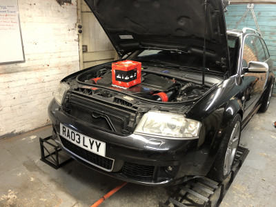

  • Pop the car up on the ramps, and threaten it with the new pump.
  • This will inevitably cause the existing pump to shut up and run smooth as a nut.
  • Do not pay attention to it. It will feck you over the moment your back is turned.

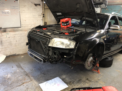

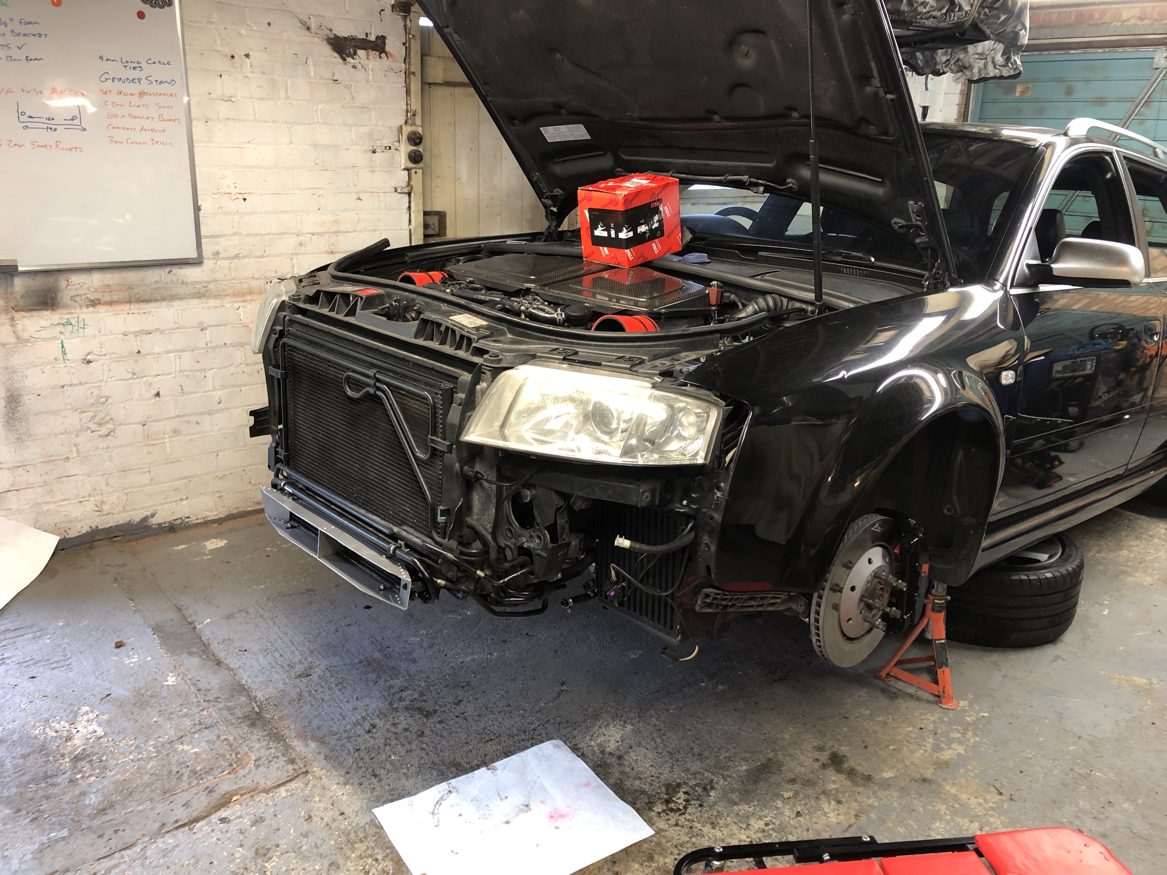

Get the lock carrier into the service position. I shan't cover the detail of it here, but the summary is:
  • Remove tray
  • Remove wheel shrouds
  • Remove 6x bumper side bolts
  • Remove 2x bumper centre bolts
  • Disconnect 5x electrical connections and 1x washer hose

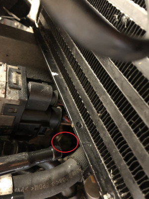

  • Disconnect upper and lower coolant hoses - OS
  • Disconnect PS hoses - lower OS
  • Disconnect recirc coolant hose from solenoid and unbolt solenoid (yellow plastic thing. 2x M10 nuts). Maybe swear at the devils hose clip too.
  • Undo inlet duct nuts
  • Put service pins in.
  • Undo 2x torx bolts holding AC pipe that runs across the bottom of the lock carrier. DO NOT disconnect the AC pipe or you'll have to recharge the system
  • You also don't need to disconnect any of the oil (engine or gearbox) hoses.
  • Undo Lock Carrier bolts and slide lock carrier forward.
  • I timed it. This is exactly 1 hour 10 minutes work.

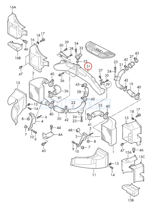

  • Next, remove the "Charge Pipe" and the NS top intercooler hose - no.s 31 & 25.
  • Don't forget the charge pipe has 4 bolts - 5mm hex key needed.

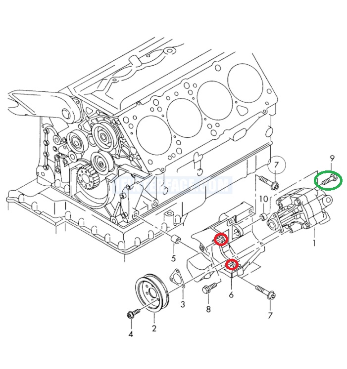

  • Slacken off the 2 bolts on the front of the PS housing

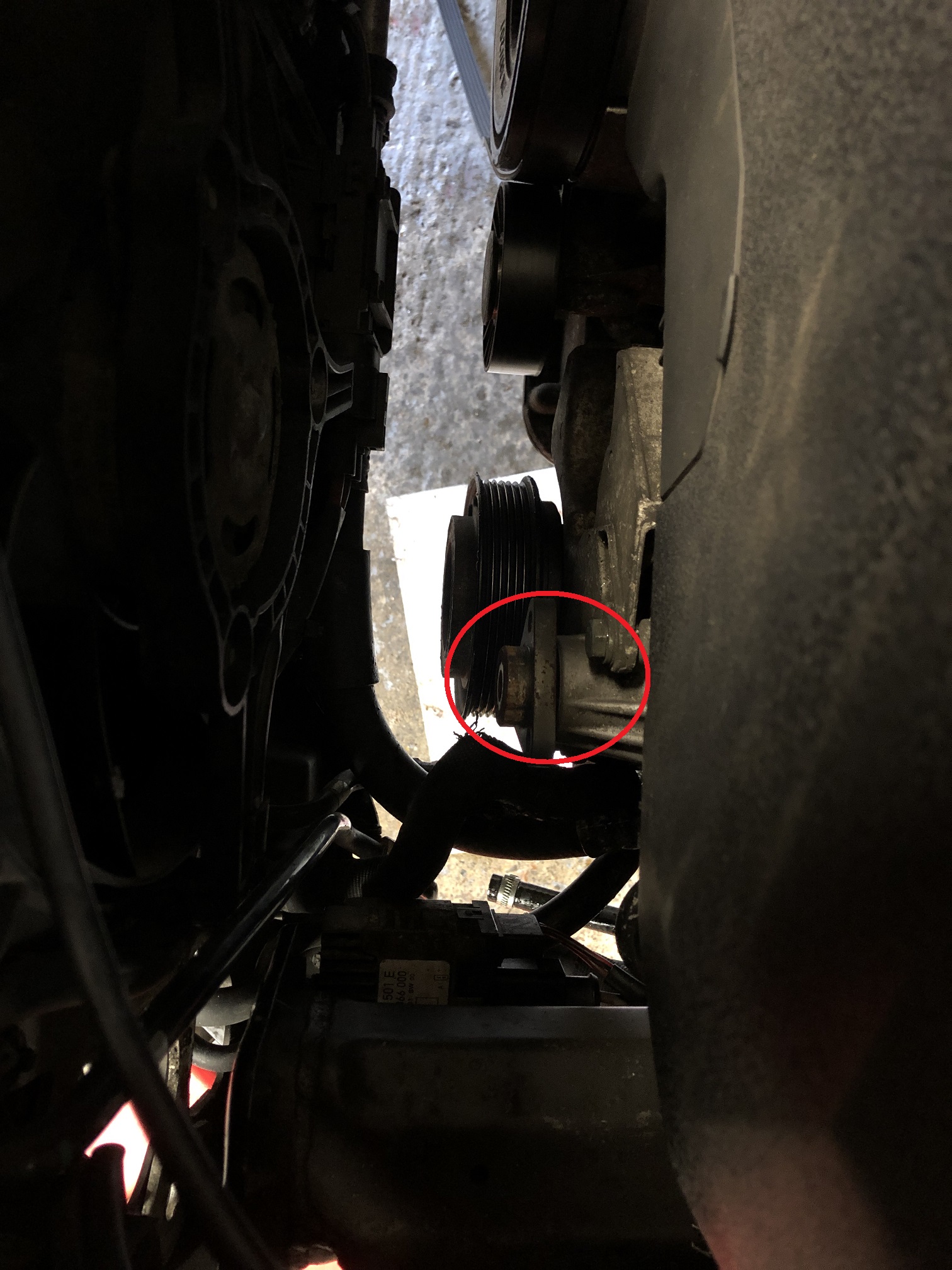

  • Finally, undo the bastard bolt (green). This is hidden right down at the back of the PS pump.

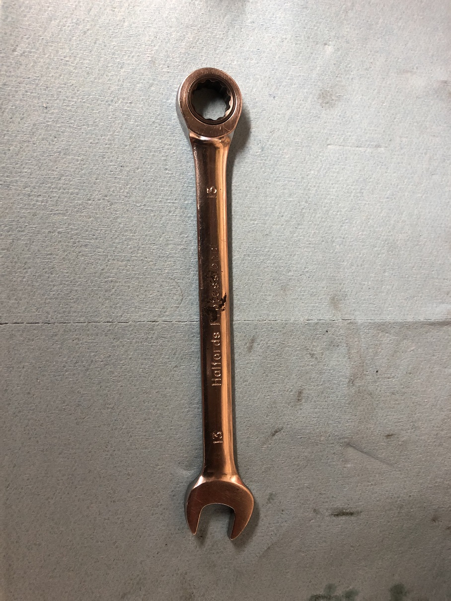

  • The ONLY tool that works here is a 13mm ratchet spanner. If you don't have one, go and buy a set from halfords now. They are brilliant.

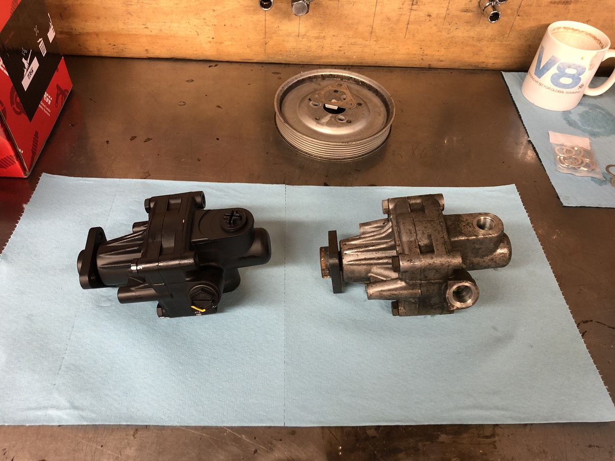

  • It's out!

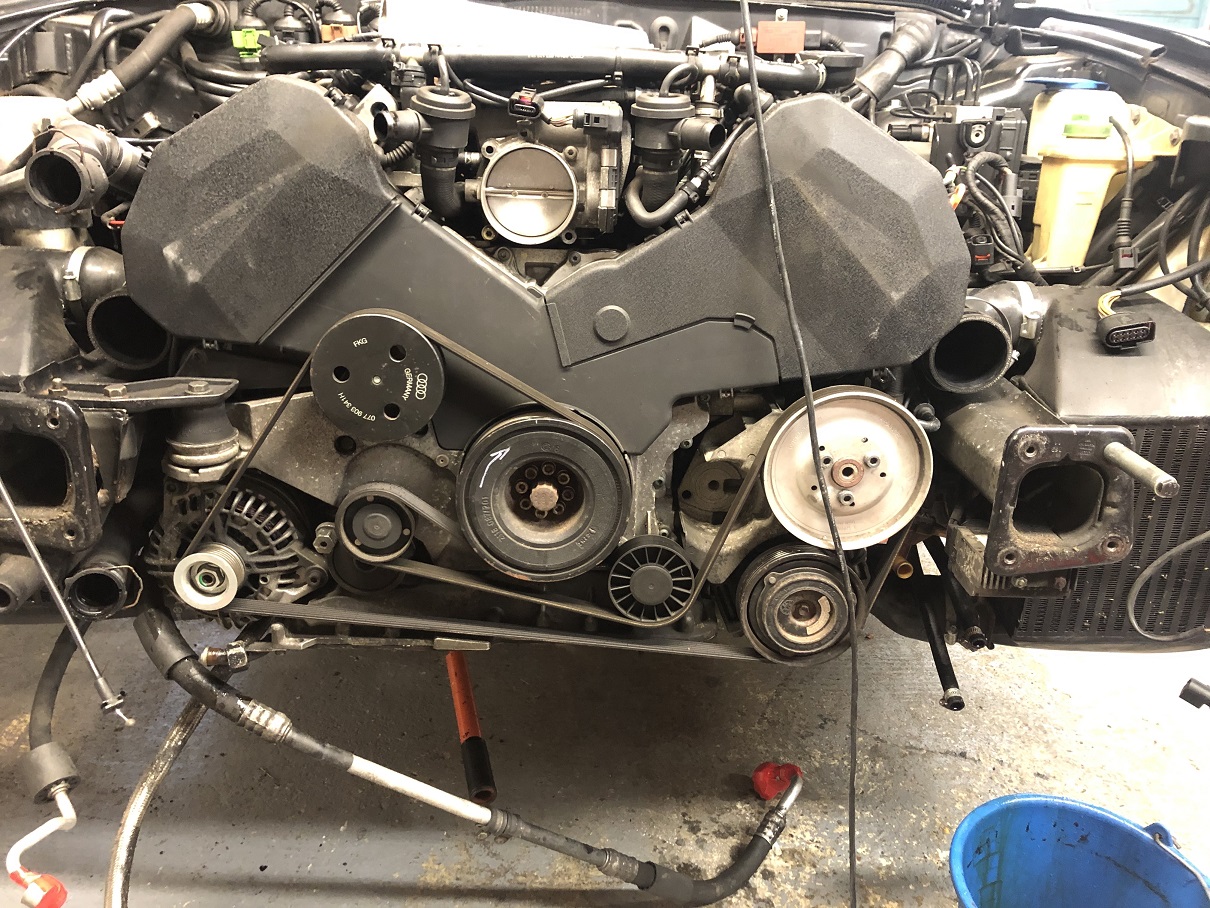

  • You probably forgot to note the aux belt route. Here's a reminder:

  • Fire up the motor and promptly turn the wheel full lock each way
  • Car is still up on axle stands at this point - wheels in air. Also shrouds, tray and bumper not back on yet in case you have a leak that needs tweaking

#1 regarding the bastard 13mm bolt at the rear of the pump, there isnt much room between the head of the bolt and the engine block. I bought a set of ratchet spanners, but lo the 13mm spanner couldn't fit over the head of the bolt due to the block interference.
You can use a std 13mm spanner, flat by flat, alternating the ring end and the open end.

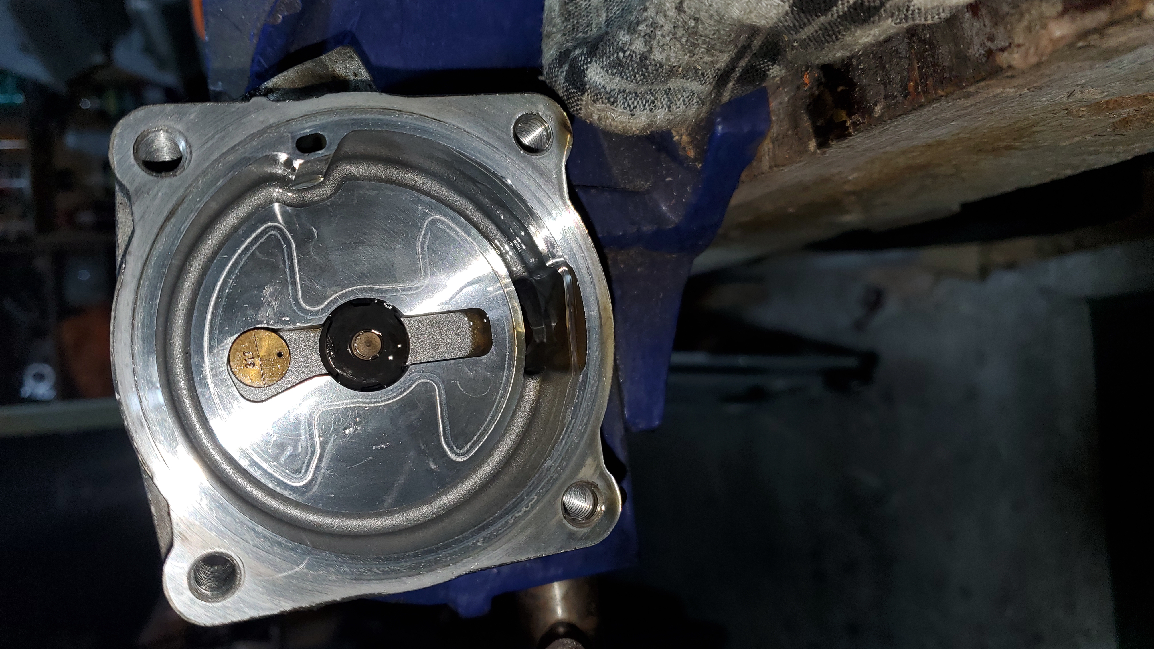

#2 I split the pump to see what I could see. Can't see anything, not sure what to look for. Anyway pump whine and/or failure could be the vanes, or vane housing being worn, or the orifices that push the vanes against the housing, possibly worn and no longer applying enough pressure to the vanes to hold them at clearance - or however these things work. Lastly perhaps the oddly shaped internal seal could be bleeding pressure to the wrong part of the pump.
I will take the worn pump to a specialist to see what they think as I'm curious if these can be repaired, if so I'll repair the worn pump and keep it.

What brand ratchets did you get? Mine are Halfords Pro.
Supercheap Auto - an automotive chain here in Australasia. Not the best quality but the ring is just a smidge too thick.
