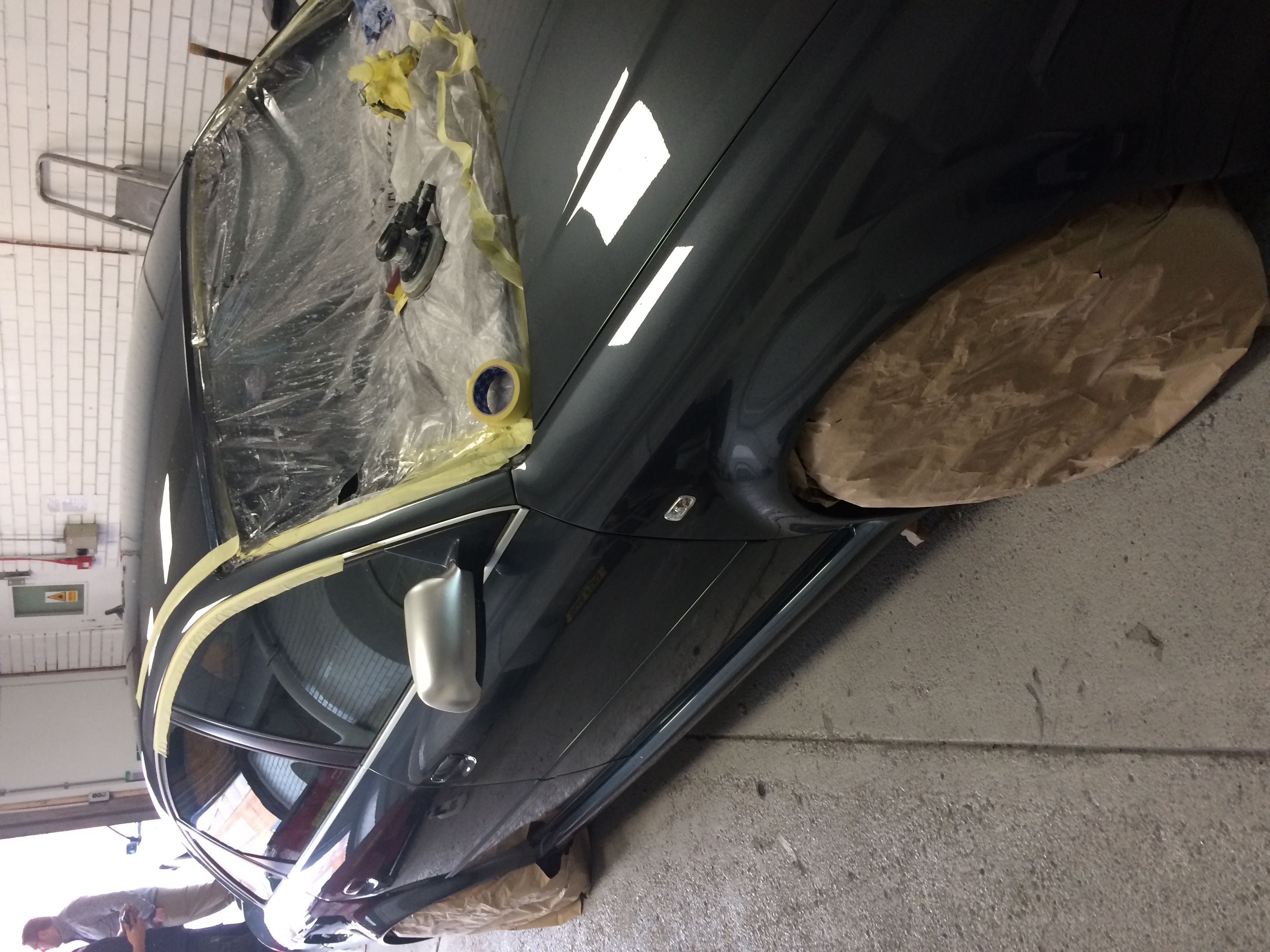

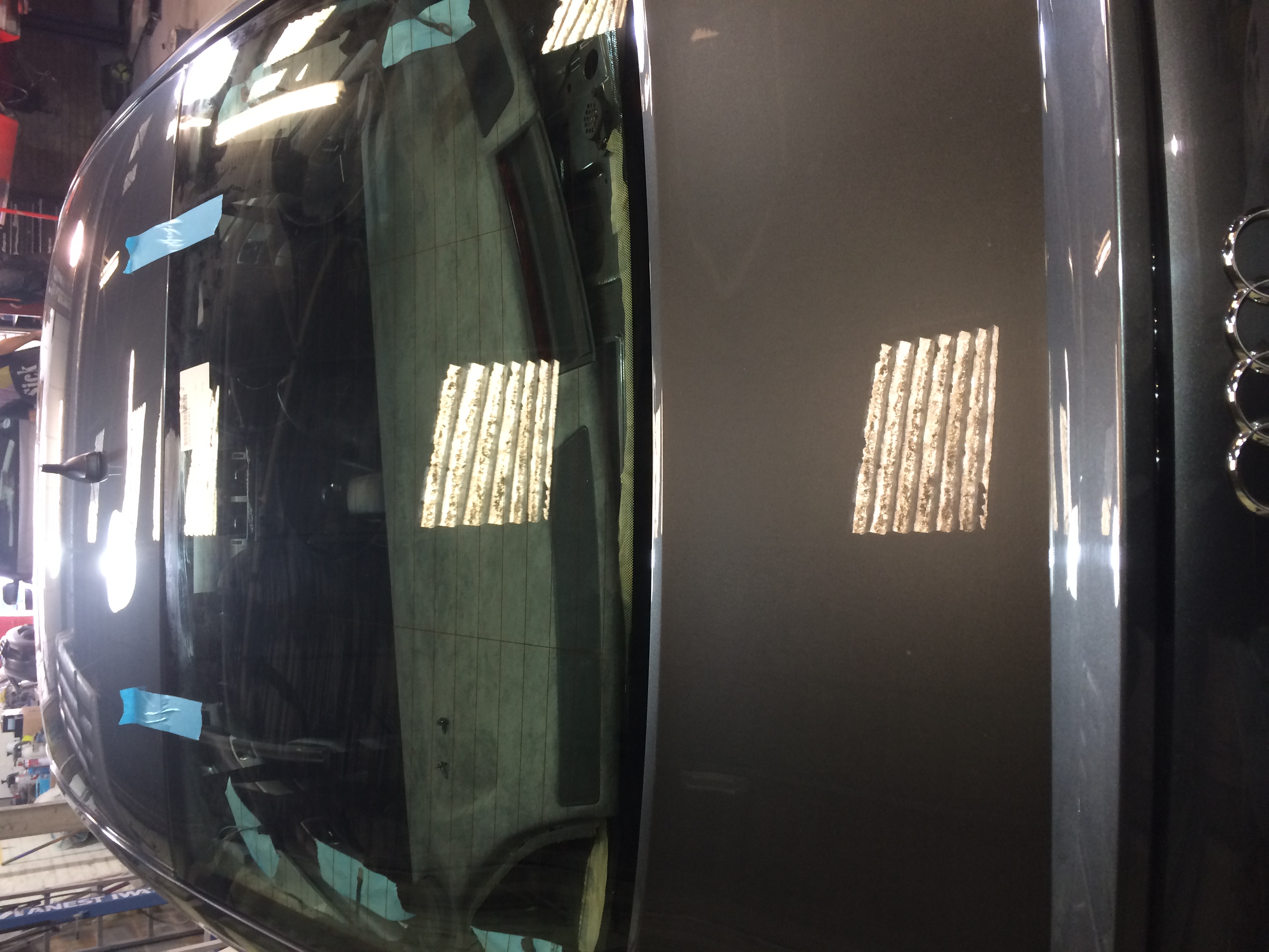

Ps this is why we took the windows out. So pleased we did as we would not have noticed the rust patch on top left corner under the glass.
Apparently just caught it in time for a effective repair to be done.
You can just about see the paint starting to bubble on roof front left edge on the second picture.
