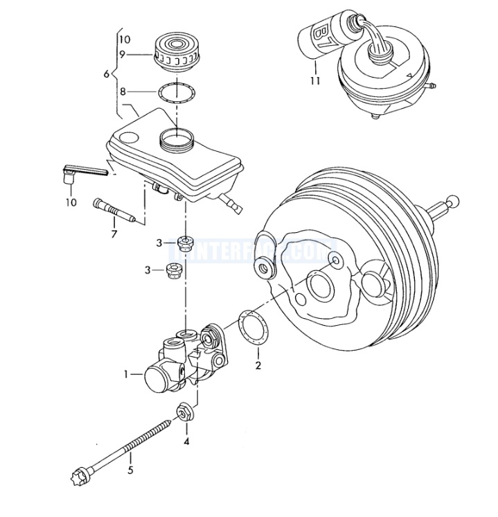

Official line is that to replace the master cylinder, you have to remove the entire servo assembly including disconnecting it from the pedal.
This isn't true.
First up, the OEM cylinder is TRW part number PMN213 and comes in at about 55 quid from autodoc (I've posted that before). Or, if you insist on buying the same part from Audi, it's part number 4B3611021 and a bargainous 350 quid.
To remove:
  • Drain the system of fluid.
  • Undo and move the master cyl pipes out of the way. I didnt' completely remove them, I just unbolted the master cyl end and loosened the ABS unit end to give me a bit of movement to get them out of the master cylinder. This took a bit of flexing, but I didn't need to bend them.
  • Then remove the reservoir - just undo the horizontal bolt that holds it in place and pull really quite hard. (7,6)
  • Next undo the buts holding the master cylinder in place (4) and crack the master cylinder off the servo. Looking good.
  • Now, in the manual you have to scrabble around under the dashboard to disconnect the brake pedal and generally fanny about a bit.
  • Instead, remove bolts (5) and crack the servo off the bulkhead.
  • With the servo free to move, you have just enough movement to on it to get the master cylinder clear of the engine bay bulkhead and pull it out.
Reinstallation is the reverse of removal. When you reinstall, make sure the clip inside the servo that locates the pushrod onto the diaphragm is correctly mounted - you'll know what I mean when you see it.
