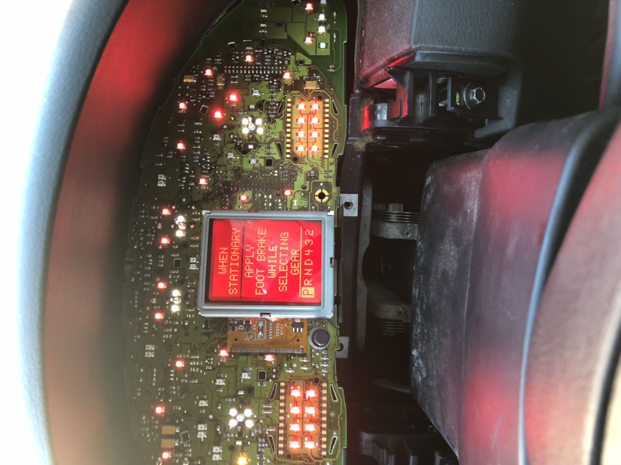

It’s just like the b5 fix to be honest, I’ve done my B5, TT and C5.
You don’t NEED, a hot air gun but it would obviously make it easier, I’ve done all mine with a maplin soldering station, but obviously without the hot air gun your hardest part is de-soldering the ribbon.
I found the C5 the hardest to calibrate the cluster needles afterwards, and obviously you need VCDS to do this, but they kept loosing there position for some reason, the other two clusters where much easier so maybe just my cluster.
Iirc when I last looked, you couldn’t get genuine screens any more, I fitted one of the last ones on my B5, I just fitted one of the Chinese ones, at first it did seem a little bright but if I’m honest, the last time I drove the car it seems to have calmed down a bit.

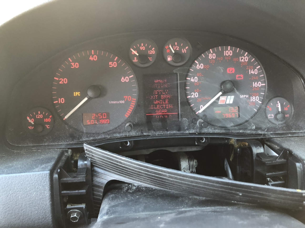

As you see, usual DIS failing.
Sorry for the orientation, but that’s the new screen in and I’m just testing that the soldering is fine, you can see the brightness of the screen in comparison, as I say the screen has dimmed slightly since.
