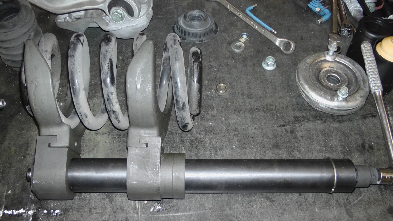

Finally got around to the damper swap. Interestingly, the spring preload on the OE dampers was very low, although it does become clearer when you see that the Bilstein dampers are 20mm shorter overall.
The spring perch is 5mm higher so I'd imagine the finished product will sit a fraction higher than standard.
Does anyone know for sure which is the correct bump stop? The one that came off was knackered and was 8D0 412 131E.
The US Audi site has a part number search and it says that number is for the B5 sports suspension and is incorrect for the RS6. The aftermarket shops list just about every part number option as suitable, highly unreliable. I would normally have taken the fitted part to be correct but not so confident on this.
Anyway, for the moment done with new top arms.
