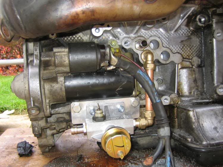

I have that plate for my other V8 motor. It fits the older cartridge style oil filter motors and allows you to have a remote fiter. Not sure it would fit the BCY though.
The other option I've seen done on the ABZ is to put a thread in the block to mount a fitting. 1/2" BSP
It's here although photobucket have messed the images up.
Not sure I want to accidentally get any swarf in a "live" engine though from putting a thread in.
Anyway, once you've "done the Bufkin", it doesn't feel like a problem to keep the oil=>water cooler? Saves having to replumb the whole system.
Oil changes are no biggie - you just put your arm in through the wheel well if you really don't want to take the tray off. Personally I always take the tray off to give everything a "looking at" anyway....

Found the pics of the ABZ. Here you go....
