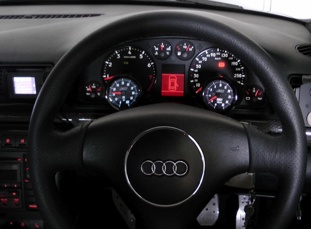

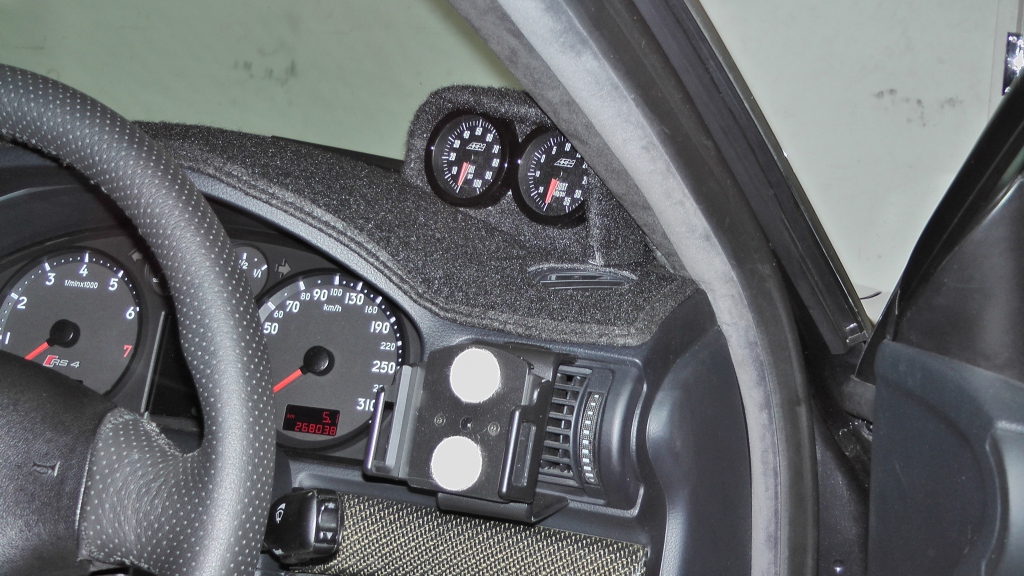

You're perfectly entitled to take that track. My view as an engineer and after some thought, is that there are two engine parameters that require monitoring in real time for these cars, oil pressure and boost. You can see at a glance if either of your fundamental parameters are not in spec and neither are monitored in real time by the car and visible to you.
I tried the podi system in my RS4 and didn't like it.
I then relocated the gauges to the far right on the dash. They are invisible to any casual glance but right in the eye line when watching the road.The mount system I used makes no changes to the car and can be reverted with no impact.
You can also mount gauges in the vents, use a P3 gauge setup, a liquid gauge in the vent, a colour DIS and the options go on. I have the colour DIS, waiting to fit it, I have a liquid gauge in the RS4 and I have a P3 gauge that I will fit in the RS6.
The RS4 and the RS6 have many similarities and common issues that impact performance. Like you, I wouldn't want a series of gauges stuck just anywhere but I feel that there is certain information that any technically savvy person would want to have available and this is an acceptable way to do so.
