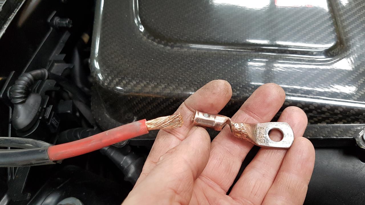

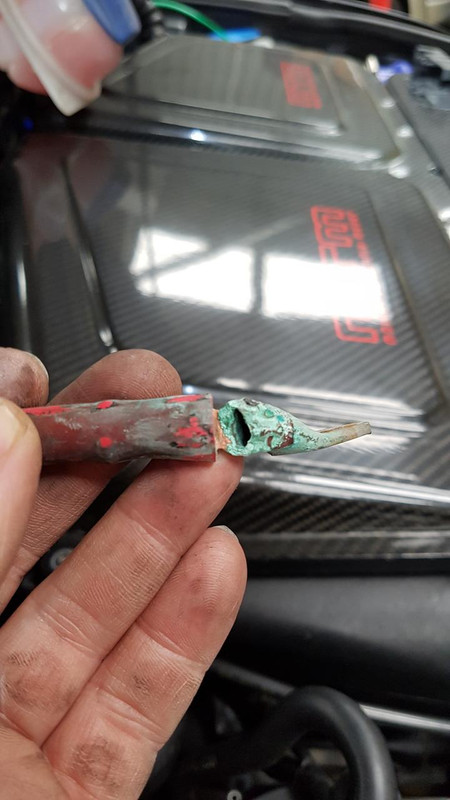

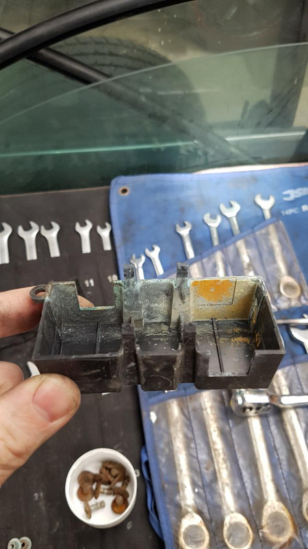

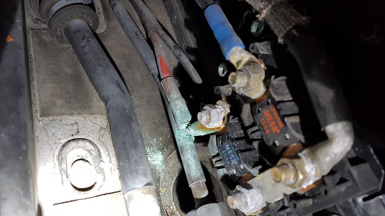

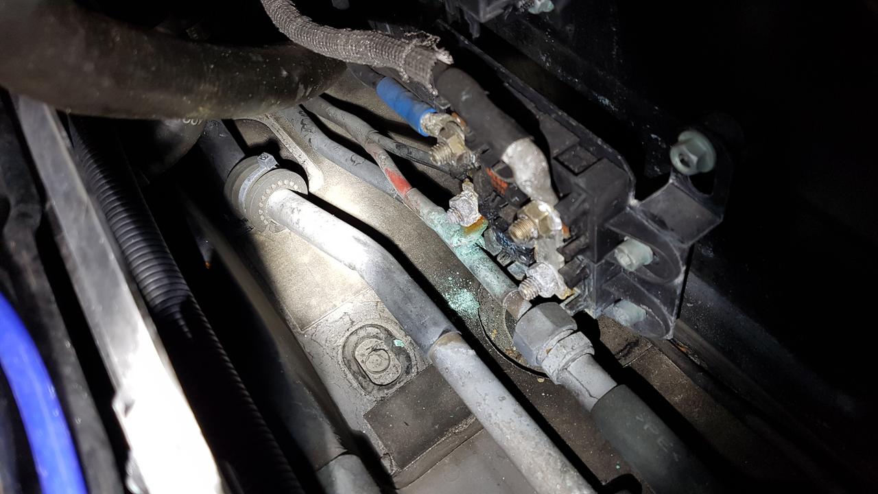

Glad I did, turns out that even though the area below the expansion tank was bone dry and free of debris, (and pretty much always has in my 11 years ownership of the car as it is always garaged), seemingly in the past it must have been wet in there as the large live wire that connects to the (lower) 200amp fuse was seriously corroded and eaten away and just a small strand of copper from the crimp was left making contact here. I have to assume that this wire and fuse are most likely related to the car starting / starter motor (can anyone confirm?). Anyway, I removed the defective crimp, cut the wire back a touch - luckily the wire was actually perfect, and have ordered some M8 x 16mm2 crimps and a heavy duty crimping tool to hopefully put things right. I also bought a new battery, a Varta OEM from Tayna batteries for £120ish so will swap the old battery out as well.
I'll add some pics later when I get home.

Post by skyegtb » Sun Oct 06, 2019 6:32 pm
Here's the pictures of the dodgy crimp / cable.
2003 RS6 MTM 568
