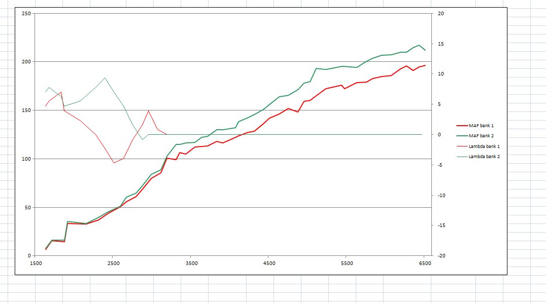

You need to log the MAFs under driving conditions. The grams / second is the interesting thing. For each MAF.
Like this:
Like this:

You posted while I was preparing my post.
There shouldn't be more than 10% difference between the MAF readings. Most likely is an air leak. Worst case, you've got a lazy turbo and there's an imbalance.
Having said that, your incorrect readings at idle kinda preclude a turbo problem. Most likely an air leak. I hate those airboxes.
