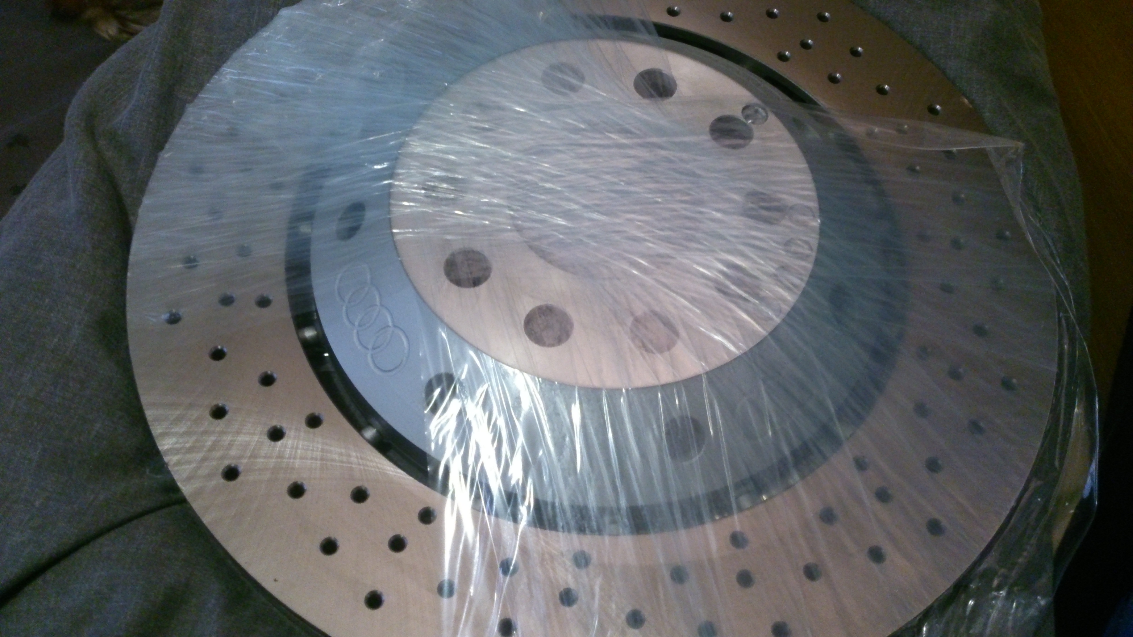

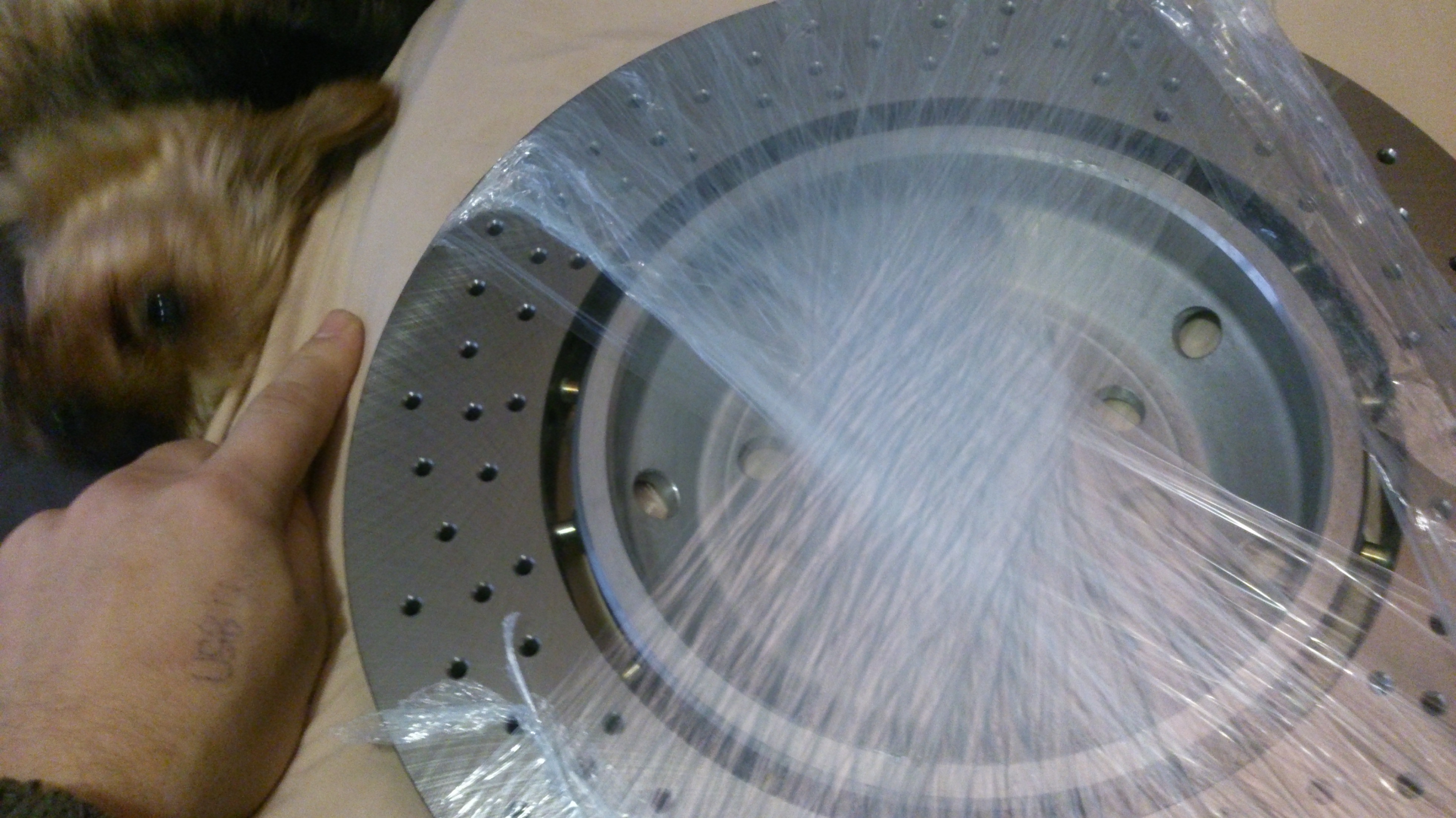

The rs6 discs aren't 1 piece, they're floating on an aluminium hat.
Like this :
