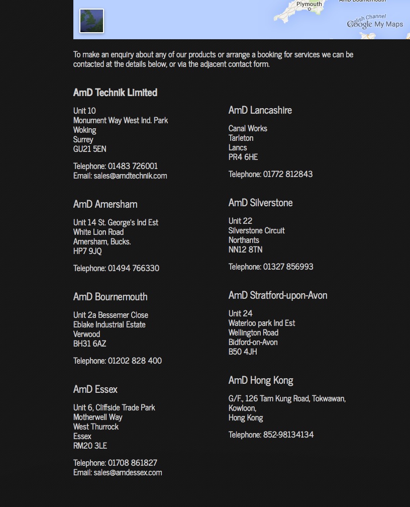

bam_bam wrote:AMD in Woking?! Are these the guys that aren't affiliated with the mob in AmD Essex?
Same company, two different locations.
Woking HQ and Essex to service 'the other side of the 'M25'...
http://amdtechnik.com/
Callipers - have to be Grey for me...
