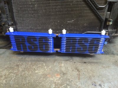

Did you source them your self? Where abouts are you based? I'm just about to buy a new oil cooler from Audi (£755 inc staff discount) but this looks a lot cheaper, how much did the two coolers cost you? Presumably one for engine and the other for gear box?

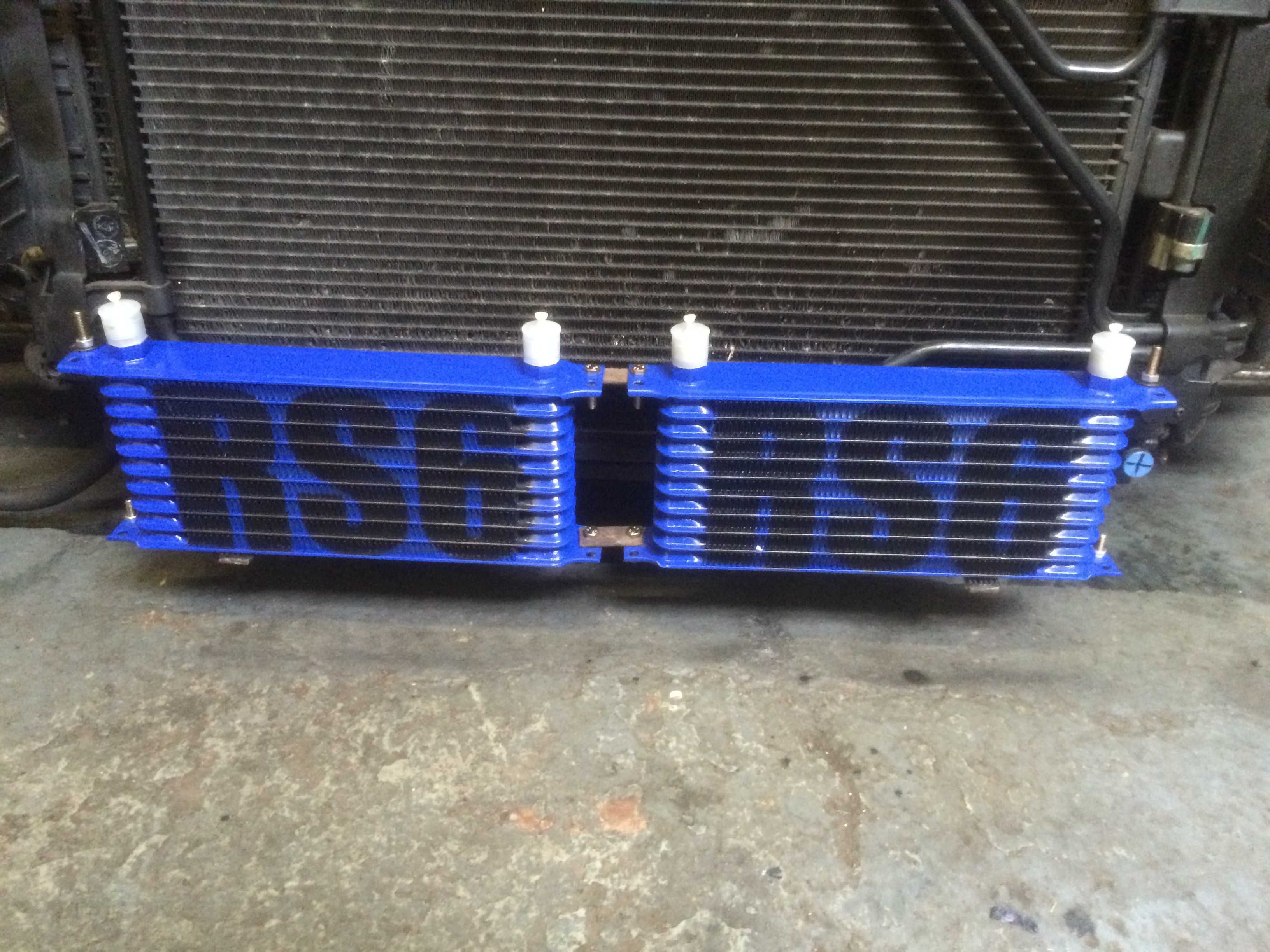

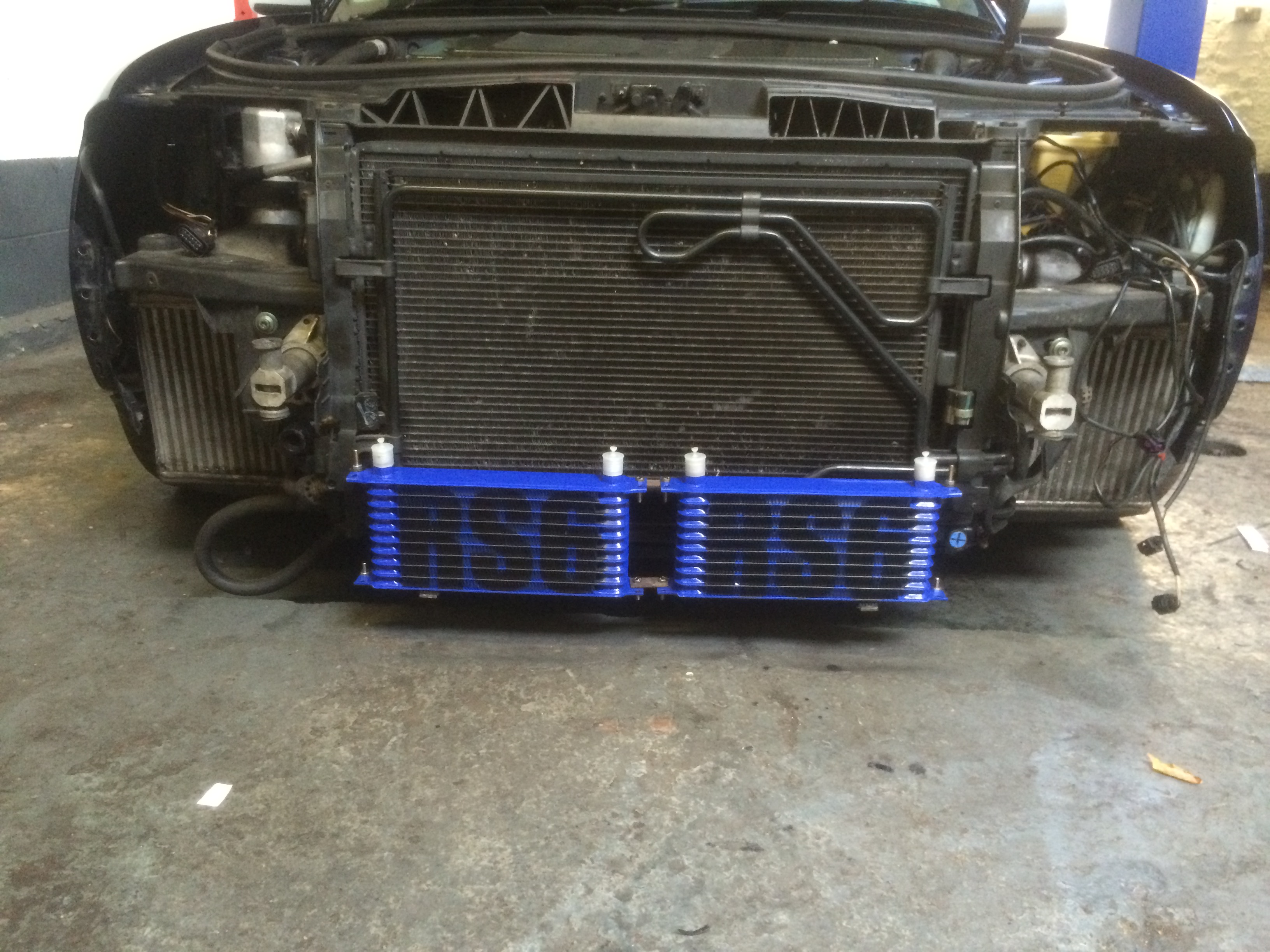

Fingers crossed, found an M16 weld on aluminium piece at Think Automotive - so long as the pipe seats properly we're laughin' like Budda. Will let you know...
Which coolers did you choose for the job pictured? If my idea goes pear shaped, I'd been told the engine is 60' and the gearbox 40' split in the original cooler but those shown are equal width and frickin' tall. Did it all work out?
