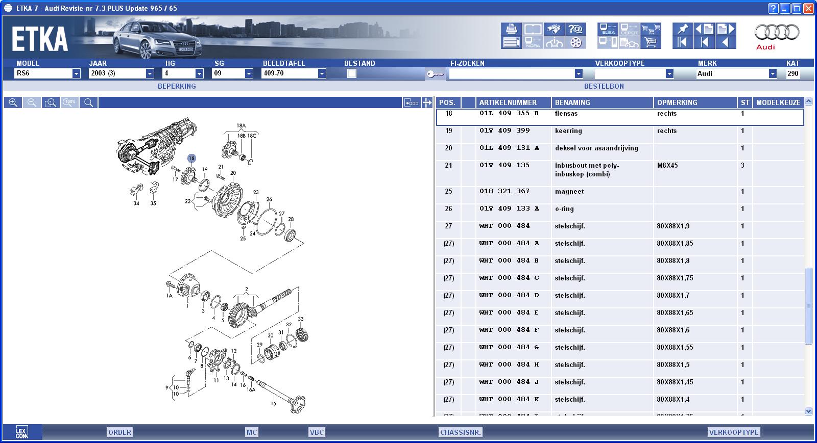

...piece 18 is moving along with the cv joint...
