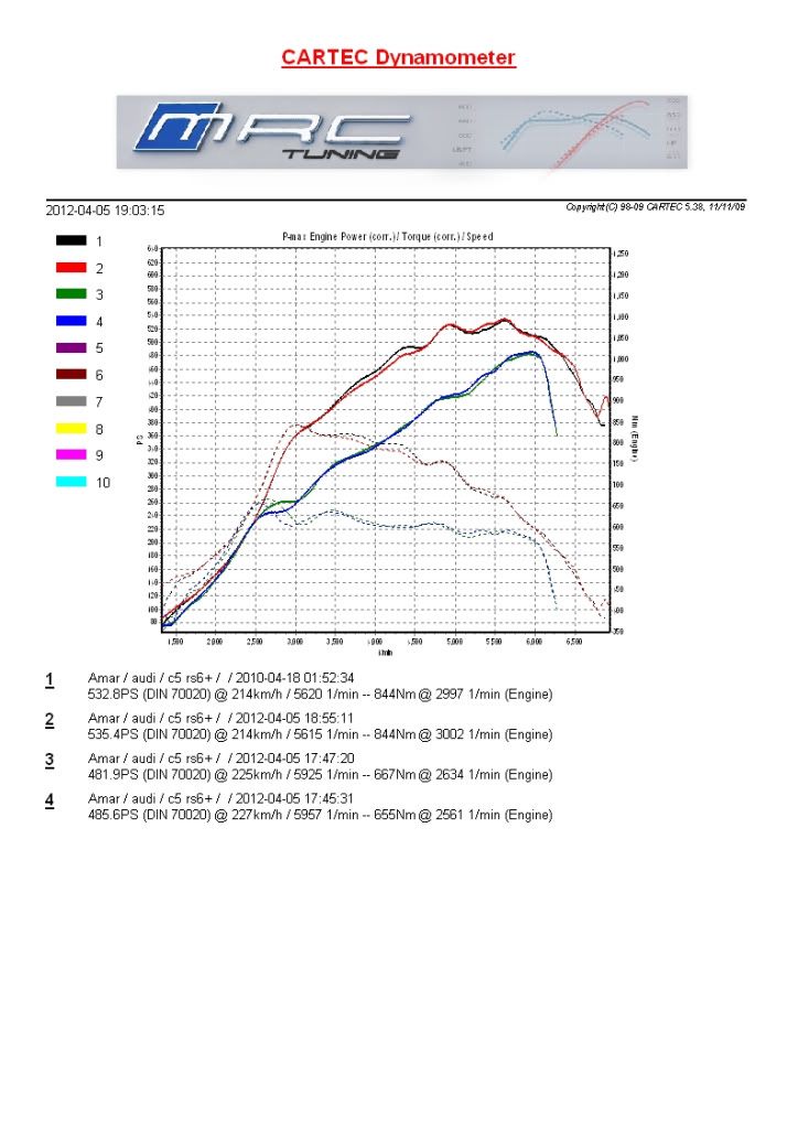

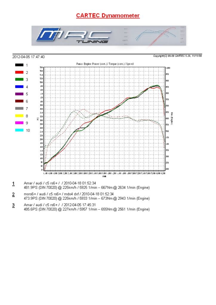

Then you want to gut your pre cats and get a stage two remap, about £1300 iirc, add another £900-1,000 to that if you haven't already got a Milltek.
Here are my graphs, it did 473 in April 2010 stock, then 481 last week stock and I think the 486 is with the downpipes and then 535 with the map. I'm not 100%, hopefully Doug will come across this and make it clearer.

i will be having mine back on the mrc dyno on the 4th of may so will see the difference in mine with just downpipes gutted.

Amar wrote:I think the 486 is with the downpipes and then 535 with the map.
Odd. JVCiggen made a lot more power by removing the precats and that on a standard map. I wonder where the difference comes from.

Shoppinit wrote: Odd. JVCiggen made a lot more power by removing the precats and that on a standard map. I wonder where the difference comes from.
I did have Wagner IC's as well, which heat up slower than stockers so the power curve stays "on course" a bit longer in dyno conditions. Well it's a theory anyway.

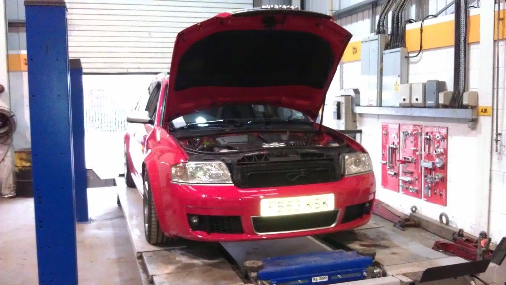

Well, here is my motor on the ramp at work ready for the downpipe change -
Here is what i normally work on in the back ground -
Spent 4 hours on sat morning with my mate lowering engine/box only to find that trying to do the work on a 4 poster ramp makes it pretty much impossible :thumbsdown:
So long and short of it is, gutted downpipes are sat next to the ramp still and mrc will be fitting them.
We did have a look at the gearbox situation and can see how the guy's across the pond do it with engine in but can also understand why most people renove the lot.

Well you gave it a damn good go and at least saved yourself a load of cash gutting them yourself :)

Can't you use the ramp to raise the body on blocks?
Re: pre-cats
Post by chunky79 » Mon Apr 16, 2012 4:46 pm
Shoppinit wrote:Can't you use the ramp to raise the body on blocks?
The actual ramps are stupidly wide. I did my van's cambelt on there the other day and told my gaffer it would have been better doing it lying on the floor.
I now know why companies like mrc, unit20 and so on have 2 posters with legs that fold out
