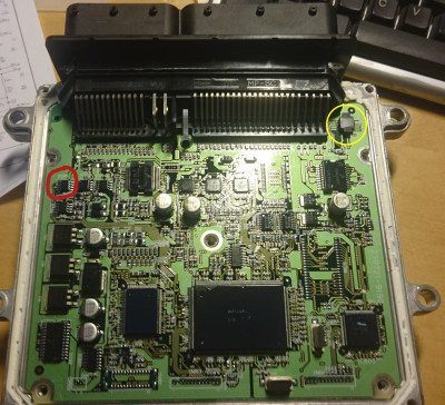

Might have a go at repairing the ECU myself. It looks like there's an IC that can fail. Doesn't look too hard to unsolder:
The part that fails (red circle) is, apparently - I haven't opened my ECU yet, a NXP TJA1020 LIN bus controller. Can be replaced with a beefier TJA1021/10.
All this according to *one* forum post, though.
Do you reckon the eeprom (yellow circle) contains all the immobiliser info for the ECU? I wonder if I could transfer it to a second hand ECU. Any thoughts?
