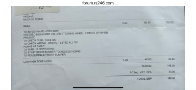

I was having some other work done at the garage and asked them to replace the horns as they were not working.
The original replacements were nla.
So they got what they could for hi and low horns
I am really happy with them. Much better than the originals
I will check the invoice to see if there is any info on it.
If not I will call in the garage on Monday and get the info as they don’t work weekends.
They are about 500 yards from where I live.
Steve2003rs6
- Posts: 2967
Re: Breakdown
Hi Craig.
Not much info on the invoice other than they cost £40.00 and it took 2.5 hours labour.
I will call in on Monday and see where they got them from.
Steve2003rs6
- Posts: 2967
Re: Breakdown
Called in at the garage. Had a Quick Look without success.
They want me to give them the invoice date.
