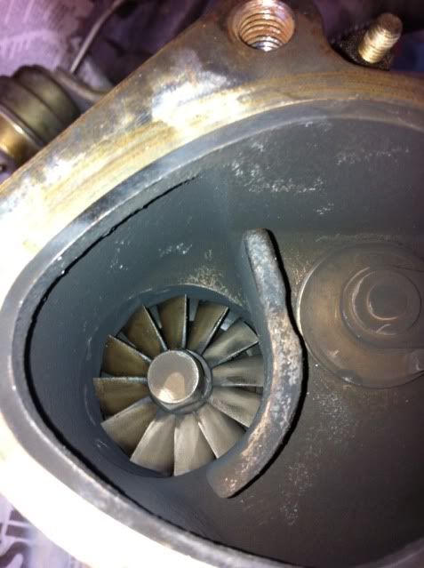

Pic of blades
Chunky - not sure mate..
Shop - lol, i think so :oops: anyway i can check? I've got both manifolds and turbos sitting infront of me.

Probably best to get professional opinion on the condition of the housing, turbine and compressor. CR turbos or turbo dynamics

Turbos fully re-conned with genuine Parts (2 year guarantee),
New Torque Converter and reverse sorted (1 year guarantee),
2 Manifolds (thanks Luke),
Full service and a few other bits.
Car is running sweeeeeet! God I missed her!
Thanks for all the help and support :thumbs:

What did they say about the turbos? Any insight into what caused them to hari kiri?

Shopp - the broken part of the manifold dropped into the other side of the turbo and destroyed the blade pretty much. The other turbo was fine but i got both done.
