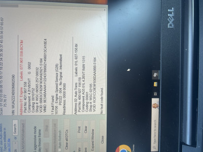

For the hell of it I did another scan this morning.
This is what was showing.
Hopefully it’s connected to the “fuel pump” problem.
Re: Breakdown
Well, that’s your crank position sensor.
Re: Breakdown
I second what Ben has said.Shoppinit wrote:Well, that’s your crank position sensor.
It’s too much of a coincidence for both to be faulty.

Would tapping the fuel pump fix a fault on the crank position sensor. ?

Re: Breakdown
No, just coincidence.

I guess I have a crank position sensor fault, and the fuel pump diagnosis was a pure coincidence.

You have fault codes for crank sensor now though so it's pointing that way at the moment
