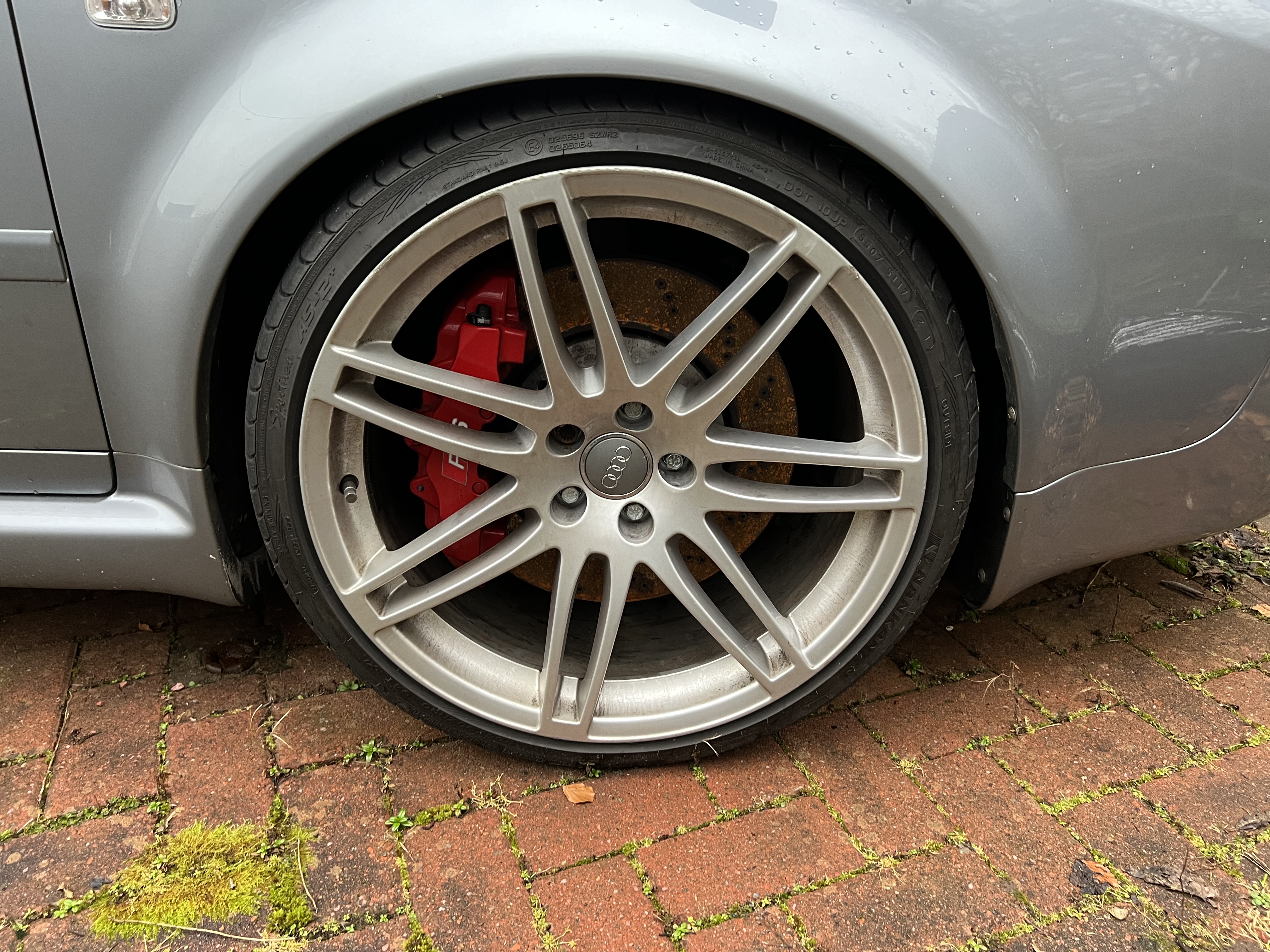

Finally a wheel on pic, excuse the disc corrosion, she’s been having a rest the last couple months, will be out again soonFoxmeister wrote: ↑Wed Dec 28, 2022 7:50 pmSorry mate, had been busy with work in the lead up to Crimbo etc and havent been on much, heres some pics of mine fitted, i'll get better ones with wheels on also when i have a chance, currently battling manflu![]()

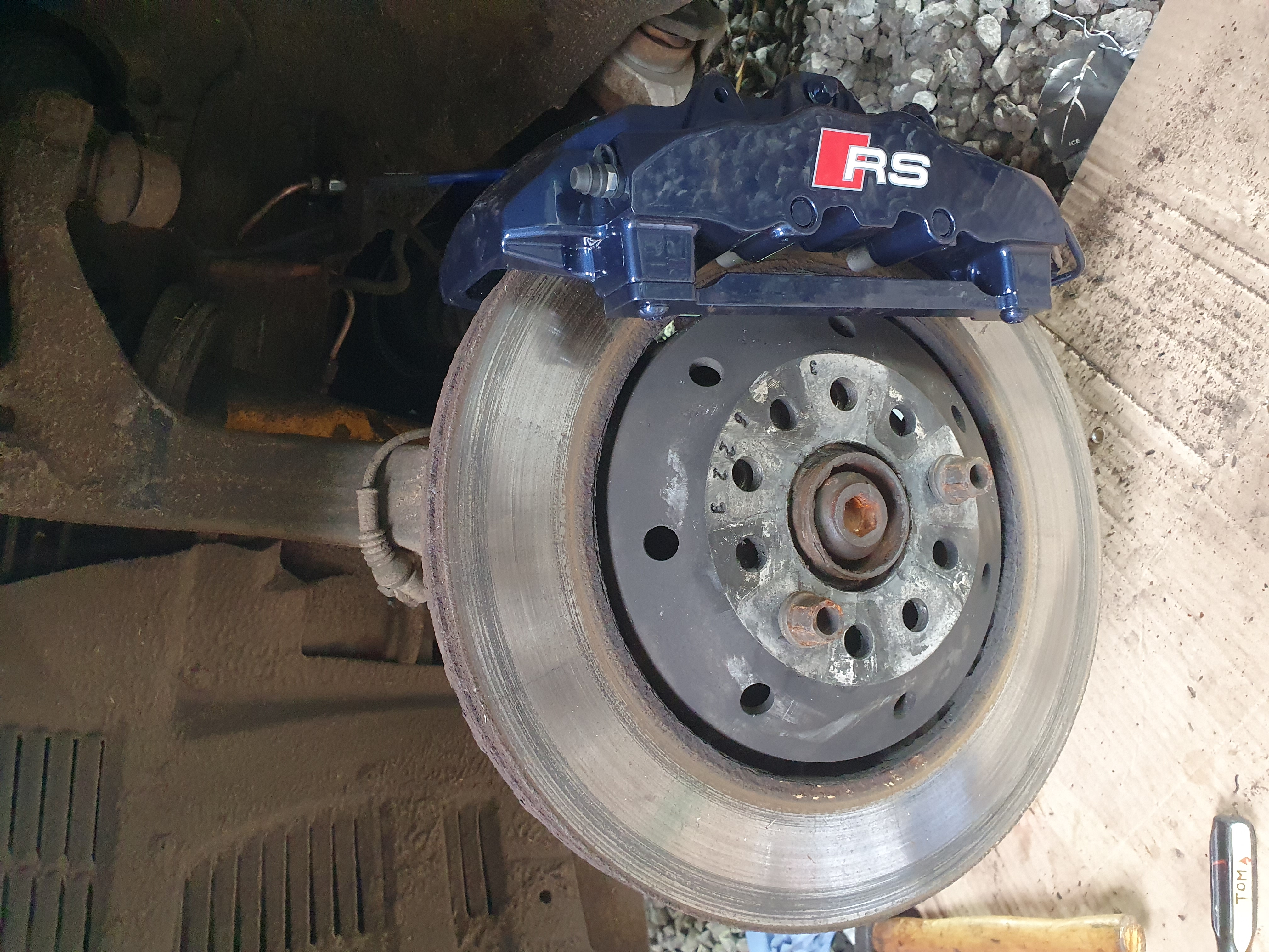

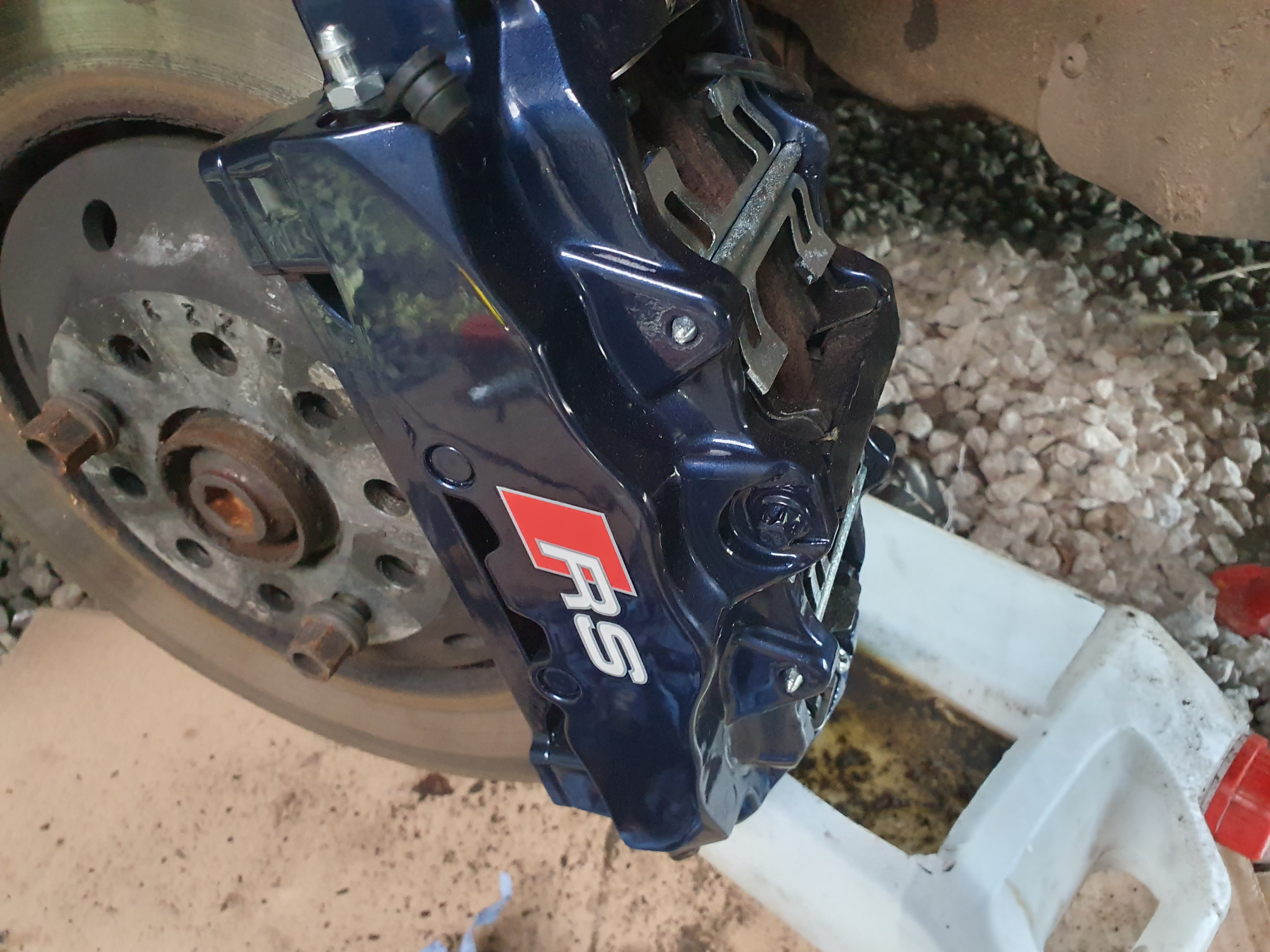

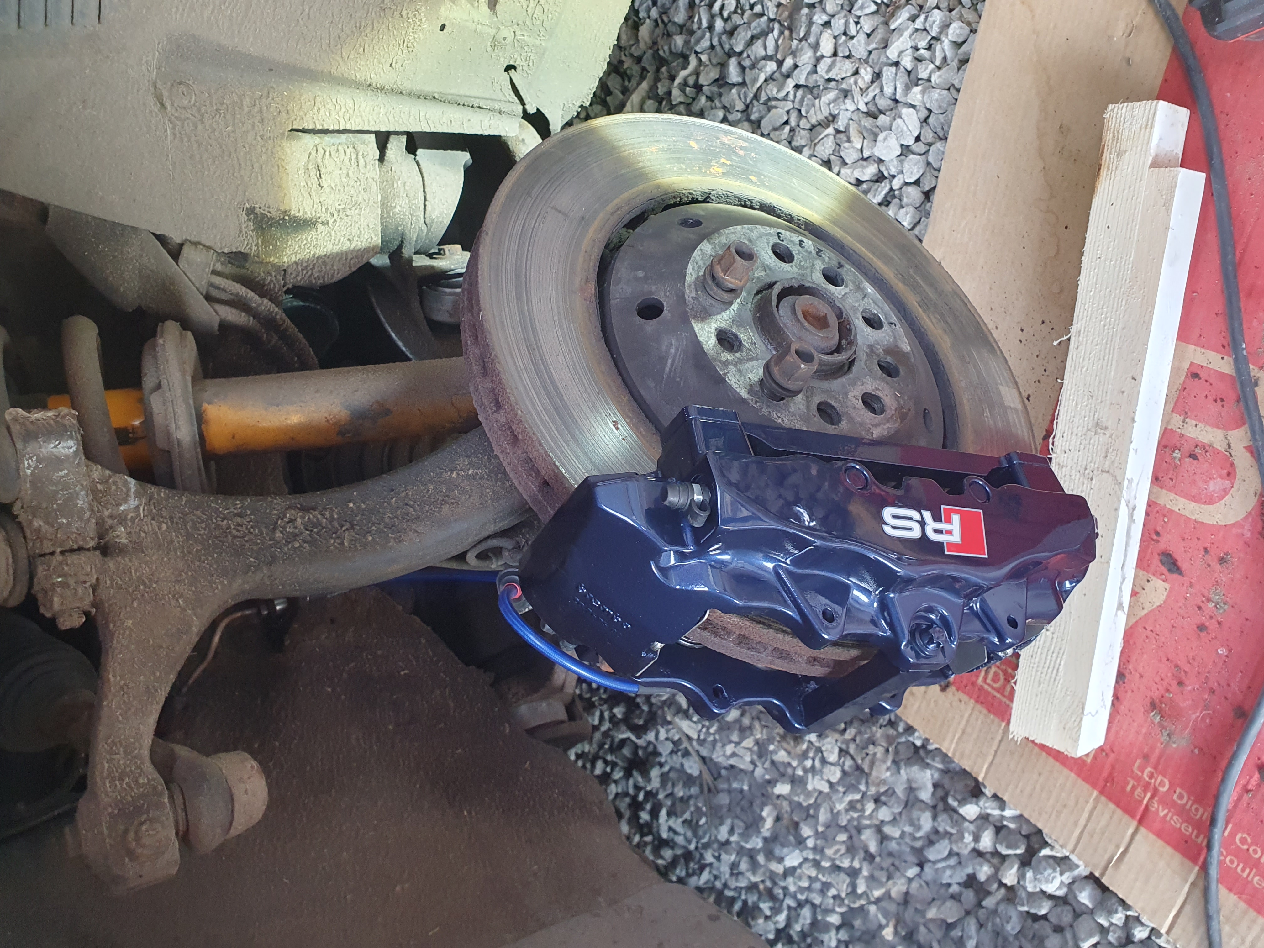

Just to add another pic to this thread I had my calipers done by Brake Caliper Refurbs in Rochdale. I just decided to go low key and had them match my cars Mugello Blue, at least if it need touching up I already have that colour. Im happy with them and one nipple needed to be helicoiled as it had lost its thread. I also put on some Wezmoto braided hoses as I ended up cutting the original ones off.
