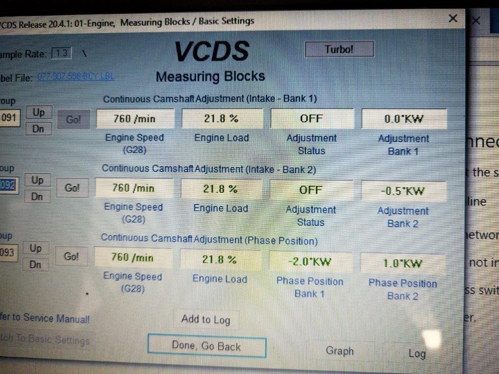

Post by Gregstv » Wed Sep 16, 2020 9:51 am
Finally got it back together enough to run it, This is what I got from group 91,92 and 93 after running it up to temp.
Mɐʇʇ
Posts: 2727
Re: Camshaft Timing
Post by Mɐʇʇ » Wed Sep 16, 2020 10:01 am
Spec is +-6 on group 093, so you're good to go! :)

Post by Gregstv » Sat Sep 26, 2020 8:41 am
Fun day. The cam timing was only advancing to 16deg on bank 2. Bank 1 goes to 21.5. checked voltages to the cam chain adjuster and it is fine. Unplugged the cam angle sensor and plugged it back in. All bank 2 readings changed again. Move the harness and it came good. Looks like I need to operate on the harness and find out what is going on. All the black cable wrap is brittle so I think I have some bare wires somewhere.

Post by Gregstv » Sat Sep 26, 2020 9:04 am
First few times I started it it was 0 to .5 on group 92 at idle. I changed the MAF today moving the harness around the cam angle sensor. Group 92 went to -10 at idle and only 11 deg advance. Played around again and it's 0 at idle and advances to 21.5 same as group 91. Maybe a bad cam angle sensor now I look at the numbers. -10 plus advance of 22 is close enough to 11deg which is what I got.
