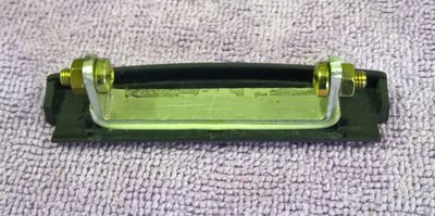

Waiting...waiting for the post to deliver the new P3 gauges analogue control unit. While so, I have the same issue as many with the center front arm rest lid catch, broken. I understand that a repair kit is available but if it is anywhere near as fragile as the original I can't see the point. I tried using magnets and while the idea is sound, the execution lacks a little in providing the sideways location that the original catch does.
In the end I made up a new bracket in aluminum. It fits perfectly to the thou, works a treat and is invisible when the catch is fitted. It should also last a damn sight longer. The tape is 3M for bonding metal to metal and it is permanent. One more little job out of the way.

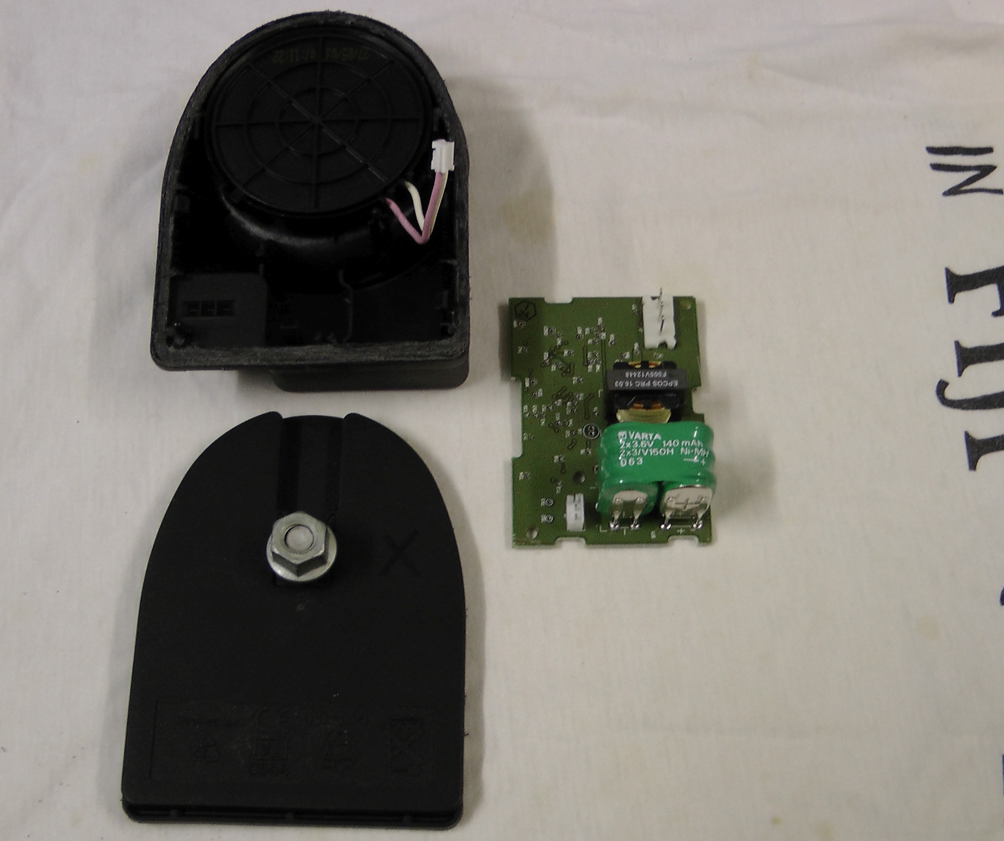

Further to my earlier post and with all the spare "isolation" time, I've got myself a little educated on the Alarm horn. Firstly, the fitted batteries are Varta 2x3.6v V150H rechargeable cells, which, as said elsewhere, are no longer available. There are alternatives however so a repair is not out of the question.
My first mistake was thinking that the alarm battery would be a nominal 12v as it is charged by the car system. It is actually 7.2v and I haven't spent any time on working out how it is charged and the voltage modified. I did find the spec sheet and Varta's published lifespan is 6 years trickle charging at 20 deg C or 3 years trickle charging at 45 deg C. Based on that, a max of 6 years and it is on borrowed time. So after 16 years it's done well.
The horn I removed is date stamped 2003. The circuit board is actually unmarked and there is no corrosion to be seen. This horn did chirp on door locking but voltage across the battery is 6.7v and as it was removed after a few hours on charge it would seem that a / the cells are fubar anyway. The horn has only been out two days so I'm waiting a little longer to see if there is any appreciable voltage drop but normally a week would take the (new) start battery down to about 12v so there was some serious parasitic load somewhere. While the horn seems to have a number of minor functions, there doesn't seem to be any adverse effects by removing it, other than the bleeding obvious of no chirps.
