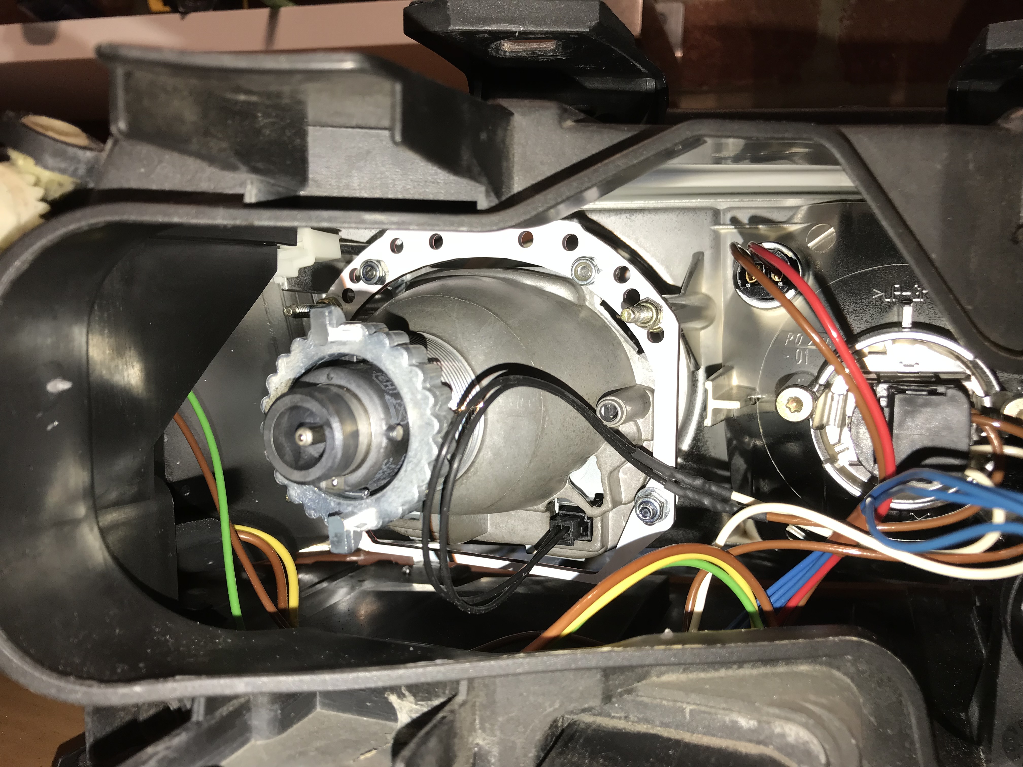

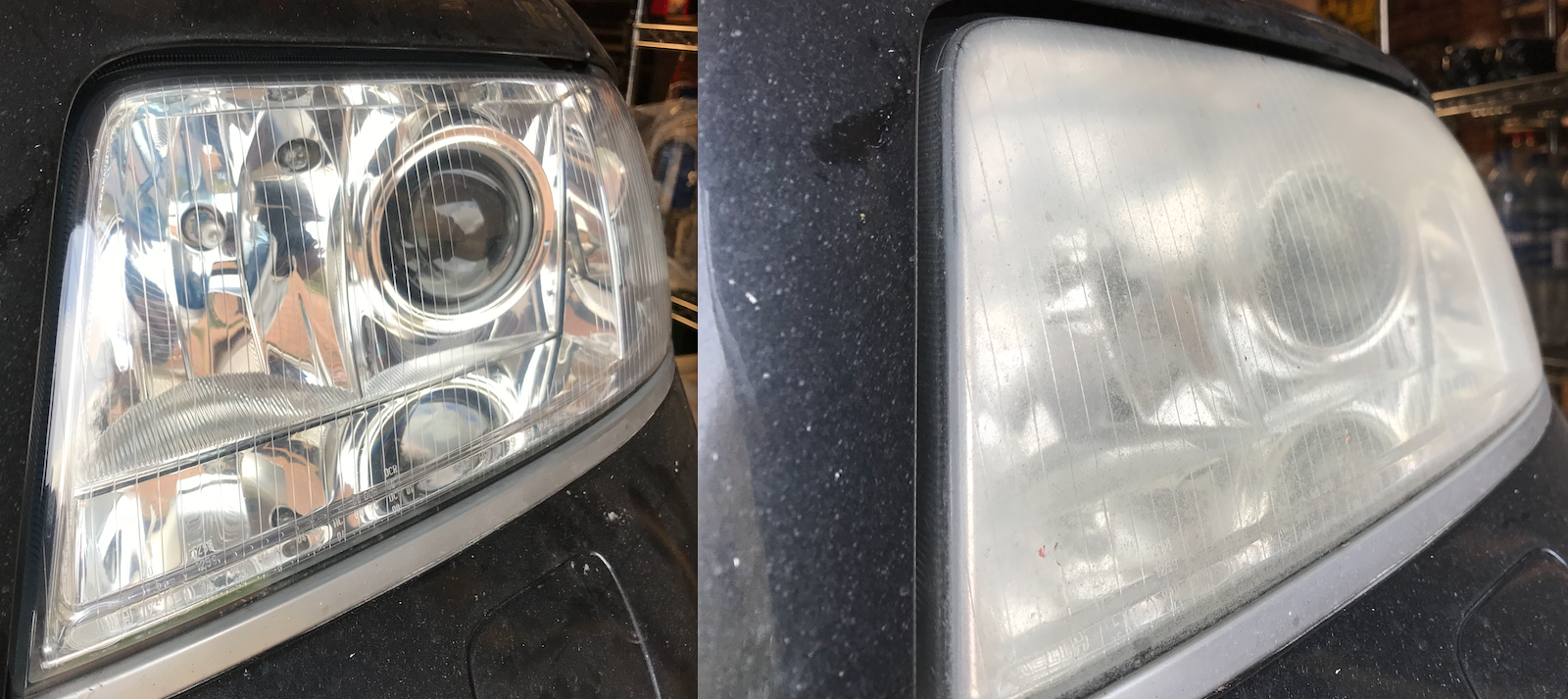

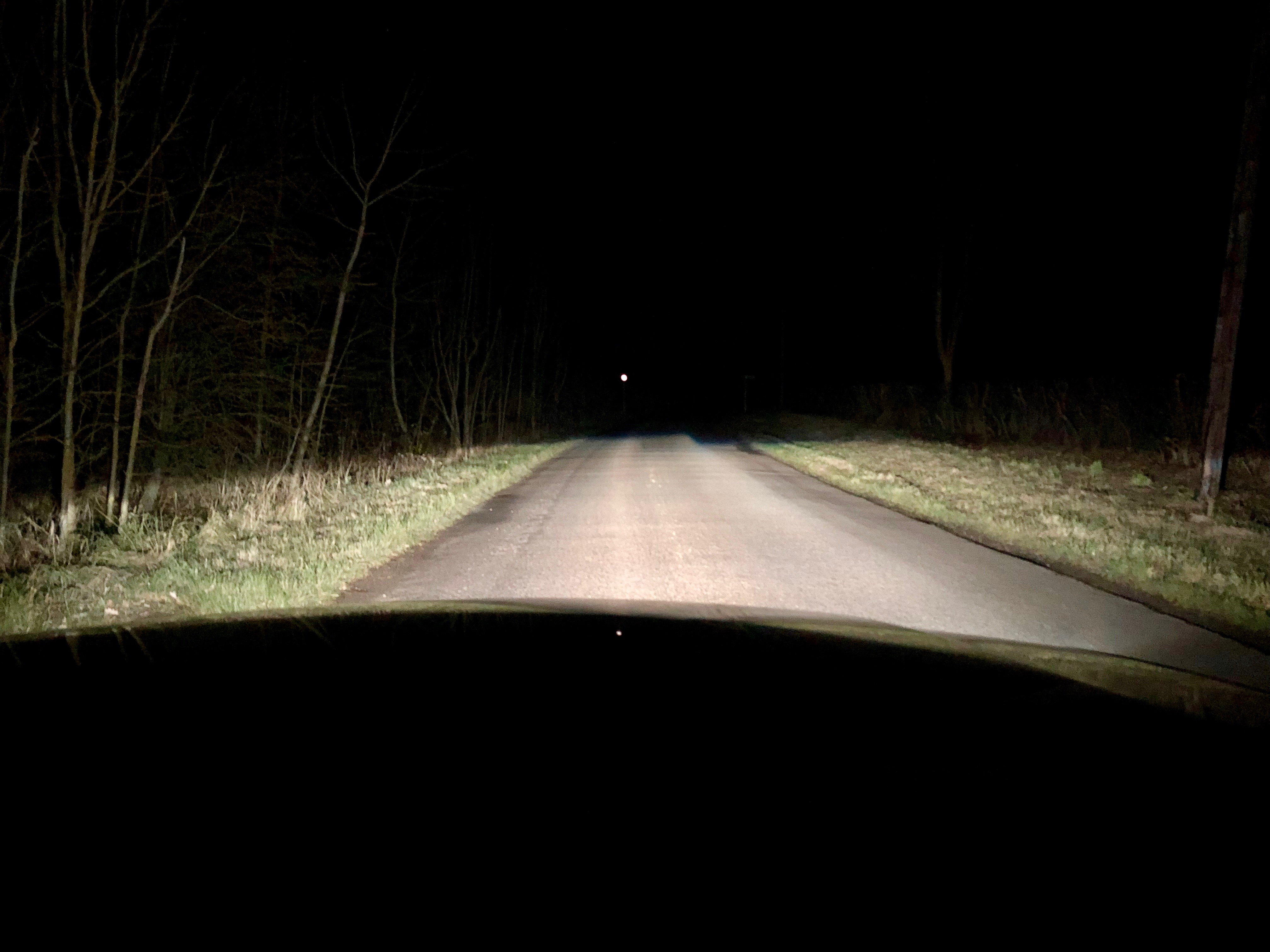

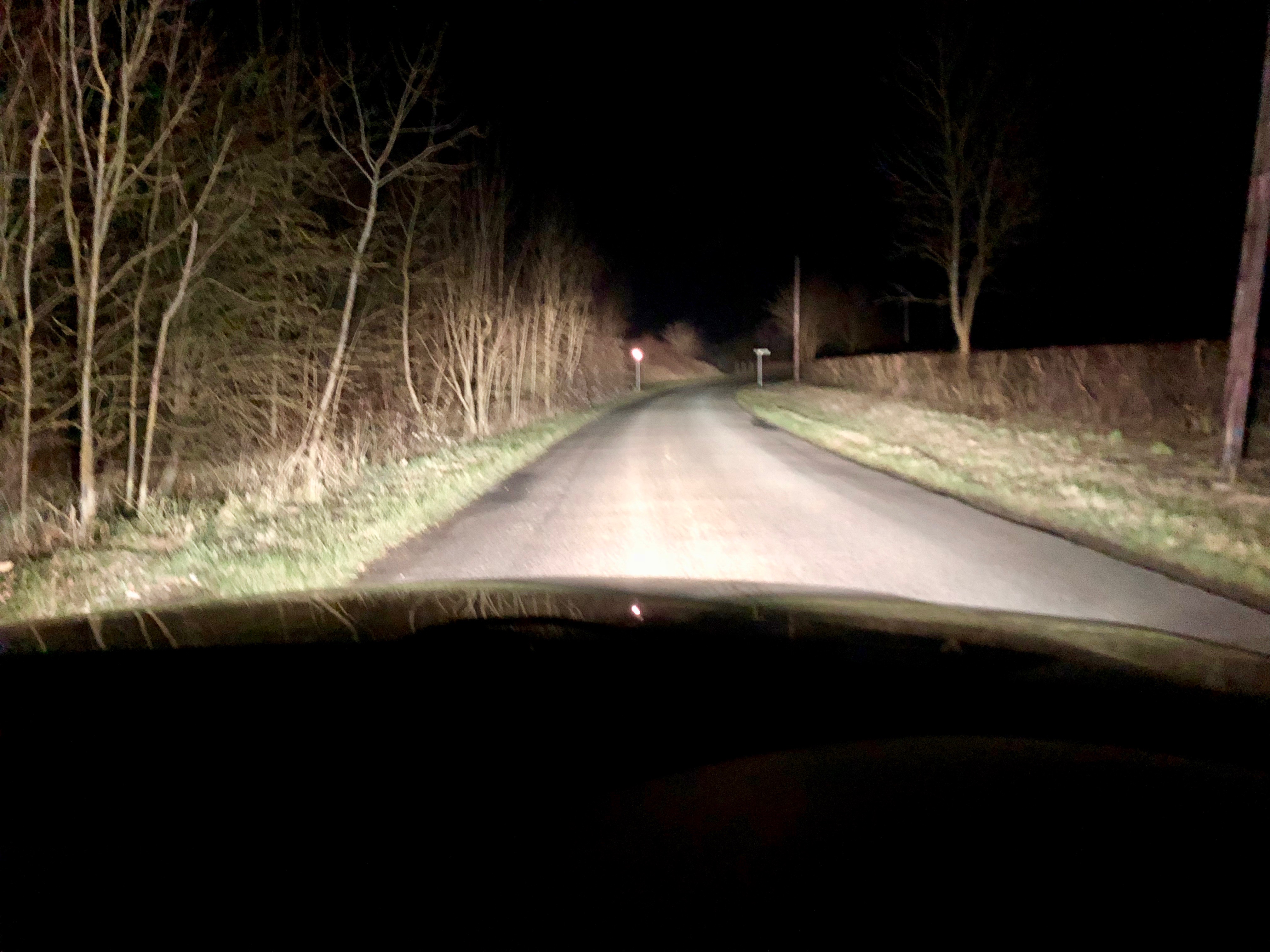

My lights were looking rather sorry for themselves, rather faded, one with a leaky seal, one with a broken adjuster and bulbs of unknown age.
So I took them to Trups and he worked his magic.
Lens refurb, new projectors and new bulbs all round.
The refurb of the lenses is unbelievable, they are like new!
The Morimoto Mini D2S 4.0 projectors again are unbelievable, so much light!
Its hard to know how much comes from the refurbed lens, new projectors or new bulbs but in my opinion most of it is from the new projectors.
Bulbs are Osram Night Breakers for HID and full beam.
I would highly recommend this upgrade and Trups.
One thing to note is you will need to code the headlights differently so they are at rest higher via the motors, as the Morimoto projectors naturally aim lower than the OEM units.
Apologies for the state of the car but you can see the transformation of the lenses.
