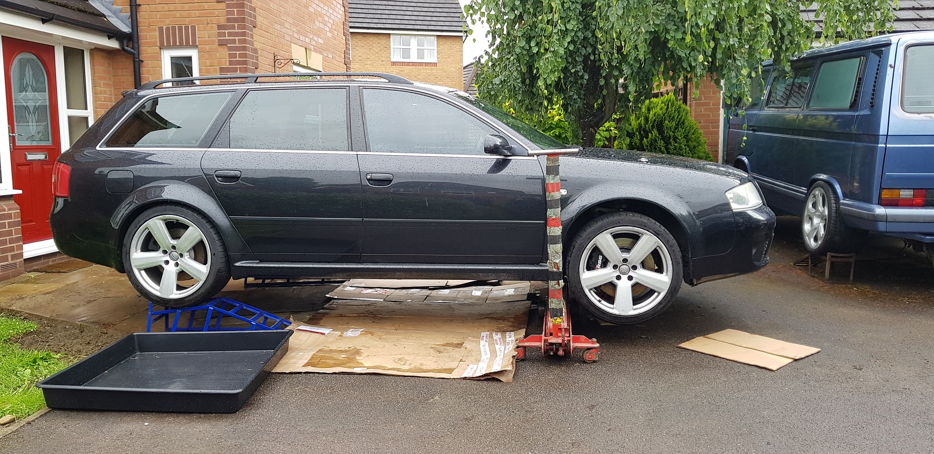

This weekend has been horrible mostly due to a bug that kept me in bed (apart from hugging the toilet lots!) but I managed to crawl out of bed on Monday and get the RS6 up in the air and have a look at the gearbox.
Oh, despite the photo looking like it's held up with the jack, the front is on 2x axle stands under the subframe and the back is there as a safety only.
Once up, I drain what was in the gearbox (sump plug was loose!) into a drain tray and measured it. 3 litres... stinking of friction material!
I dropped the sump (obviously someone has been here recently as some of the bolts have been replaced) and checked the filter.
There was another litre in the base of the sump but that only makes up 4 litres total in a gearbox that holds 9 litres. The underneath of the car is blathered with oil from the gearbox!
I also checked that there was no damage to the filter (cracks etc) and that the pickup pipe was the correct length which it was.

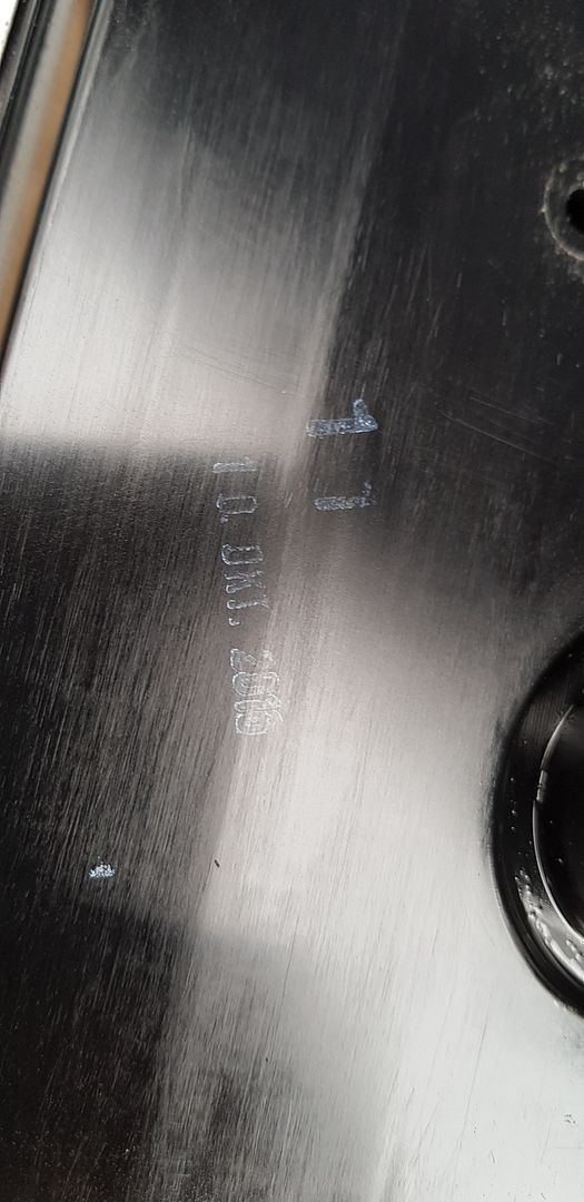

Looking at the date on the filter, someone has the same thoughts as me...
