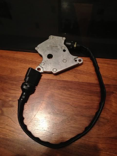

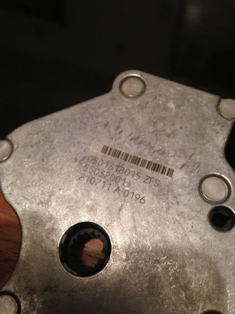

Quick one guys; my younger bro picked up the part for me today from TPS.
The box looks a bit shabby so here are some photos of the part.
Is the finish meant to be like this and is this the right part? The tatty box is making me think someones returned it? Am i just being paranoid lol!

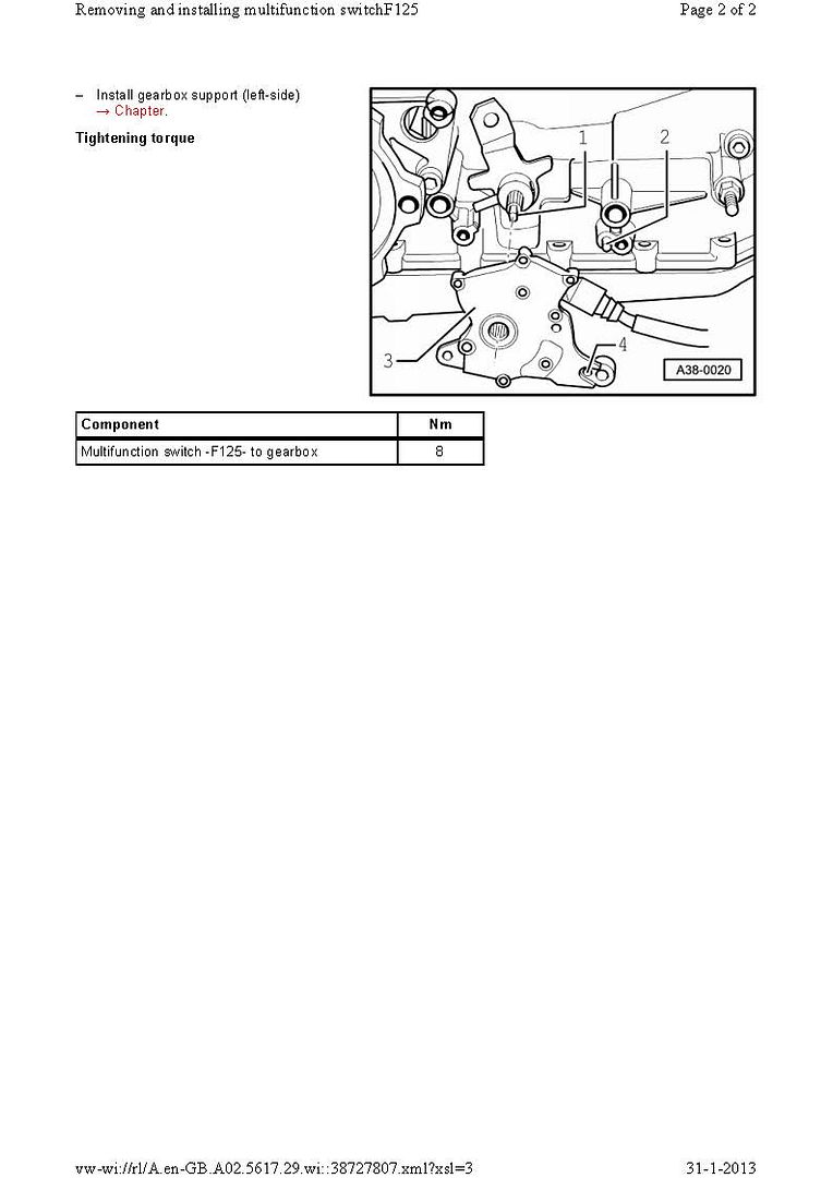

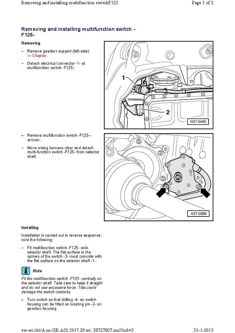

Re: Gearbox weirdness
...sorry, didnt notice Shop already posted an diy...
Sid, there should be a date of manufacture on the part / box, could be old stock.
19/10/2011.
No expiry date.
Hate it when i get new parts in tatty boxes, just feel paranoid that someones tried it and returned it...
That's almost certainly what's happened. Doesn't mean it's a bad part though, and if it fails, Audi will replace it including labour.
No expiry date Sid, the date of manufacture on the box is 19/10/2011, there's sometimes the same on the part itself.
