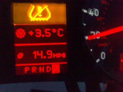

Post by marmite » Tue Oct 23, 2007 8:16 am
For the 3rd morning running had this joyfull sign up
Goes after cycling the ignition again
will have a look tonight when I get home what is going on

Post by skiwi » Tue Oct 23, 2007 8:31 am
do not believe the "battery life" left figure reported by the controller. it tells porkies....

Post by marmite » Tue Oct 23, 2007 9:06 am
skiwi wrote:do not believe the "battery life" left figure reported by the controller. it tells porkies....
I will see what it is saying in the morning..warranty job

Post by marmite » Tue Oct 23, 2007 2:13 pm
Went to Audi Lunch time they squeezed me in like they always do and surprise surprise faulty battery o/s/f sensor
covered by Warranty too.result :)
