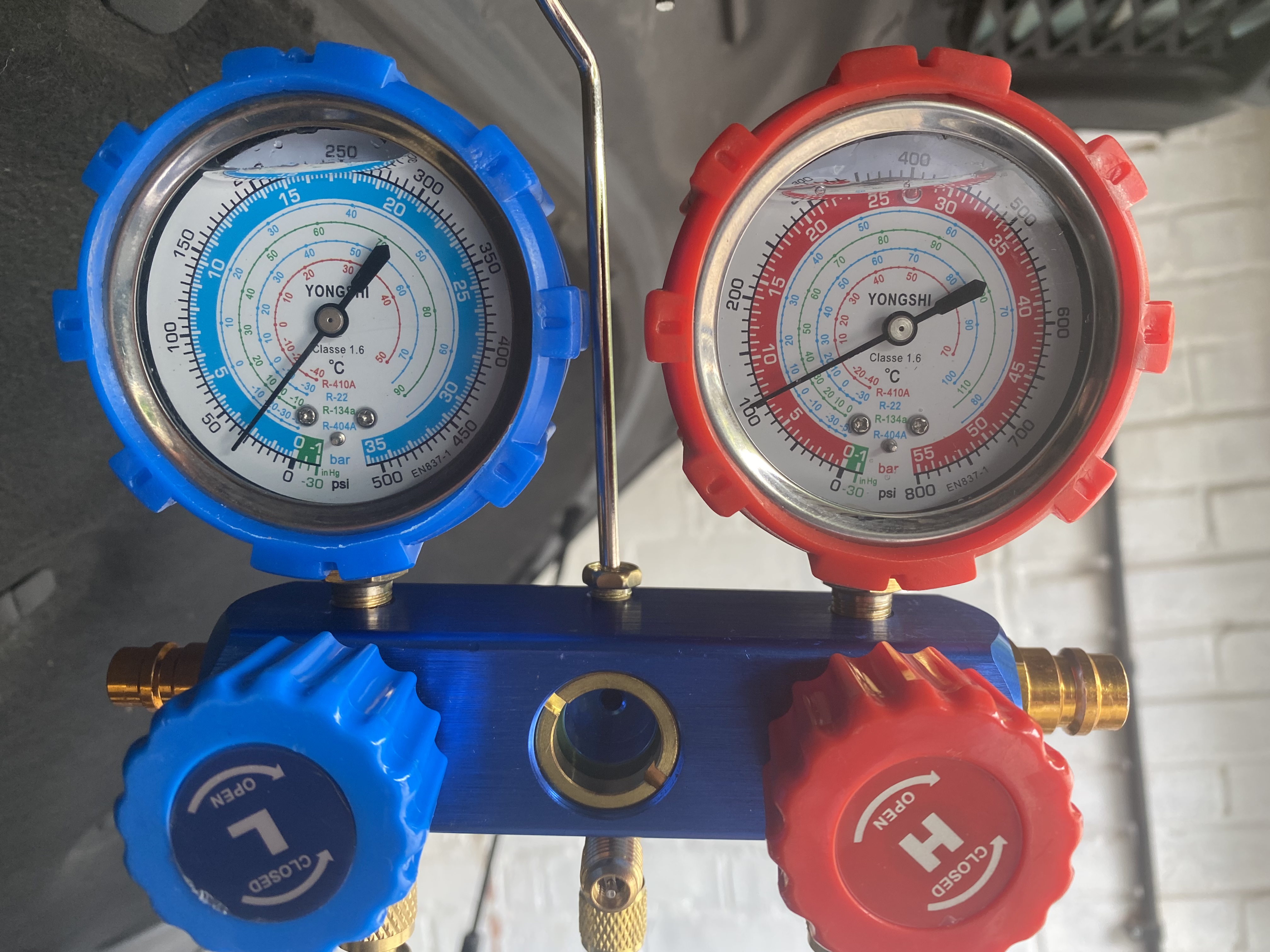

Well it all looks professional. No idea what I’m doing though. :mrgreen:
The high pressure side starts at >150psi or so and then drops once it's got going and the air is cold.
I suspect I’ll be buying a vacuum pump soon, just because...

High side seems a bit low. What are your static pressures (engine off and cold)?

Yeah, it started higher and then dropped. It does pump out proper cold air though - so something is working.
I thought I took a pic of the pressure engine off & all cold - but fat fingers. Will have another go.

This is with AC set to max cold, right?

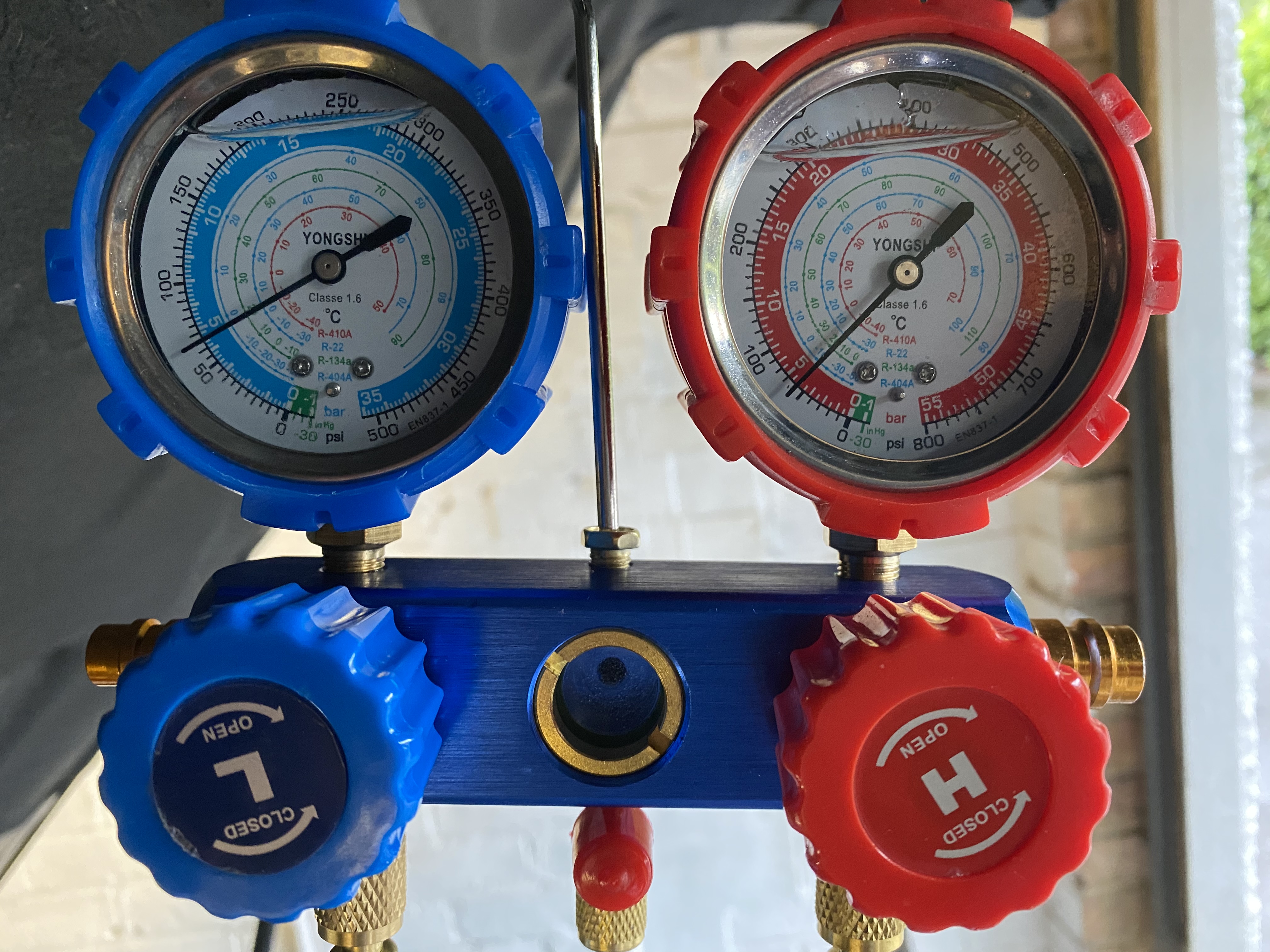

Engine off and cold.
Posts: 20345
Re: Aircon not working diagnosis
Post by Shoppinit » Tue Jun 29, 2021 6:54 pm
Looks about right. But there’s only so much you can tell from the pressures.
