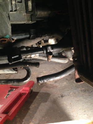

This is a silly question I know but I’ll ask it anyway. Is replacing the power steering fluid on these cars a simple task? I’ve no documentation of the fluid ever being replaced and I’d rather try this before thinking of replacing my pump.
Mɐʇʇ
Posts: 2727
Re: ££££
Post by Mɐʇʇ » Thu Sep 17, 2020 1:22 pm
Pair of hoses and hose clips, NSF running low down from below chassis rail into lock carrier area.
Those are the lowest point of the PS system I believe. Easily accessible and easy to disconnect.
Although some people just use a Turkey baster to suck it out of the reservoir.
ChrisA
Posts: 810
Re: ££££
Post by ChrisA » Thu Sep 17, 2020 1:36 pm
Great stuff, thanks Mɐʇʇ. Got to be worth a go before adding a pump to the list of invoices.
Mɐʇʇ
Posts: 2727
Re: ££££
Post by Mɐʇʇ » Thu Sep 17, 2020 2:09 pm
Here you go. Old pic, certainly not Instagram influencer worthy, from november 2014 when I first took the motor out to remind myself what went where - but it's those 2 hoses with clips, one connected, one disconnected already.
Bumper already off in this photo, but lock carrier still in place.
You can access them from underneath with the tray removed.

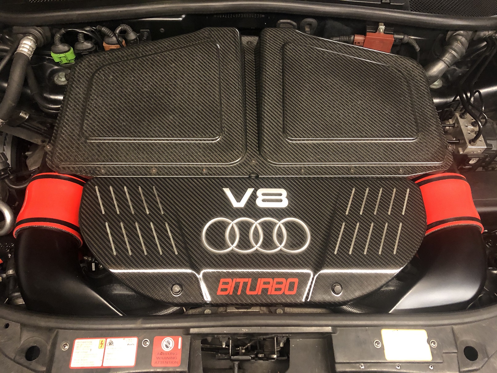

Re this. What did you do with your air intake pipes from. Have you just painted them or are they replaced with something. Looks quite smart attached to the red silicone
Mɐʇʇ
Posts: 2727
Re: ££££
Post by Mɐʇʇ » Thu Sep 17, 2020 3:43 pm
It’s a stock system.IMVHO all the aftermarket solutions are compromised, either via flow rate or heat management.
It’s stock inlets, sprayed in satin black along with Roose motorsport hoses in cherry red (good match to the RS6 colour), topped off with black mikalor hose clips.
(8 needed cos the don’t make them long enough)
Human Joist
Posts: 487
Joined: Sat Aug 02, 2014 6:04 pm
Re: ££££
Post by Human Joist » Thu Sep 17, 2020 4:06 pm
I like it mate. Subtle change but suits it
Mɐʇʇ
Posts: 2727
Re: ££££
Post by Mɐʇʇ » Thu Sep 17, 2020 4:43 pm
Thank you. I can't take credit for the idea, although I did refine it with the black hose clips - another member here had the black intake & red hoses, which like you, I thought looked really smart.
