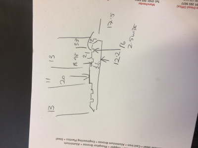

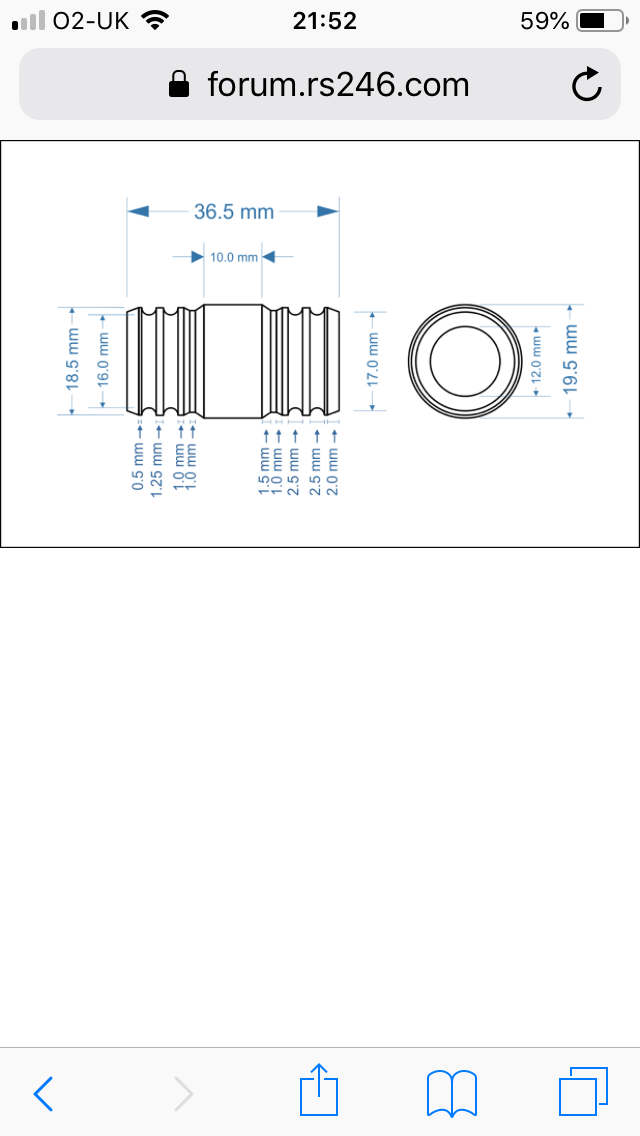

Visited machine Shop this morning. Some discrepancies on sizes when comparing the one I bought compared to the drawing provided.
So have ordered 6 pipes similar to the brass one I have recently bought.

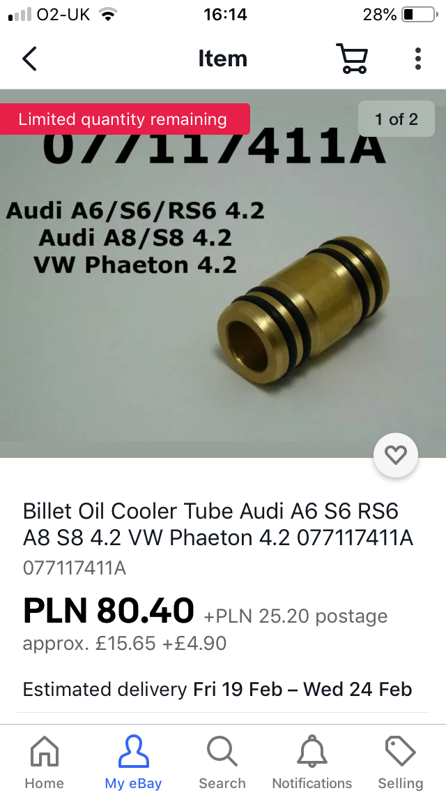

Just for info. This is the one I bought.

I should have jumped in earlier, if we accept that the Bufkin pipe is the gold standard with no fitting issues reported, then the dimensions on the phone screen drawing are exactly the dimensions of the two genuine bufkin pipes I have. The brass pipe dimensions are subtly different which may and may not be an issue.

I'll model them both and compare. Bit busy for the next few days though.

Ok all. will hold off until we confirm. Have spoken to the machine Shop and put production on hold til further notice.
