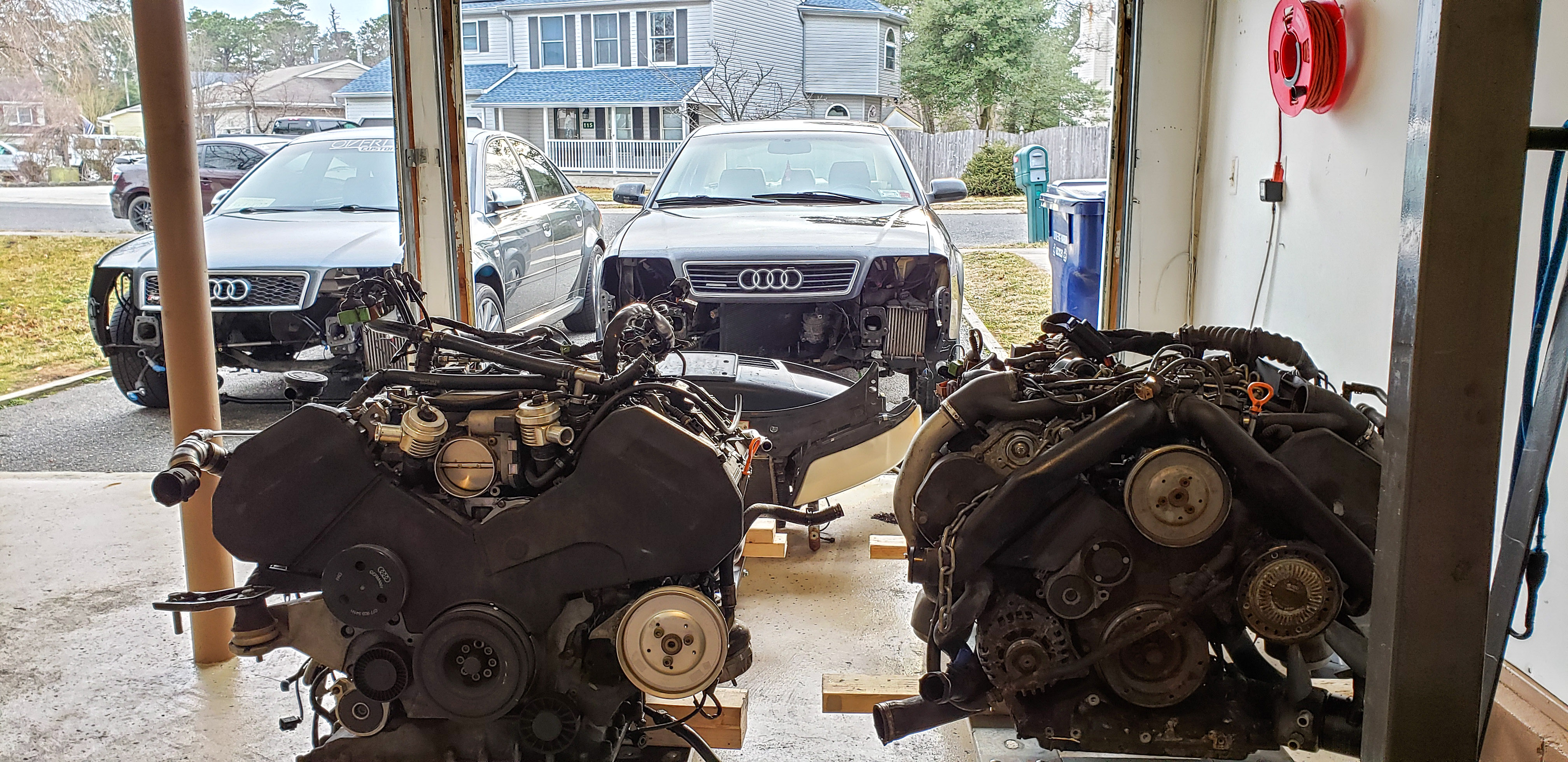

Transformation Tuesday?
Timelapse will also be in the next video (Love that stuff) lmao
Image20190224_154222 by Joel Francisco
Image20190224_154215 by Joel Francisco
Image20190226_171741 by Joel Francisco
Image20190226_171812 by Joel Francisco
