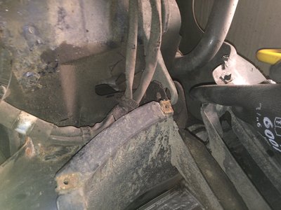

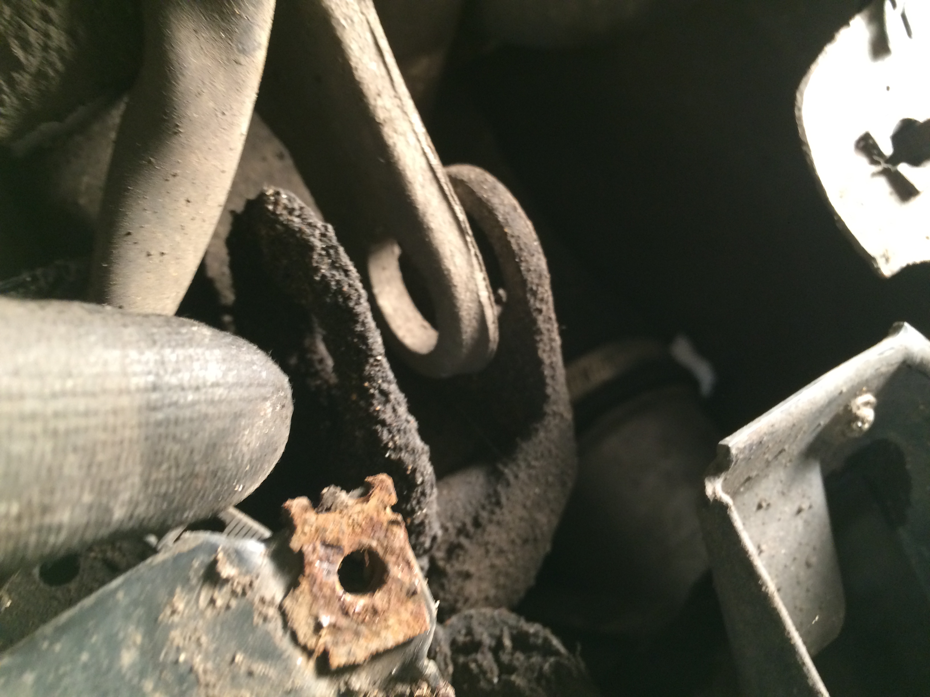

So not going according to plan as the online stuff I've seen didn't seem to have inter coolers air ducts in the way .
That aside came across this ( see pictures) should there be a bolt or something through these three holes?

Or a bush maybe??
Re: ABS and ESP lights on
No, it's for alignment purposes. There's a tool that goes in there.

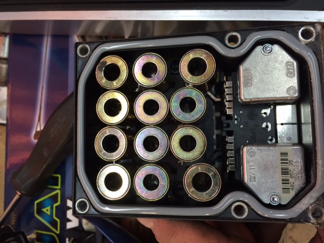

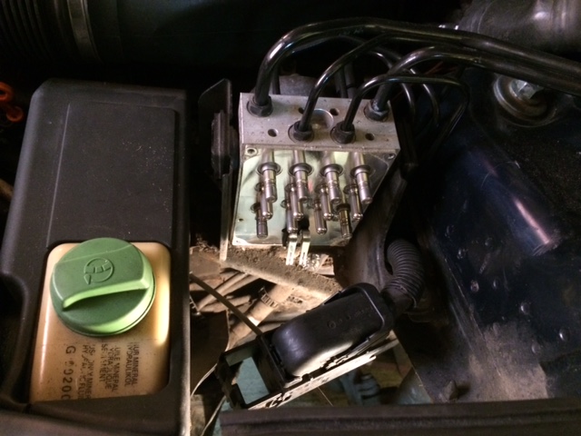

Removed and posted. Fingers crossed!
