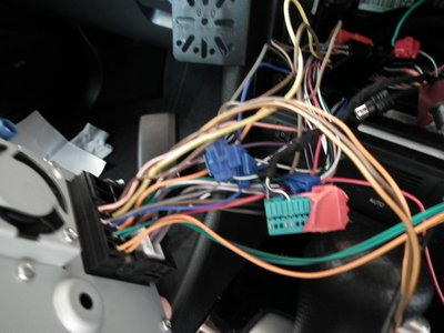

As you can see ive tried to connect the canbus H/L from the 26 pin video plug not used in the new RNS-E but has failed to work i think this is because its not true CAN ??
ive tried to connect the canbus from the 26 pin video plug not used in the new RNS-E

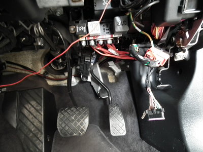

Yeah the link diddent work , yeah i think the can wires are orange the orange/brown stripe is always can low and the other is orange/pulple stripe can hi all ive done is tapped into these 2 wires from the grey connector behind the speedo cluster and run a wire from each one and tapped into the wires on the back of the RNS-E unit going to pins can h and can l, theres a diagrame on the top of the unit to tell you what wires to connect to not sure to put things back together yet or leave it till i got it sorted

rs6-sammy wrote:once I tap into the blue and white wire behind the Speedo and run a cable where does this wire go on the adapter plug, does it go to can h or can l as im not clear about this atm and don’t want to damage anything or blow it up
have added some pics of the blue and white wire im tapping into and a picture of the top of the new RNS-E sat nav unit with the wirering diagram
pics of wat ive done so far
