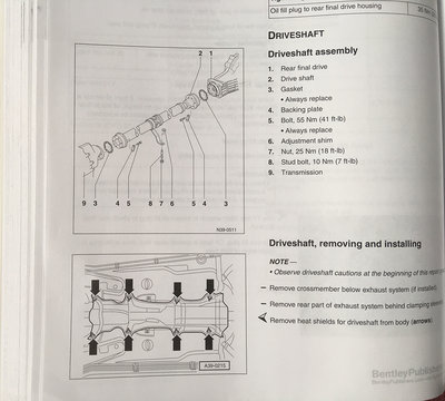

I've got the Bentley manual but I can't find anything about gearbox output flange seal. Is it called something else in there? In the automatic section it doesn't mention it, that's all with the gear selection. There's a gasket/seal in the final drive section that looks roughly sort of what the photos show and involves taking the exhaust off (I'm an ignoramus though) but that doesn't mention anything about how far it needs to be pushed in. It just says replace gasket and replace bolt. Perhaps that's been the issue if the bolt isn't replaced as well? There's also an adjustment shim listed.
I've attached a pic of the page I'm thinking might be.
This could of course be entirely the wrong bit of the car
Re: DIY Gearbox output flange seal replacement 018 409 399 B
Close. It's number 9 that we're interested in.
Maybe have a look at the transfer box bit.
There's nothing. A transfer box is not mentioned.
