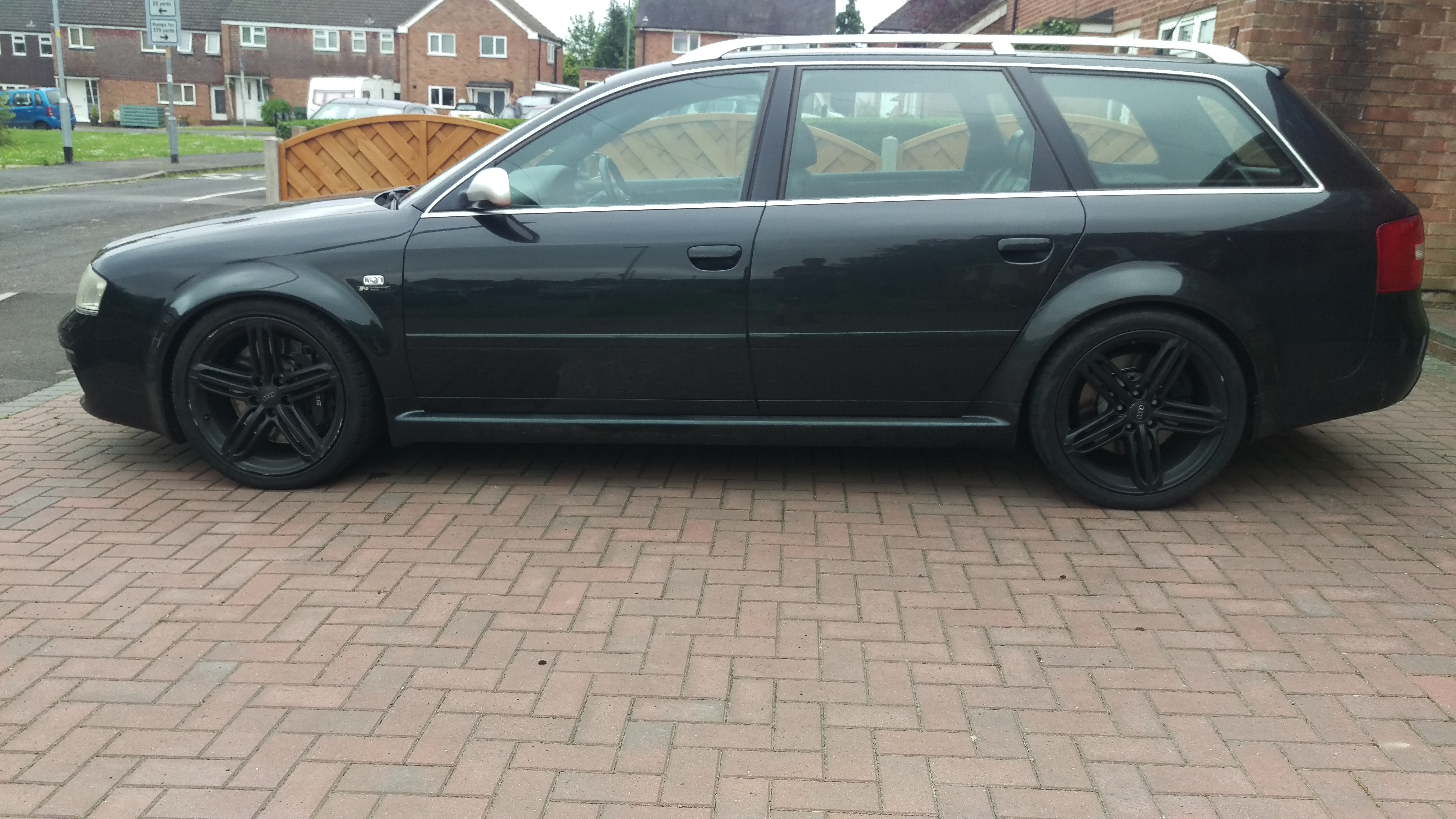

Cheers Shoppinit, i was all ready to do it myself, but then I noticed that the warranty is only valid if a professional fits them. Anyway, I decided to get an Audi specialists to fit near me as had sold the mrs car and had a bit of cash
what a difference! Far better than a failing DRC! I think I need to lower the backs a tad more, as the fronts look lower.
