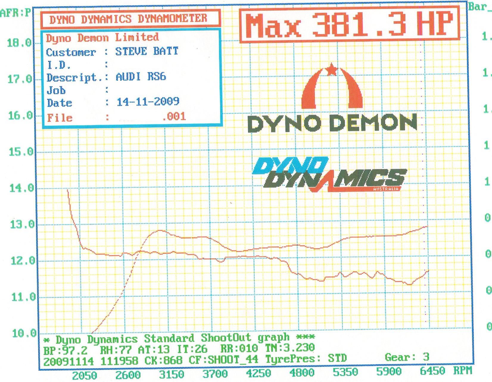

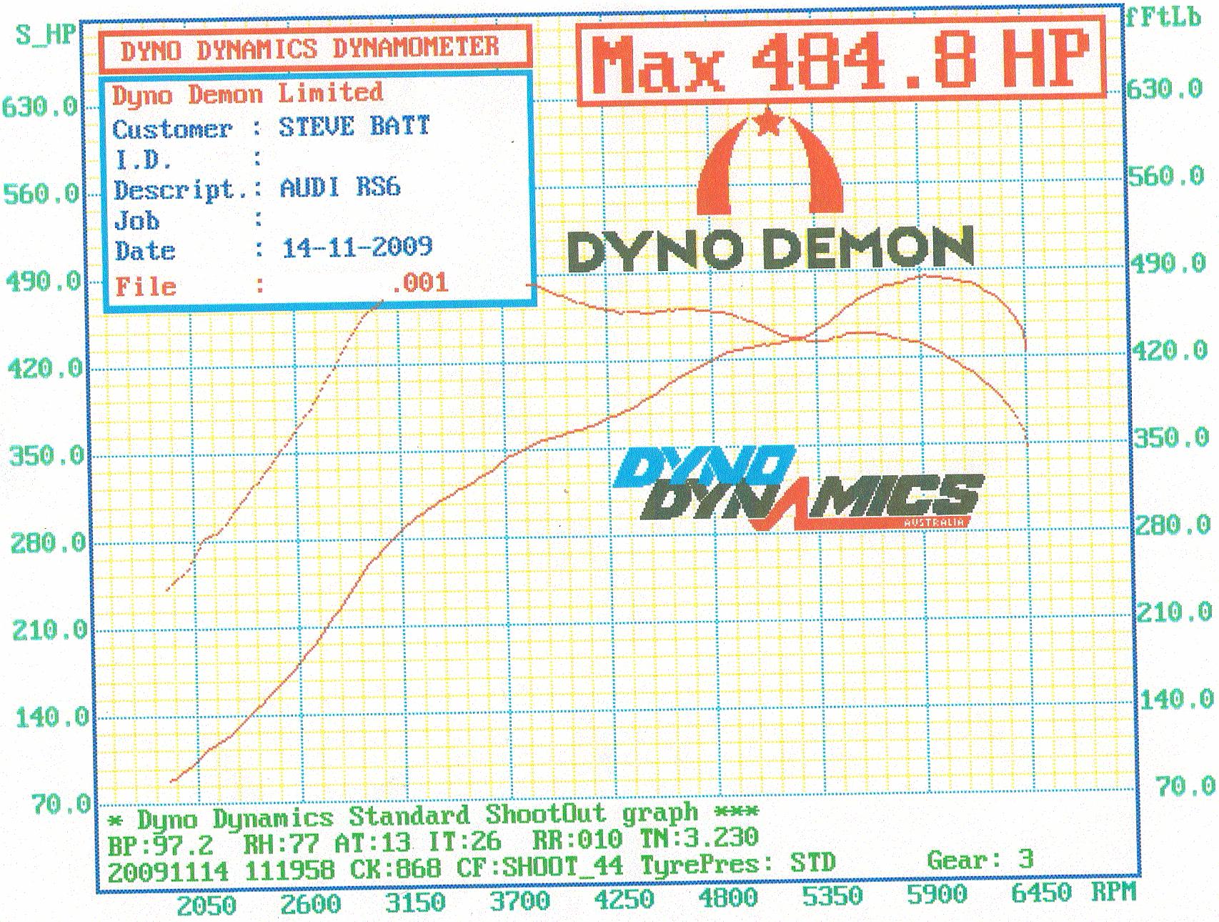

okay chaps - i need to draw my paranoia to an end.
the results from the rr session were totally as expected for a std car.
i had the guys at unit20 check the car over beforehand - no boost leaks, DV's okay, no fault codes, MAF's reading fine.
Grizz also took it out for a drive and said it felt fine.
he also commented that the std cars don't produce high torque low-down, in an attempt to protect the transmission.
whereas remapped engine produces high torque early on.
i guess that's the key statement, and it must mean that the RS6 i took out from the dealer must have been remapped, as it was savagely quick even below 3000rpm.
so i'm happy with the car now, and will ready myself for a remap sometime in the future...!!

Cool. Glad to hear all is OK. How about posting the RR results? What HP / torque did you get?

Hi matey, these cars are good at increasing paranoia levels!
Saw your graphs over on SRS and now here, they look good to me
