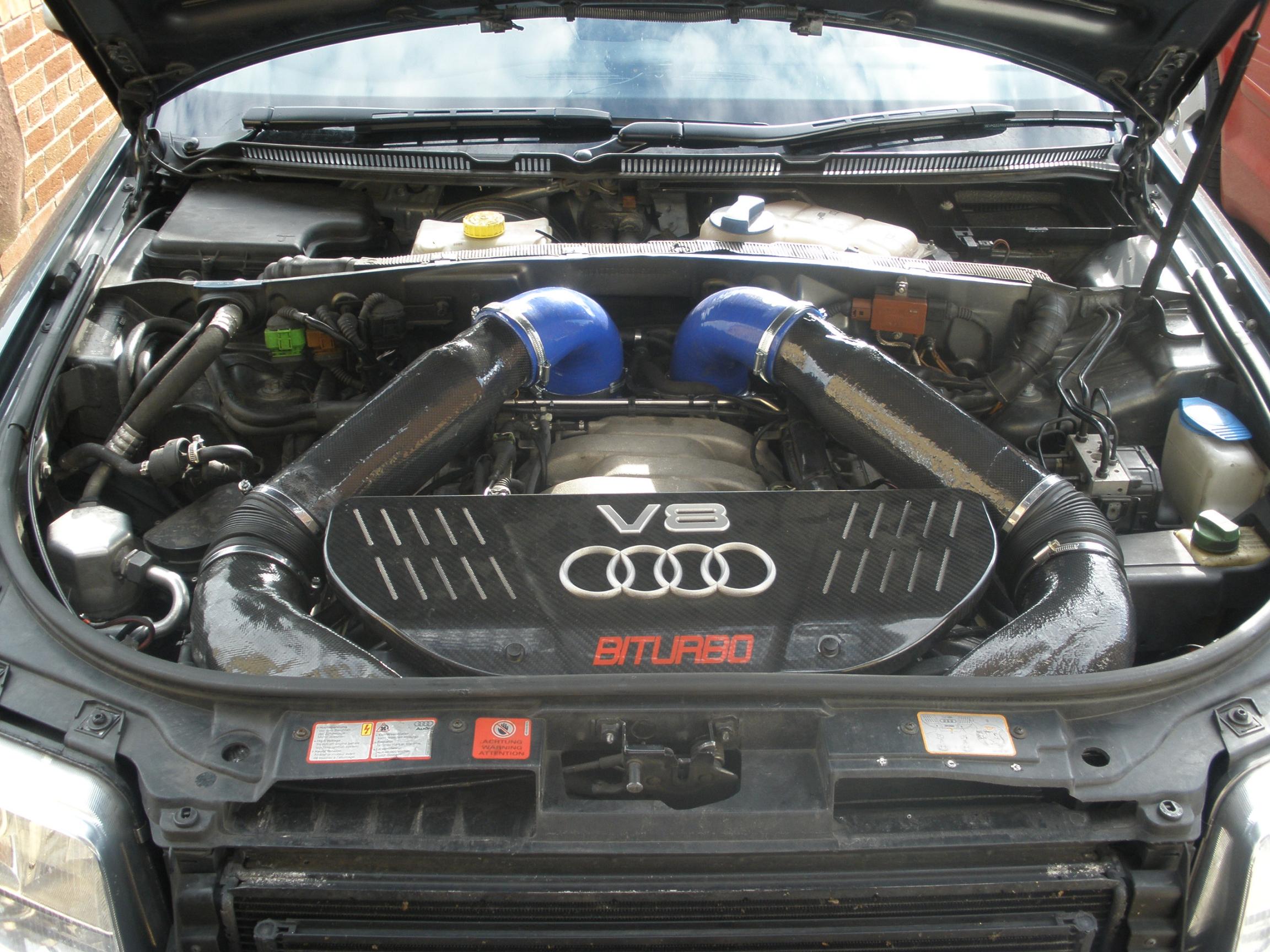

Or for induction noise, much better cooling, more power, faster spool up (almost immediate at speed) and in making servicing easier, do this....

:shock: Where are the air filters? In the fat pipes?

Nice. Are those pipes flexible?

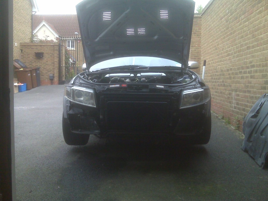

GregR1 wrote:Sure there's a guy on here that's vented his bonnet for hillclimbs...
Yeah I've got vents done by Cool louvers, a while ago now, looks good and the sound is awesome :D.
Picture not very good was taken on my phone!

Shoppinit wrote::shock: Where are the air filters? In the fat pipes?
High flow filters in the pipes. Flows lots of air, it uses modified widened scoops, to std accordion pipes into the carbon pipes which reduces into rubber 90deg bends straight onto the MAF's.
