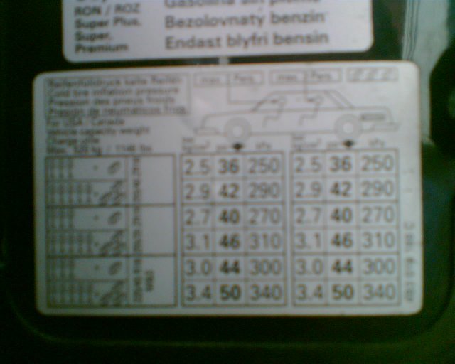

Post by SteveH » Wed May 03, 2006 3:57 pm
Mine is different to that, for 255/35/19 its 40psi normally loaded, heavy load 46.

Post by SteveH » Wed May 03, 2006 6:04 pm
Dodgy photo of mine below:

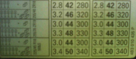

Post by peterb » Wed May 03, 2006 6:15 pm
Odd - the 'standard' sticker part number is 4B3 010 188C. Your car appears to have 4B3 010 435P. This is used when options FQ1 and T09 are fitted, but those options are 'wheels and tyres from quattro gmbh' and '8 cylinder fuel injection engine 4.2ltr 331KW'. I can't see why we don't all have your sticker! My car data sticker lists T09, but not FQ1.

Post by bobjebb » Wed May 03, 2006 6:19 pm
Maybe a Plus thing then? "wheels and tyres from quattro gmbh" would maybe be the key? Being 10ml lower?
Any other Plus owners care to check?
