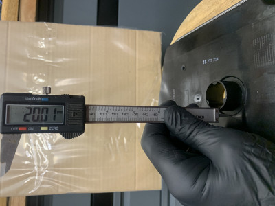

After taking some of my own measurements, I came to the conclusion that the noise is due to the fact that the suction pick up tube (which is the bottom of the filter that is measured in the pictures : 20mm or 22mm depending were it’s measured from) touches the bottom of the transmission pan on one side and on the other side has 2mm clearance. Basically it’s angled , maybe on purpose, but also is making me think that it would make the pump work harder to get oil due to very low clearance hence the noise.
When you use a vacuum cleaner and bottom out the end of the hose on a flat surface it stops sucking, if you lift one side it struggles a bit but has the most suction due to some clearance, but the most efficient way would be to hold it 2-3 mm from the flat surface…

Check the o ring is an interference fit.
In my case the garage fitted the wrong o ring.
Make sure there are no cracks in the filter. They are fragile.
If the filter neck is 20 mm (22mm inc recess) then you should be good to go. Presuming you have an original sump pan fitted.
Ps no idea why your pickup tube is angled when it’s installed. Further investigation on this needed ?

Yes, the filter neck is 20mm (or 22mm measured from that little gap). But it’s a Vaico filter.
Looking at the filter, it looks perfectly straight. But when I measured on the left side there was no clearance and on the right side there is maybe 2mm .
There are 70mm from the edge of the sum to the deepest point. The filter pick up tube sits at 68mm on the right as you look up, and 70mm on the left. It’s strange, I was surprised as well, but am also thinking that ZF designed it this way just in case it’s low on fluid and it will pick up some oil from the bottom of the sum or on heavy inclines?
I was tempted to cut the neck, but I’ll just try to buy the ZF filter. I was able to find just the filter. No kits.
It will take more than a week in shipping, so I’ll report the differences. I am also thinking the the thickness of the filter/plastic casing might be a bit different since the pick up tube is the right measurement. But Vaico should have taken those measurements. Maybe clarification on these differences might help someone that has a hard time finding ZF kits…
The O-ring is right. I tried the next thickness available and it will not go in. I was hoping it was the o ring, but to my disappointment it seems to be the total thickness of the filter. It’s my only guess left at this point.

The sump pan is not damaged, the measurements are done on the transmission itself. The pan measures 70mm at its deepest point on both sides. The 68mm and 70mm measurements I talked about are from the upper edges of the transmission to the tip of the pick up tube on the filter. Basically the filter itself sits not plumb. Not visible at all, just by measurements. And it’s in all the way, torqued to spec. But my thinking is that maybe Vaico screwed up ?

Update: Well, this is going to sound pretty dumb, but the suction noise I was hearing was the front hubs spinning. Since I had the front end off for the timing belt/ chains and tensioner pads job, I never put the front wheels (or bolts back on). Even though I had my foot on the brake pedal, it wasn’t doing anything since the disc was not connected to the hub. Duh! I only was able to figure out once I saw that the speedometer was reading 20MPH with my foot hard on the brake pedal… I immediately went WTF is going on? My brakes are fucked?
Anyway, the ZF filter came and I used it anyway. The only difference between the Vaico filter and the ZF filter was the neck: ZF is tapered and Vaico is flared (which almost seems like a better idea since the o ring is trapped in there by the flare) . And after all that trouble I still can’t confirm that Vaico might not be good (maybe it is). I measured both on all sides: same.
