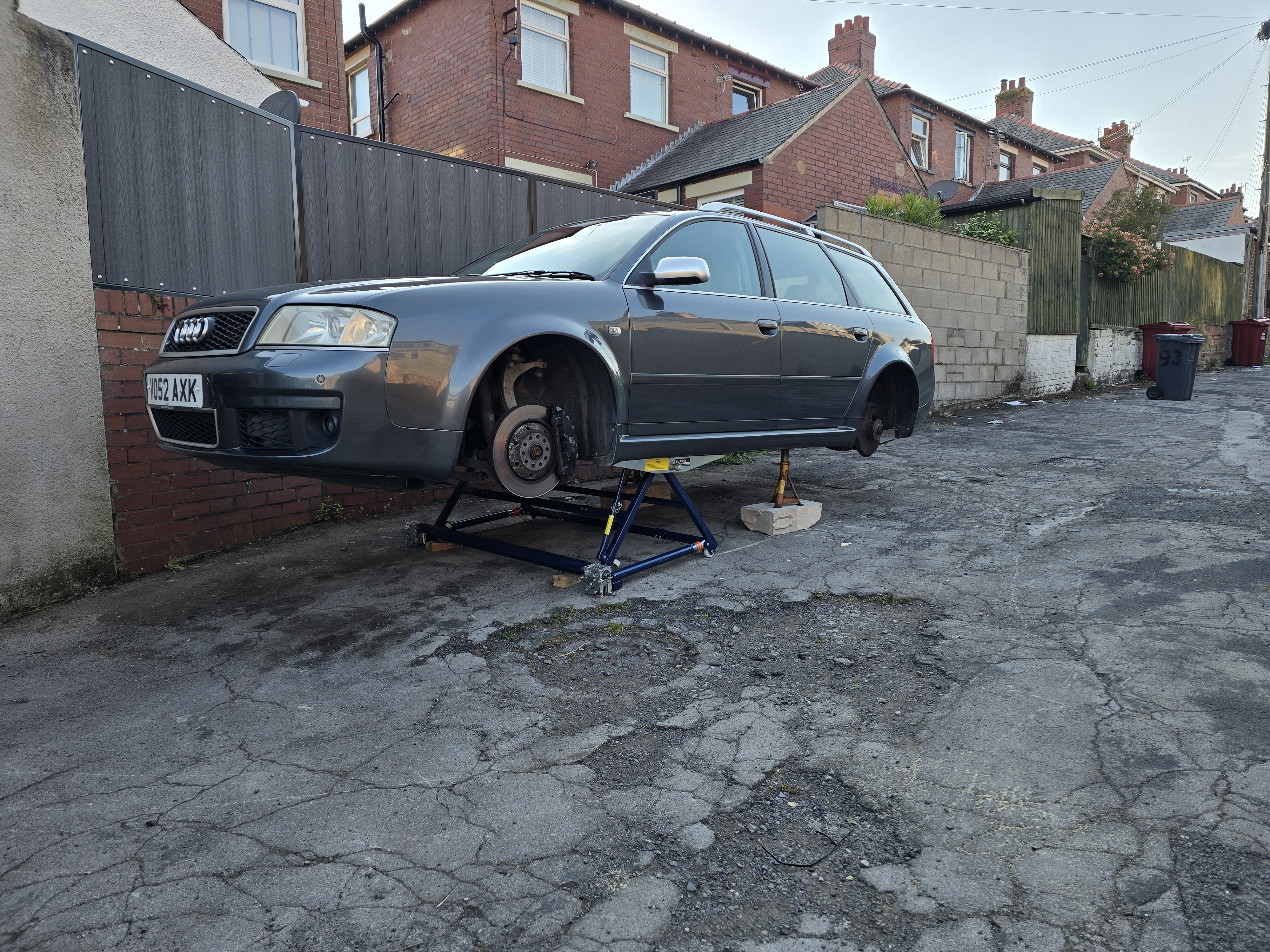

Soooooooo I have started on the refurb of the underneath so far so good getting it all in bits. However I have started going through all the parts I ordered and have a couple of issues.
1. I ordered the Lemforder front suspension kit off AutoDoc and it has come in a branded box but all the arms have no stamping to say they are genuine Lemforder ones. Should they have some markings on them ?
2. Been sent the wrong rear wheel bearings so does anyone have the link or part number for the correct ones.
3. Rear inner c.v joints are wrong so as above any links or part numbers for the correct ones would be appreciated.
4. How do you adjust the handbrake cables as when dropping the rear wishbones they extended right out.

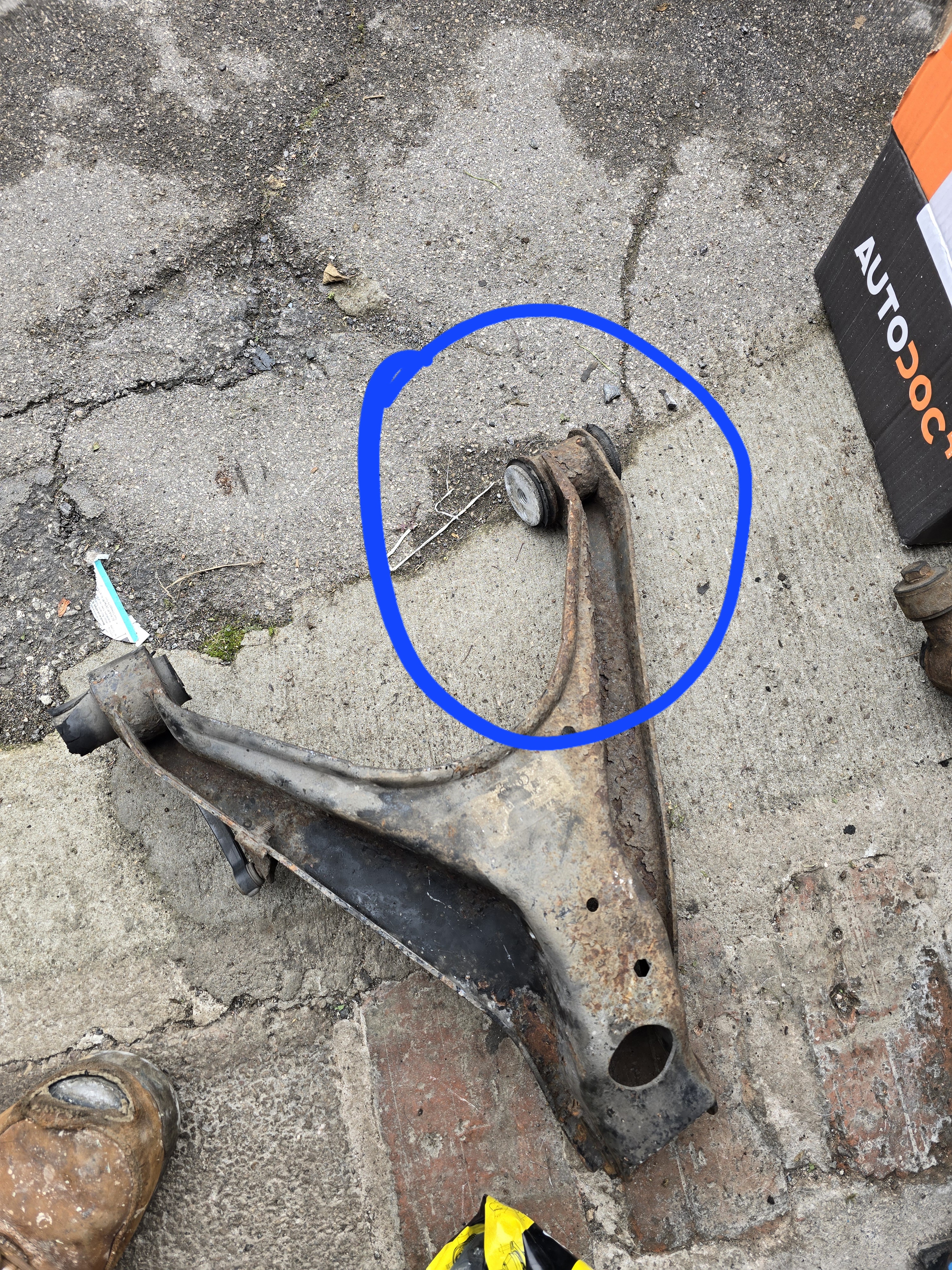

5. I am after the part number for the bush ringed in the picture it's the lower rear wishbone bush.
