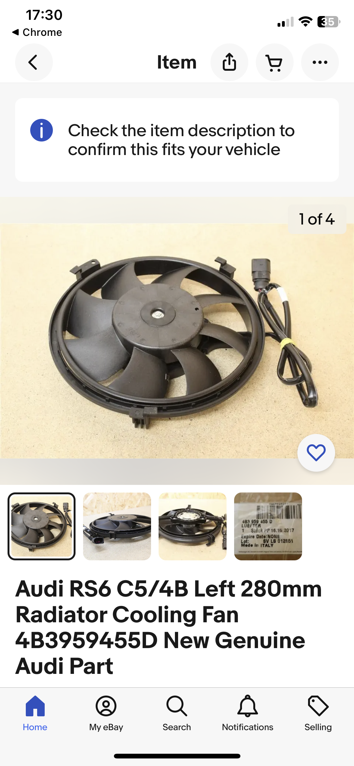

If you need the fan £100 delivered in the uk.
I know it’s working fine as I ran it on Vagcom before we removed it.
The new one I bought was £250.
The large fan which I bought at the same time was over £1200.
If you need the small fan just Let me know.

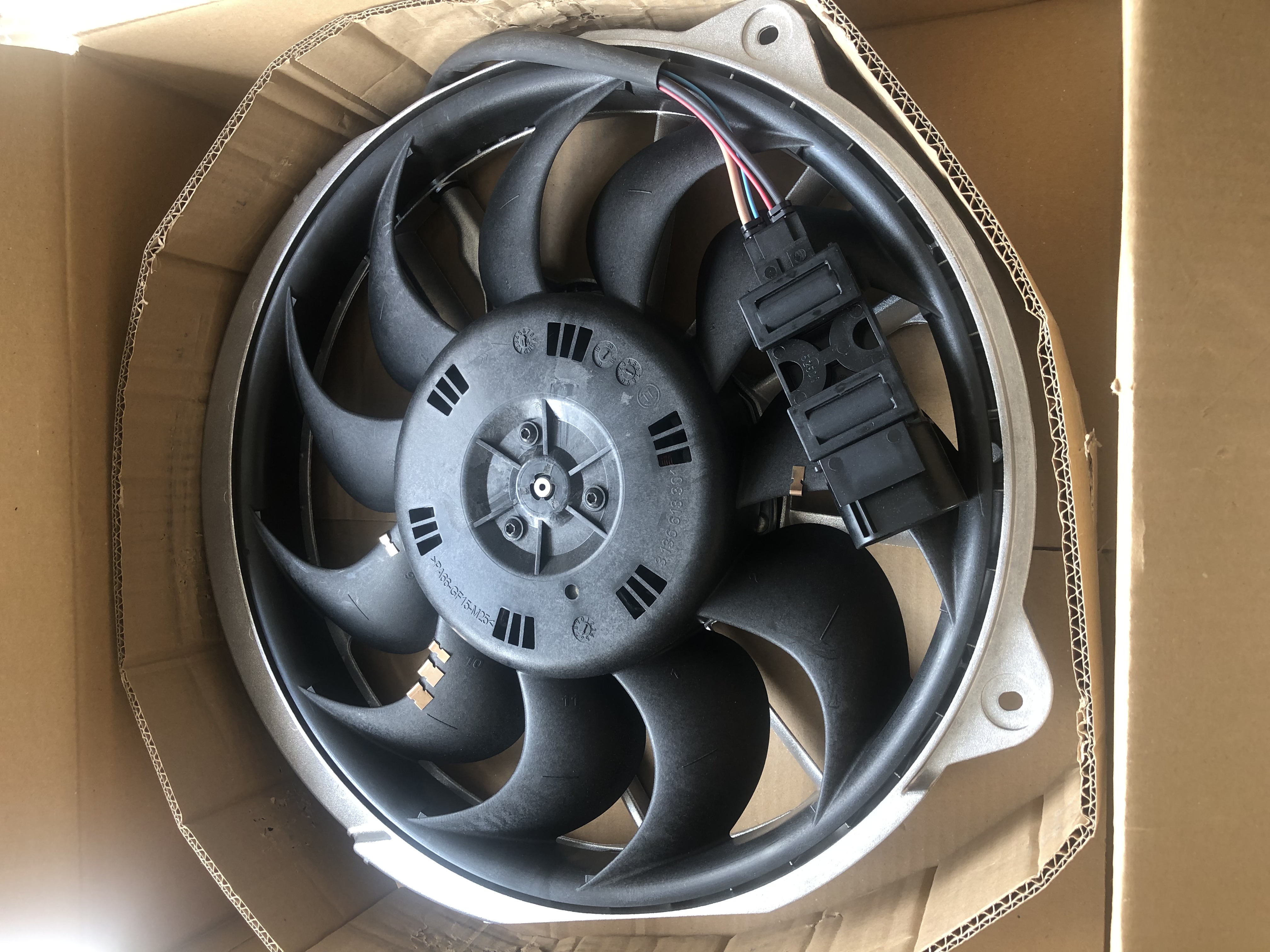

Yes I felt sick as well. It also has its own built in controller
Had to purchase it from Germany along with some other stuff.
Had to use a freight forwarding company in Germany. Audi Tradition wouldn’t post direct to the UK. So I incurred additional costs to get it delivered to the uk.
Large Fan
Small Fan
Large Fan
Small Fan
