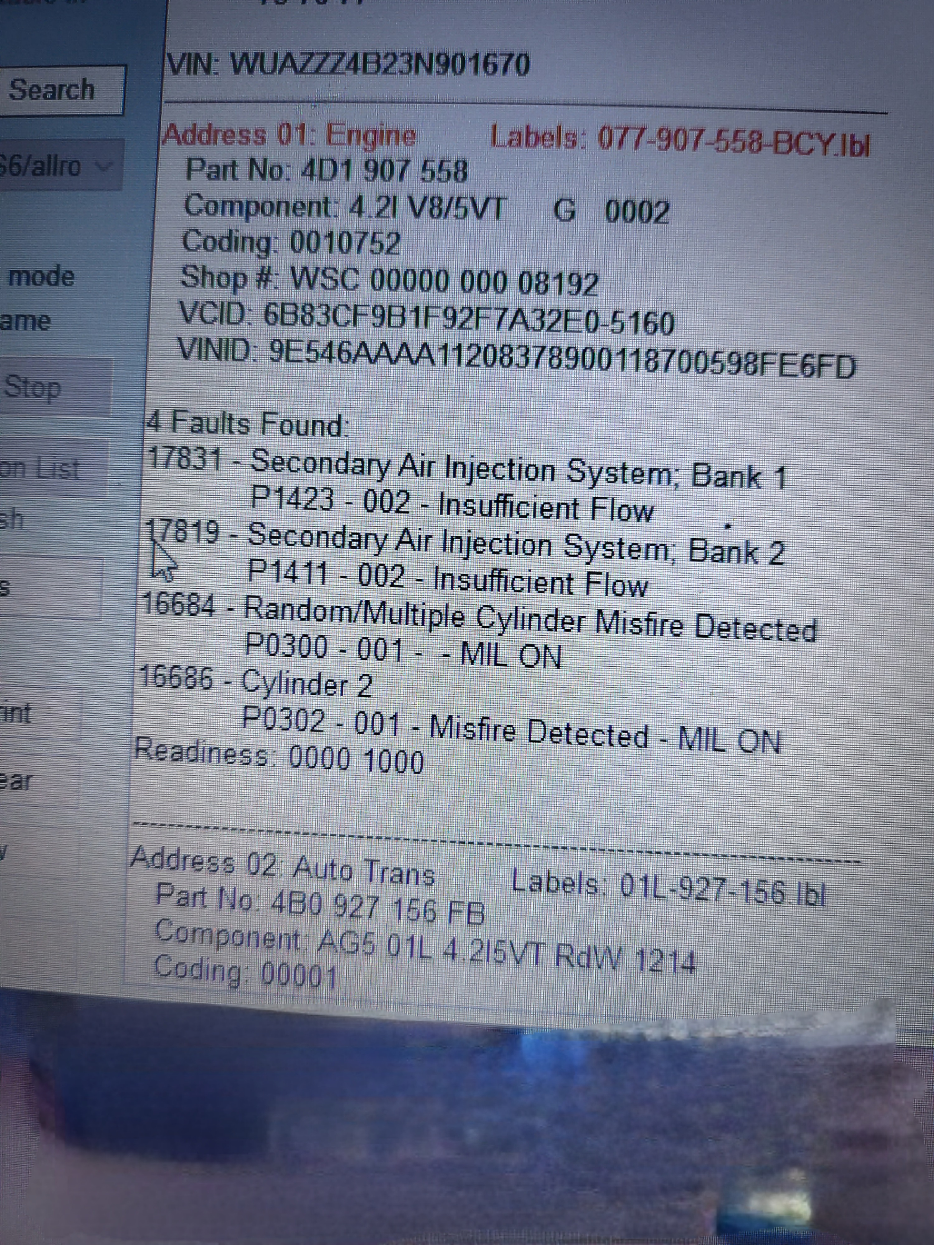

Hi all,
Accelerated earlier and got the rough running along with flashing cel. I've just done a scan (couldn't go to sleep thinking about it).
Is this a new coil pack needed?
P.s the SAI has been removed by previous owner. Not sure how to tell VCDS it has.
Cheers!
Cheers!

Do the age old test, swap #2 with another cylinder and see if the code jumps to that cylinder.
