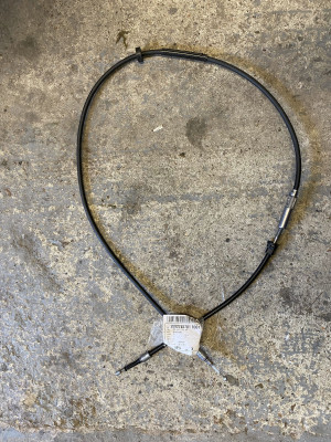

I happen to have a pair in the stores, since my fitted cables are on their way out - but they can stay in place until they fail an MOT and won't adjust.
I bought them preemptively as I will need them, so I'm afraid I won't let them go - however happy to photo/measure to help find an alternative solution that works for you.

Cool. What's the length?
Re: Handbrake cable and adjuster
Very close to the ones on autodoc then. Sounds positive.

Matt already measured it for us.
