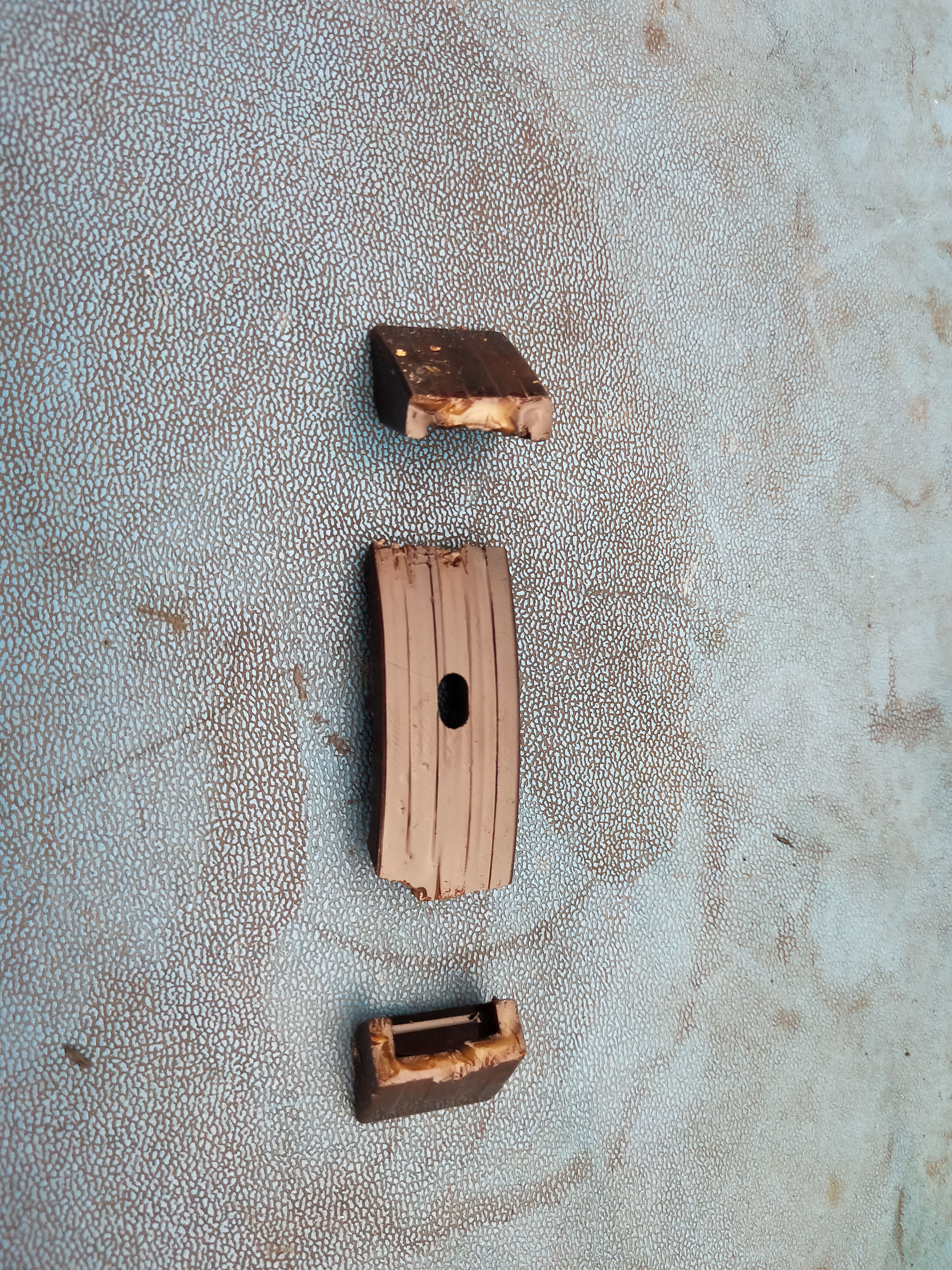

Started looking into why bank 2 cam is only advancing to 14-15 degrees. Removed the rocker cover first to see if I could see anything. Broken cam pad on the top. When I did the cam belt I used the tool to compress the phaser to check pad wear. I think I must of over tightened the tool and cracked the pad. Both ends were just sitting where they dropped and the center part of the pad was off center but still under the chain. So no metal on metal. Very lucky I would say. Lined up the cams with the notches and compressed the phaser. The broken center bit fell out. Slid a new pad in and clipped it down. Reassembled and all is good. Group 93 has changed a bit but still in spec. I will keep an eye on things and keep checking group 91, 92 and 93 for a while. For now I think its ok. Next round will be all new pads

Wow. Lucky indeed. Could have been catastrophic.
Re: Cam Belt Plus Chain ?
Yes, super lucky.
