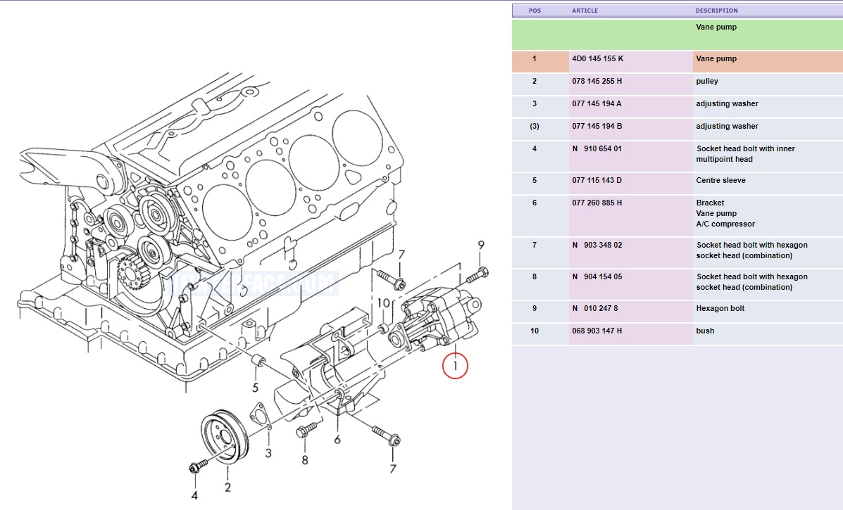

I've actually never had it just in service position. I have always just taken it off since have always been in the middle of an engine out job - try to save the big jobs to do all in one go and just go large.
Hopefully service position will work here - I had the air con charged up yesterday, seems a shame to have to dump it all out again so quick.
Pump on order from autodoc - have got a TRW reman one on it's way (I choose TRW since they are OEM supplier for many parts (e.g. the master cylinder) without being excessively priced). https://www.autodoc.co.uk/trw/2199904
Without cashing in the old one it's coming up at £250 vs Audi £500. And if I send the old one back, it'll come in at £150ish net.
