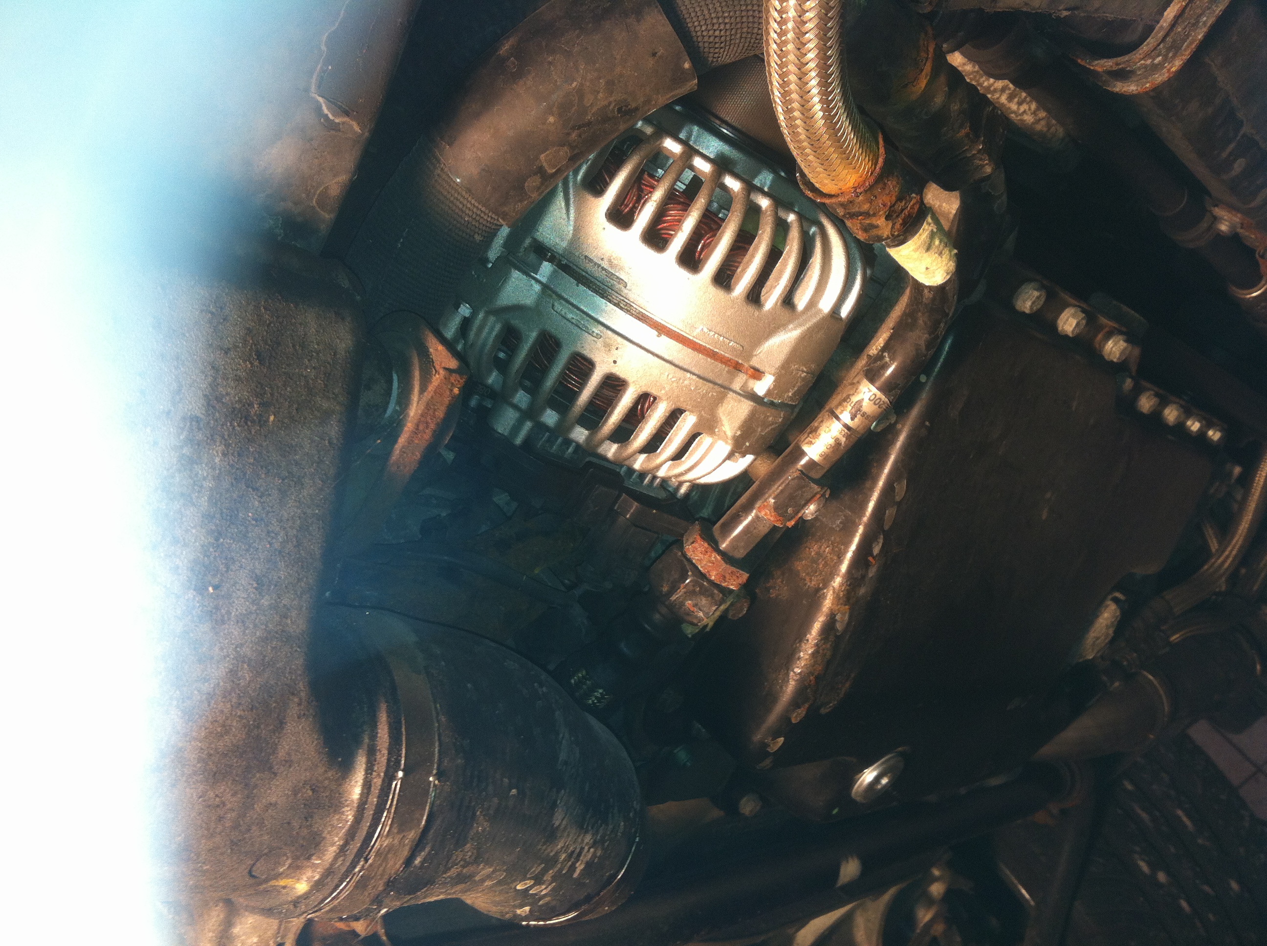

Re: Alternator time
Am i right i have to remove those 2 oil lines?
How much oil is coming out when i remove those?

Re: Alternator time
If I remember correctly . The lines on the off side are engine oil and the ones on the near side aerial gear box . You'll just get an oil coolers worth plus what ever is in the linesmavada wrote:Am i right i have to remove those 2 oil lines?

Re: Alternator time
I did my alternator before xmas and it was a crappy job. Problem I had with the oil pipes was getting access - you need a 27mm crowfoot socket. Then, the pipe fitting started to unscrew from the filter housing, so the pipe collapsed and twisted. I ended up cutting it off with a cutting disc and replacing it all.
Both those pipes are engine oil - I took the filter off and drained the sump beforehand because it needed changing anyway, so there was just the dregs in the pipe and from the cooler. One pipe out to the cooler, one return.

Re: Alternator time
Think its normal oil coming out of the ic hose?

Re: Alternator time
Yep, I had a little more actually. Good luck!
Re: Alternator time
Did you manage to loose tension on the belt from underneath?
And put some weight on the belt to prevent it rolling from other rollers?

Re: Alternator time
Yep - if I remember right, you just put a 1/2 inch drive bar into a hole on the tensioner and you can lever it round. It's quite hard, so I used a big bar. You can't really see much but it's easy enough once you work it out.
