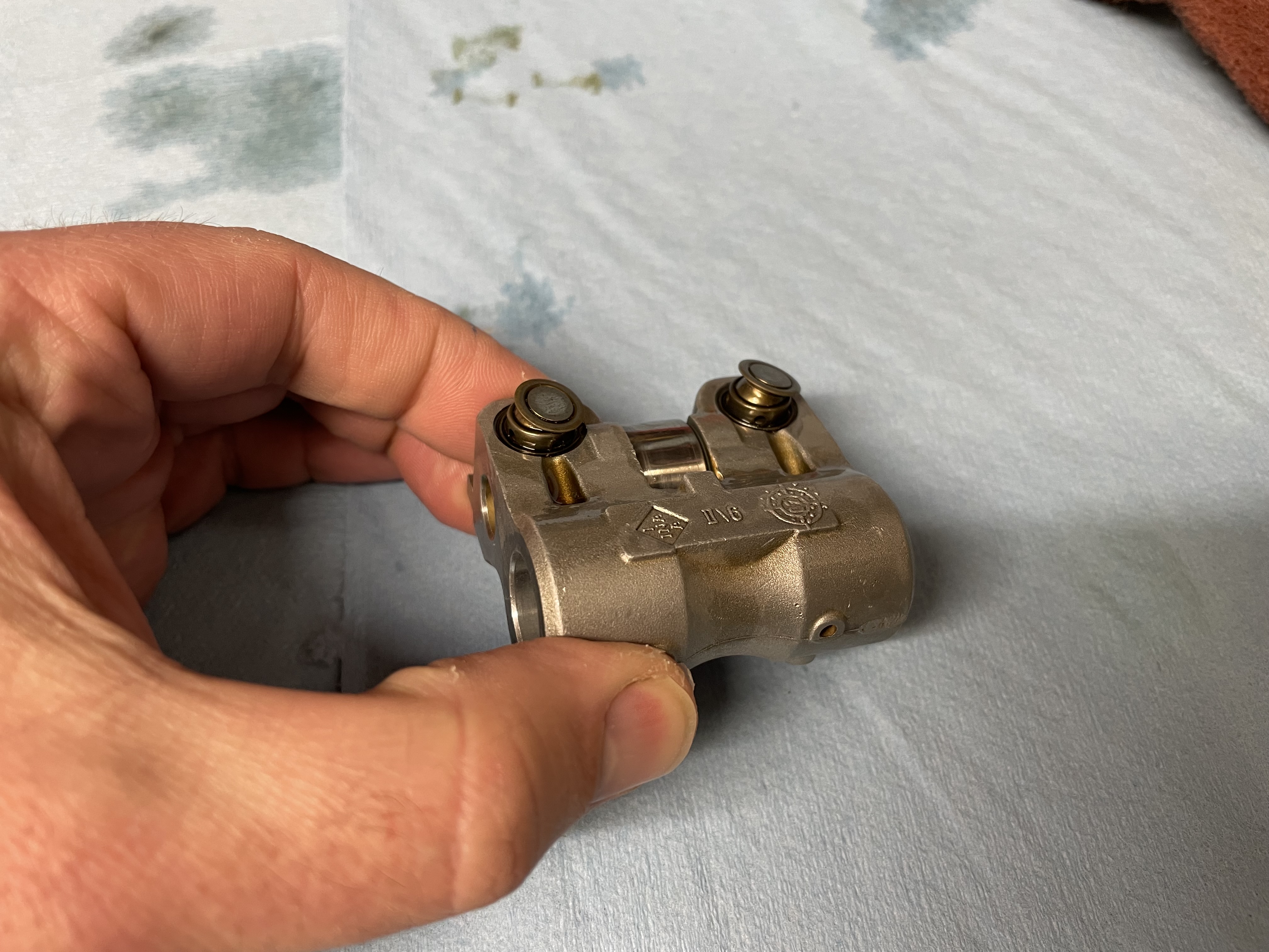

I’ve been looking into this for a while. Our engines use a larger rocker arm which then has a roller bearing integrated into it.
It also has 2 smaller lifters which you can remove. Not that many other Audis have this sort of configuration.
The lifter themselves aren’t that bad to remove, but you need to remove the whole cambelt and camshafts. That in itself is just a lot of work and costly. New bolts for the cam carriers are about £50. The lifters are about £25 each and ofcourse we have 40’of them.
The carriers are much more difficult to remove. They are fixed in place by a long rod (1 for exhaust and 1 for inlet) that goes all the way down the head. The only way to remove these is to either take the heads off or to remove the cats front end. For rhe passenger side they slide out backwards toward the firewall so only option is to take the head off or remove the engine.
The large rockers only seem available from Audi. They are about £200 each and come with the lifters. We’d need 20 of them.
I’ve bought 20 new lifters and a spare rocker just to see how they work. I’ve also got an ultrasonic cleaner so was planning on doing my cambelt then swapping all the exhaust lifters for new, plus cleaning all the inlet ones.
I bought a second hand rocker arm with lifters and was surprised at how well they cleaned up. When I find Tim I will post photos.

Here’s some photos. The rocker I have is for the exhaust valves which rides on one cam lobe and has is for 2 valves. (Diagram parts 26/27)
The inlet ones have 2 lobes and are for 3 valves. (Diagram part 25/27)
I’ve bought 16 new exhaust valves - plus have 2 second hand ones. I’ve already bought the seals so I could take the driver side rods out diagram 21/22.
Ideally I’d take them all out and give them a clean as they carry the oil feeds.
Daytona RS6 Avant

The lifters only actually press down about 3 or 4mm but a stuck in one would cause tapping.
Worst case if you have tapping it could be the roller bearing in the rocker itself.
