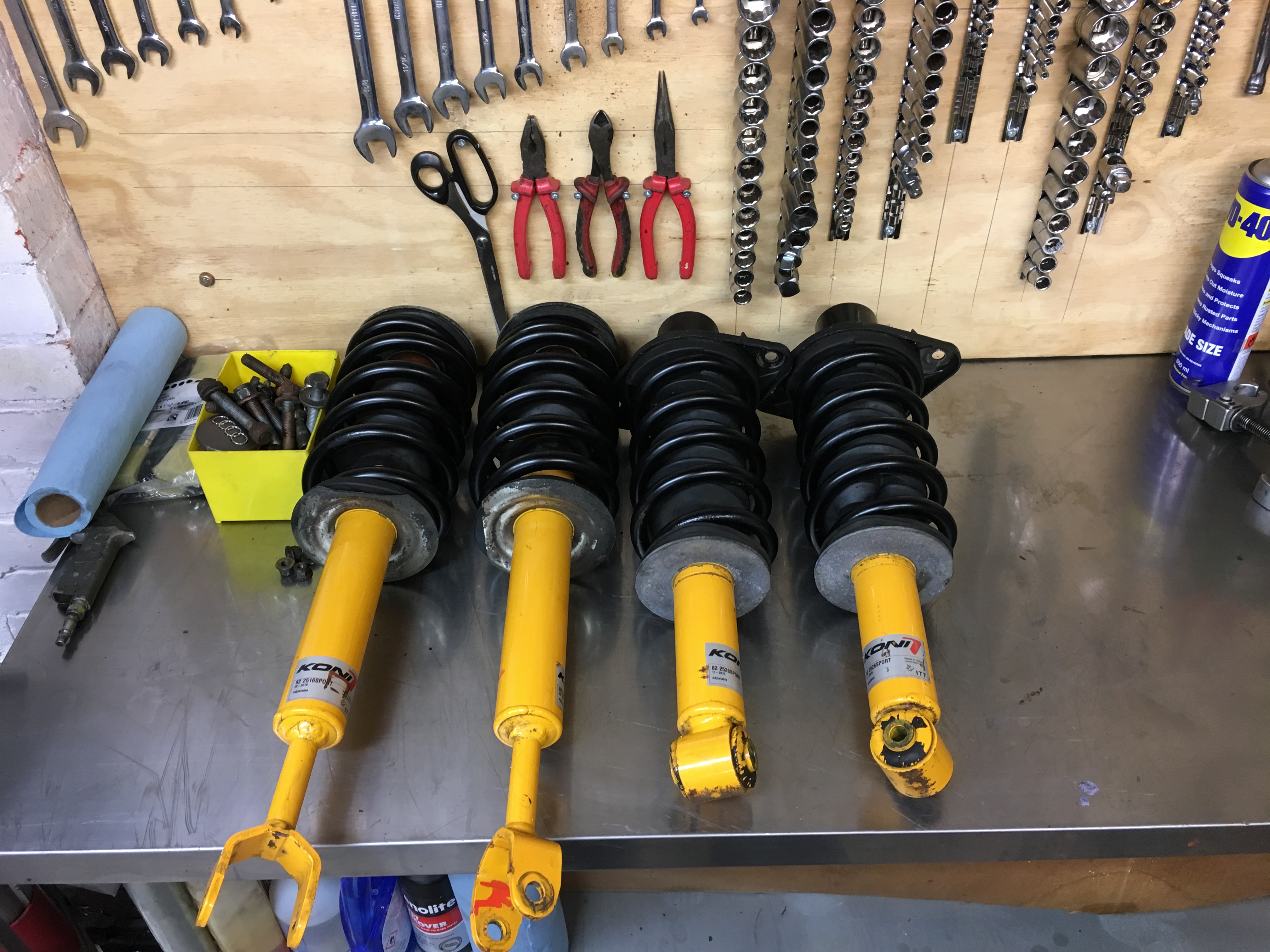

Koni dampers arrived today. Also ordered a CV boot kit for front LH side, so will tackle that at same time. Also ordered parts for the transfer box to propshaft seal as that has a slight weep.
I think (I hope) thats probably it for the purchasing department for the immediate future...

Front dampers fitted. Headlamp washers made to work so bumper all fitted properly and wheelarch liners fitted properly.
Rear dampers left to do and front CV boot (couldn't find a 17mm allen socket.)
